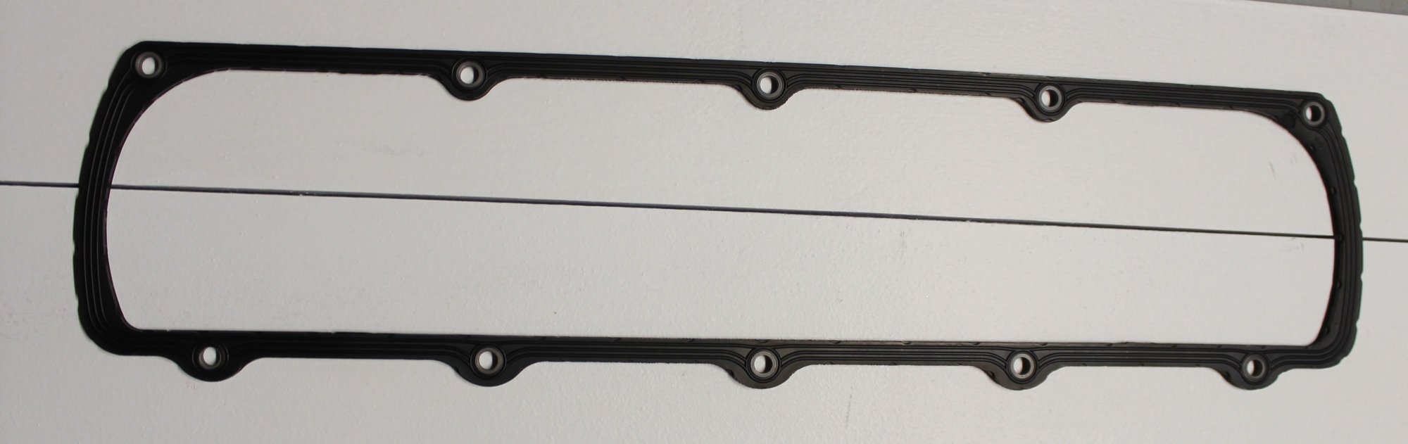

Old Apr 8, 2023 | 04:29 PM
v8al's Avatar
Registered Olds Owner
Joined: Apr 2018
Posts: 1,118
From: Los Angeles, CA
Originally Posted by Battenrunner
I use the very nice steel core rubber molded gaskets from Bernard Mondello with our cast aluminum covers, but, I bet they will work great with steel 10 bolt covers as well.
Give him a call, and he can tell you for sure if they will work for you. They are the best ones I have seen yet, and look to be lifetime gaskets.
I 100% agree with this. I never saw a set of "Fel Pro Perma Dry" gaskets but these gaskets from Bernard are the best Oldsmobile valve cover gaskets I have ever seen.
Made in USA, stainless steel core, soft durometer rubber with torque stops.
Wonder who really makes them? The only identifying mark on them is "VC439"
Old Apr 8, 2023 | 07:41 PM
bccan's Avatar
Posts: 1,730
From: West Hartford, CT
Those look to be functionally identical to the Perma Dry Plus gaskets. Nice that they’re available, hands down best design I’ve used.
