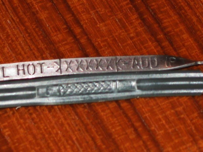

But now the dipstick level. Checkout the pic of inside of tranny with pan off to document dipstick oil level. Does this seem right? I've read that these deep Aluminum pans should have oil level at the tranny pan gasket area when gasket laying on top of pan.
The level needs to be checked with the engine running completely warmed up and in park. The dipstick level does not change because you went to a deeper pan it just holds more fluid. It looks like the full mark is in the proper area. The reason it may be puking is the vent on top of the transmission housing is clogged.

I mainly needed to know if dipstick level looked correct. I tossed aside the plastic lokar dipstick back when installed it, used original TH400 metal dipstick with the Lokar ****.
