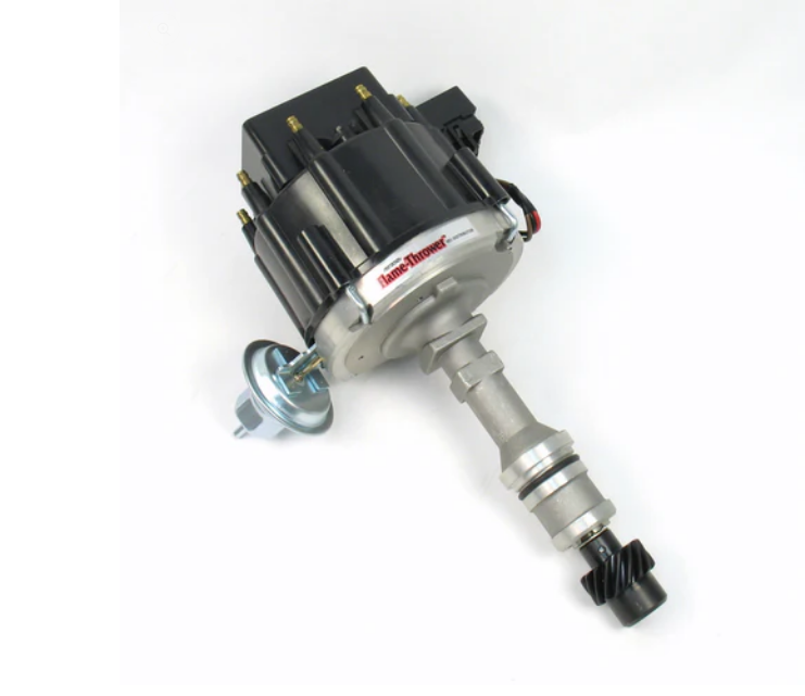

Distributor is Pertronix electronic ignition flamethrower III coil. I assumed that was HEI??
HEI is the GM cap-in-coil system. People mistakenly refer to any electronic ignition conversion as "HEI". They are not the same. Pertronix does sell a Flamethrower HEI-style distributor for Oldsmobiles.
