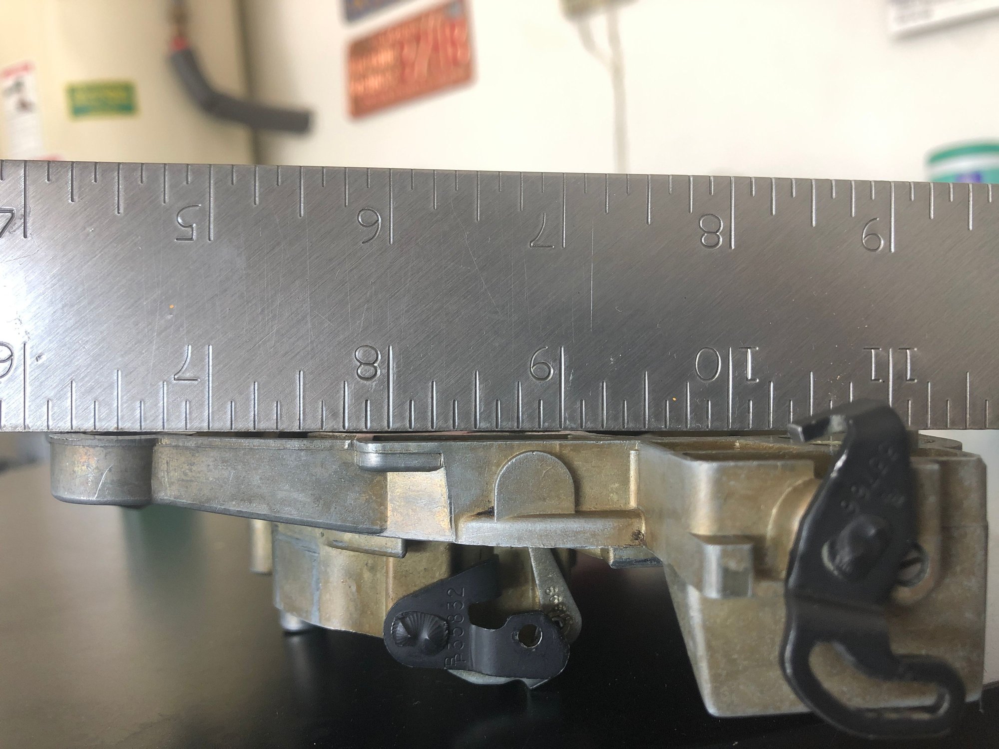

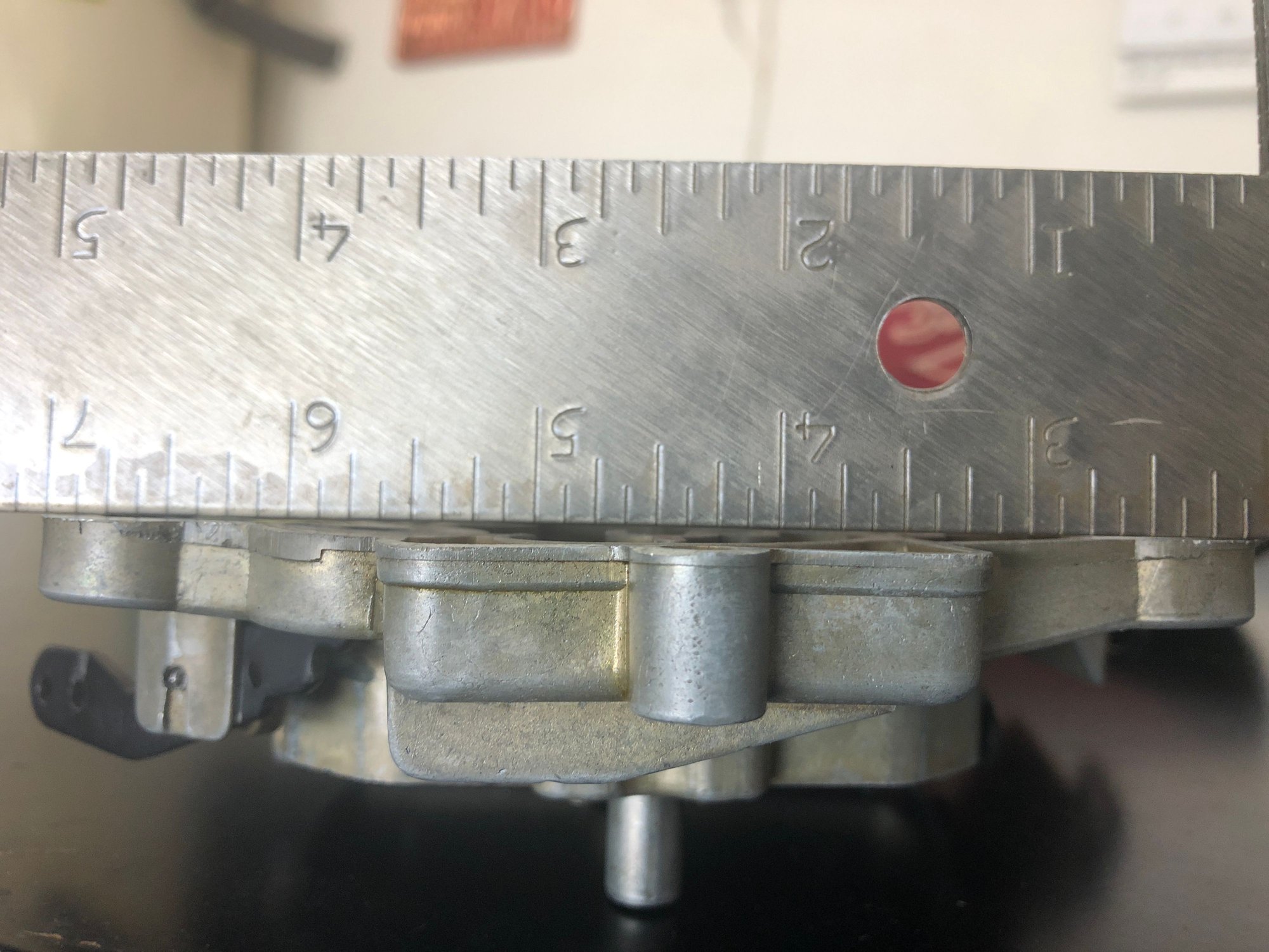

Here is my air horn gap
Side shot pass side

Posts: 15,310
The QJet on my 1970 Supreme was similar to that - too many gorilla mechanics cranking down on those front two bolts when installing the carb. I doubled up on the air horn gasket, and while the gaskets would get damp with fuel, it didn't affect the way the engine ran at all.
Then in the early 2000s I bought a reman QJet for the convertible and it came with a very thick air horn gasket. I contacted Holley tech line (it was a Holley brand raman carb) and they sent me a couple of those extra thick air horn gaskets. So there are thick gaskets out there to address the QJet air horn warpage.

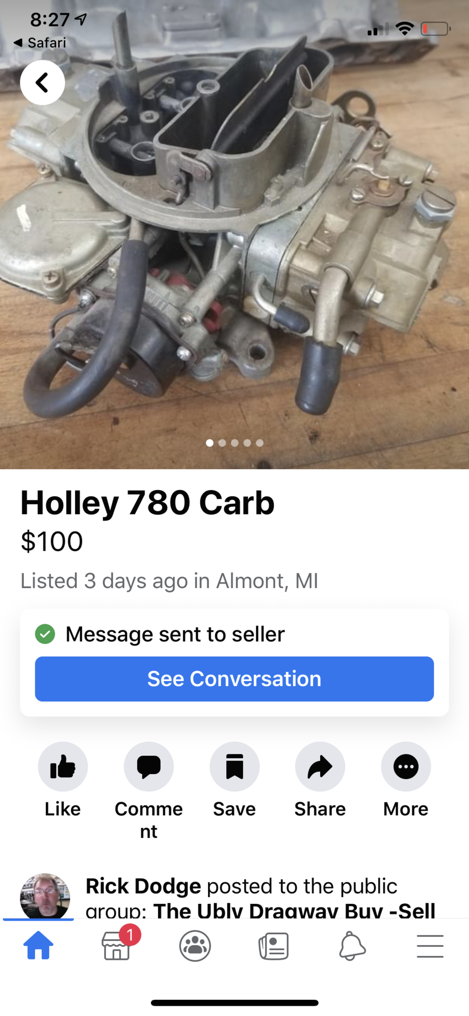

Heres a great deal on a 780cfm spreadbore vacuum secondary

Think i can use that style? looks like electric choke
Old Sep 10, 2020 | 07:10 PM
70W-32's Avatar
Joined: Mar 2013
Posts: 1,914
From: St. Clair, MI
Electric choke is simple, one wire hook up.

also I think it’s single feed? Which I like better than dual

No, its a dual feed, but there are a lot of different dual feed set-ups available that will simply connect to your hose from the fuel pump.
You could also buy one with a port to attach fuel pressure guage

It actually is a Single Feed.
confirmed by the seller see the pic of the fuel line.

That seems to be a list 7010. Although the primary is smaller than the secondary it will not fit a spread bore intake (qjet). It has center hung bowls making it a dual feed. The line out of the front bowl is a vent for emissions. I believe these were replacement carburators for ford products.
