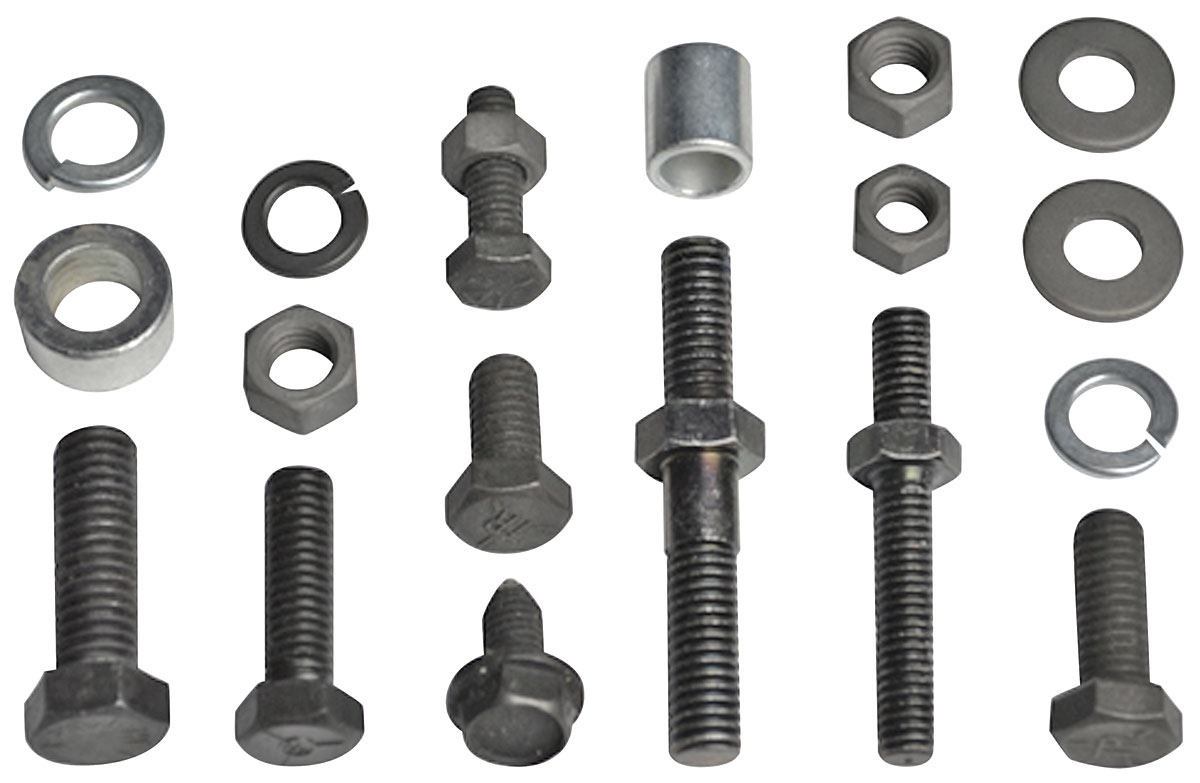

That will work. You will need the two stud-bolts for the front cover and the two spacers that go between the bracket and the block. Inline, OPGI, and others sell a kit with all that mounting hardware if you prefer.

Thanks Nick and Joe. Inline Tube has it at the most cost effective price and a schematic too.
