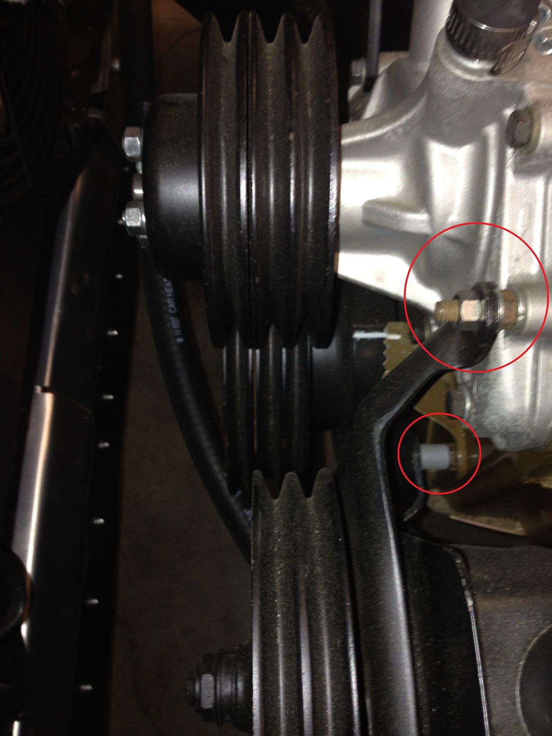

I've been fighting back issues all summer and that plus the hot, hot days we've had since May have kept the progress to a crawl. The biggest issue I'm still having is the alignment of the power steering pump. I don't know if I have mismatched brackets or what, but the alignment just ain't right. Sooner or later, I'll figure it out.

This may be a stupid question but do you have the correct spacers behind the pump brackets?
As far as I can tell, yes. I started with a 1972 350 bracket setup. I then went thru the parts catalog and looked up whatever was different for a 455, which was the bottom link that goes to the block approximately below cylinder one. The pump seems to be canted back towards the firewall on the left side. I've tried a smaller space on the lower timing cover screw, washers at the top of the timing cover to space the bracket forward and a washer between the lower spacer and bracket, all to no avail. I've put everything back to normal now and removed the washers from behind the brackets. I also DO have the spacer between the bracket and pump. I'm thinking I may have to start over with the "H" and "C" brackets with all pertinent spacers.

Is this stud installed?
In 68 there's only one power steering pump configuration.
I used a 72 350 non-air bracket set for my car and everything lined up. I don't know what differences there may have been in 72 for A/C

didnt see it in your pic apologies if its shown I cant see all the pics but do you have the spacer shown at the red arrow ?
Yes, it's there. I tried to take better pics but they came out too dark. It almost seems that the main mounting bracket is bent. I need to do a little more research on what I have. I thought I had everything sourced to the same year and engine, but maybe I missed something up.

also i think you have an extra washer on the top stud and a extra nut on the bottom stud circled in pic
That was an earlier pic. I removed the washers from behind the top bolt. The nut on the bottom is part of the stud. Wrong stud?

Mike, both spacers are there. Whether they're the right ones, well...
i just checked an old pic that looks right w the nut behind the spacer
there is a sticky w the spacer sizes listed I ll see if i can find it

here
https://classicoldsmobile.com/forums...p-spacers.html

Thanks Retro... I'm pulling it off and reassessing what I've got.

That's an excellent reference thread
