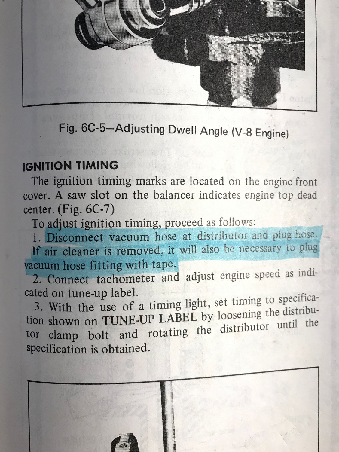

Connect the vacuum advance after completing all your timing adjustments.

Distributor installation/alignment & timing are detailed in the CSM. For your reading pleasure I've attached Timing 101.
