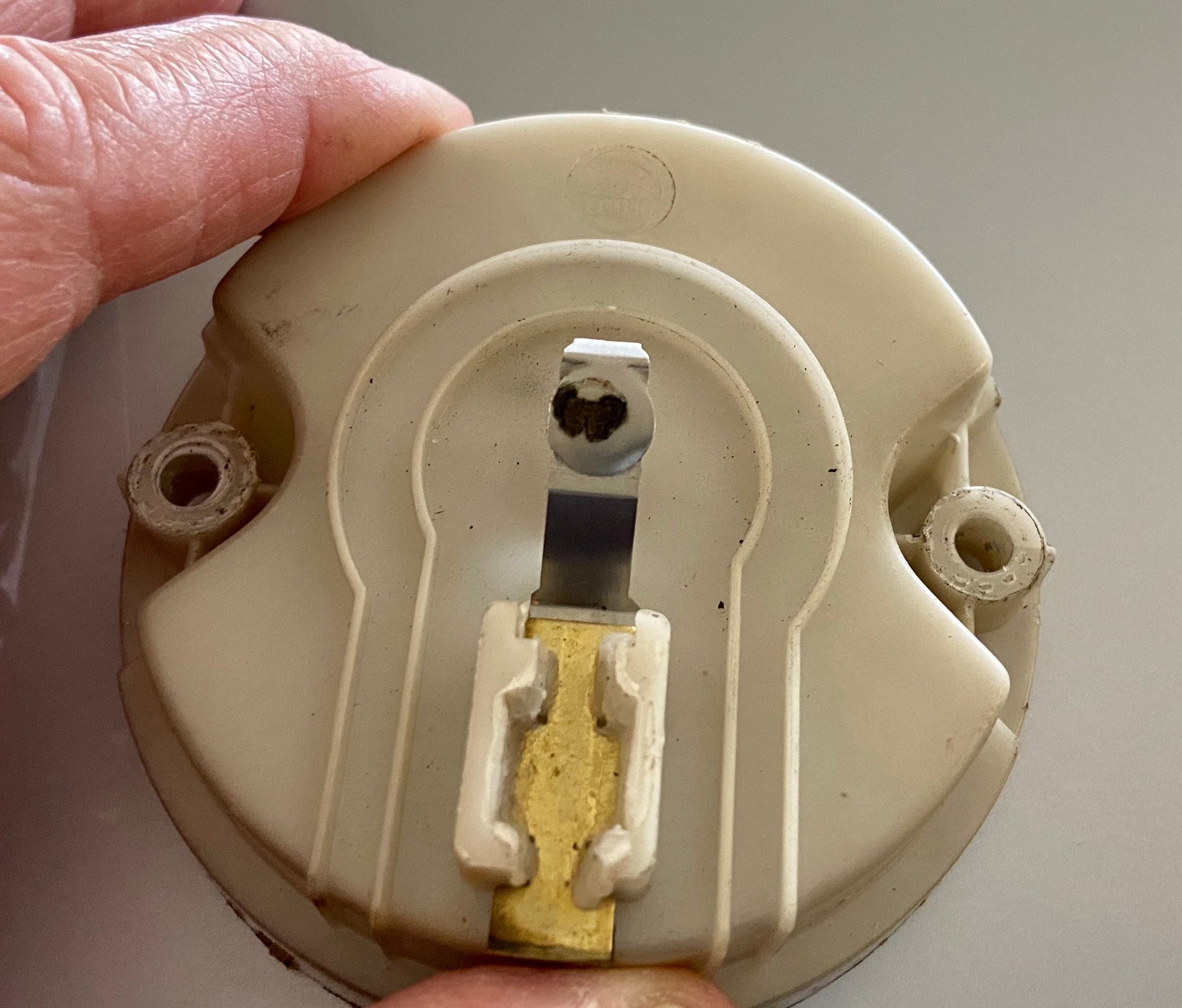

Recent Update... I replaced the Accel hei kit with pertronix hei kit. I still have a rough idle problem and installing a newly rebuilt Q-Jet has not solved the problem. The pertronix runs fine but did not resolve rough idle issue. However, Yesterday I took the distributor cap off and noticed the center contact on the rotor button had unusual wear pattern. Instead of wearing a single spot in the center of the contact tab, it has a circular pattern. See pic. I’m thinking the distributor is worn to the point where it is now wobbling As it rotates. Could this cause rough idle??? The engine was rebuilt by the restorer in ‘89 at 128k miles. I bought it in ‘03 with 133k miles, it now has 153k miles. So if my worn-out, “wobbling” theory is correct the dist will have to be replaced. But... it’s still stuck and I really don’t want to pull the engine to get the damn thing out. Anybody else have this problem? Better yet, any anybody have a solution for cause of rough idle??? Thanks, Roqetman.

Rogetman, that rotor looks worn but I wouldn't call the wear pattern abnormal. I've never heard of a distributor wearing to the point that it wobbles. You mentioned that you couldn't remove the distributor. Please clarify, what distributor does your Olds currently have?

The distributor cannot be rotated to adjust timing. As I recall it is set at 12 BTDC and GM spec is 10 BTDC. I have sprayed PB blaster and let sit overnight and tapped dist base with pry bar and hammer to no avail. The cap and rotor and plugs wires are Relatively new, 8.5 mm wires. I pulled the plugs, cleaned them and they’re all gapped at 40. Yes, i can move the dist shaft side to side with my hand but... I’m not sure how much play is acceptable. The wear pattern on the rotor button seems to indicate to me that the dist shaft is wobbling, leaving a circular pattern. Should it not show a single point of contact with dist cap button? Timing light flash pattern is also odd... almost like a double, weak flashes instead of a strong single flash when firing. And to add to this problem... the newly rebuilt Q-jet has a accelerator pump that sticks some of the time... but I’m going to change it out with a new one.
