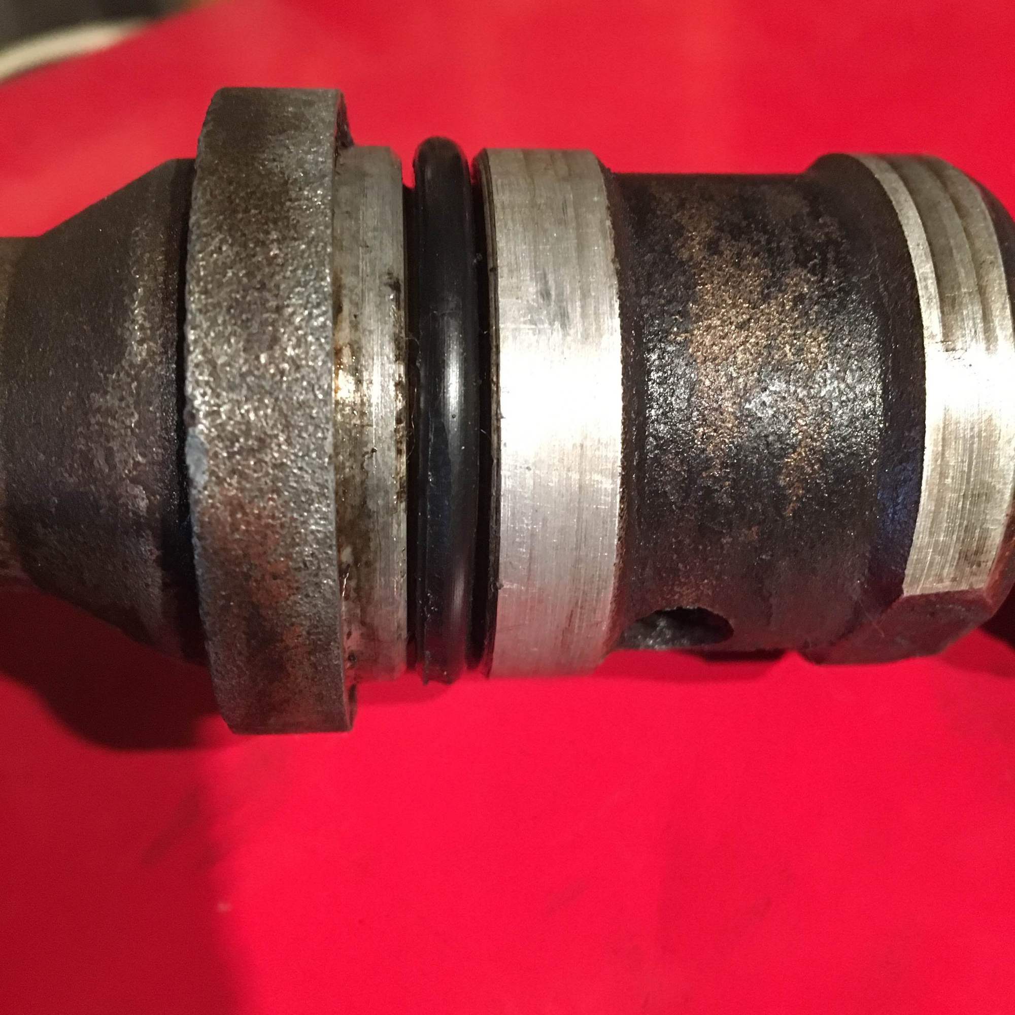

Hey all! Since I picked up this '67 Delta back in September, it's had an oil leak, and it seems like it's gotten a little worse after the winter.
Eventually, I was able to find the source, and it's leaking from where the distributor meets the manifold. I pulled the distributor yesterday to see if I could find any obvious signs of failure in its sealing, and the only think I can think of is if this O-ring isn't the proper size. The Felpro 424, as suggested on the gaskets thread, looks more O-shaped, and this one almost looks D-shaped:
Just curious what your opinion is, and whether I'm on the right track or not. Tired of leaking oil!
Thank you all, as always.
-Jake

Old Mar 23, 2016 | 05:59 PM
Jake Mack's Avatar
Joined: Jan 2016
Posts: 56
From: Hinckley, IL
Here are some more pics of the 424 on it.. I'm curious what you guys think about the fit. These should show the gap I'm concerned with.. also, this is before the grease suggestion. And, I did notice a bit of a gash on one side, some material on the shaft that looked like eraser shavings, so I'm wondering if it bound up and I ruined this one:
Old Mar 23, 2016 | 07:36 PM
MDchanic's Avatar
Connoisseur d'Junque
Joined: Sep 2010
Posts: 21,183
From: The Hudson Valley
That's definitely the right O-ring and the right fit.
There's only one.
The O-ring fills the space when it is compressed by installing the distributor.
What you need to do now is to install the distributor, and then clean off the whole rear shelf area thoroughly with Gunk or something similarly powerful, then drive the car and look to see where the leak is coming from - you won't be able to tell while it is all greasy.
Odds are it's the rear manifold seal.
- Eric
Old Mar 23, 2016 | 09:46 PM
Jake Mack's Avatar
Joined: Jan 2016
Posts: 56
From: Hinckley, IL
There's only one.
- Eric
It sure looks like it's coming from the distributor, but I think you must be right if that's the exact right O-ring. I'll look more into the manifold seal tomorrow. Thanks, sir!
