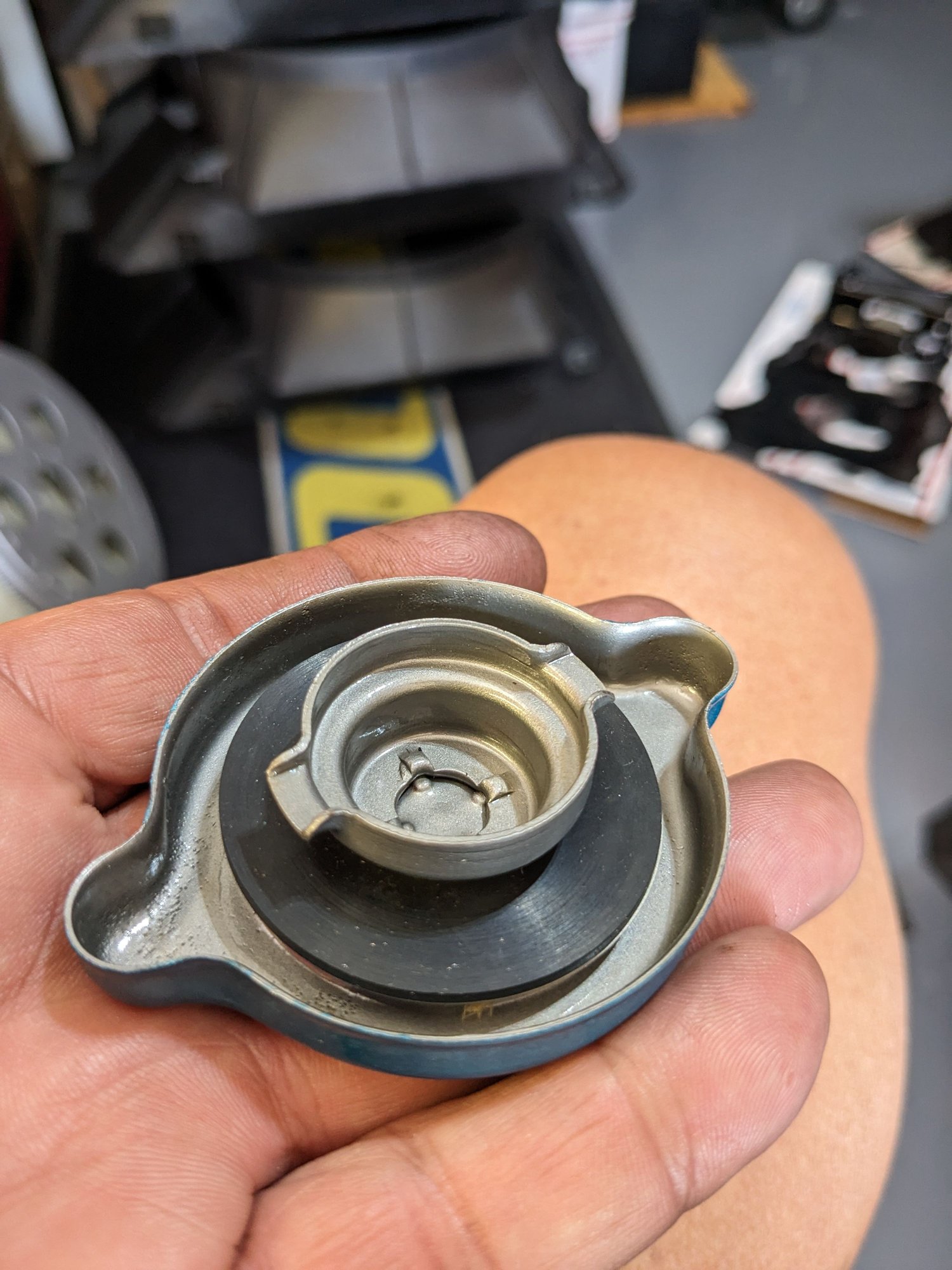

So, I just picked up a few things from Parts Place..and one of those is a new oil fill cap. The old one was pretty beat up and didn't seal well..so I figured why not.
I went to put the new one on, and it won't latch in. I stuck it on the bench next to the old one, and the old one seems a bit taller.
The new one isn't tall enough to clear the rolled lip inside the tube that you turn the cap to secure with..but the old one is just too dang loose. What am I missing here? Or, is this just a case of a bad part?

What does the top of that cap look like ?

Aftermarket crap.
They go through all the troubles to replicate an original piece and do it wrong.
It's easier to do it right.
​​​​​​Throw your original one in the blaster and put a new seal on it.

I really think these repro places NEVER try installing their so-called parts on an actual car.
BTW - the "seal"/gasket is sandwiched between parts of the cap that are spot welded together. Maybe you could make a new seal and slip it behind/on top of the original seal on the cap...sort of tighten up any excess clearance b/n the seal and the oil fill tube.

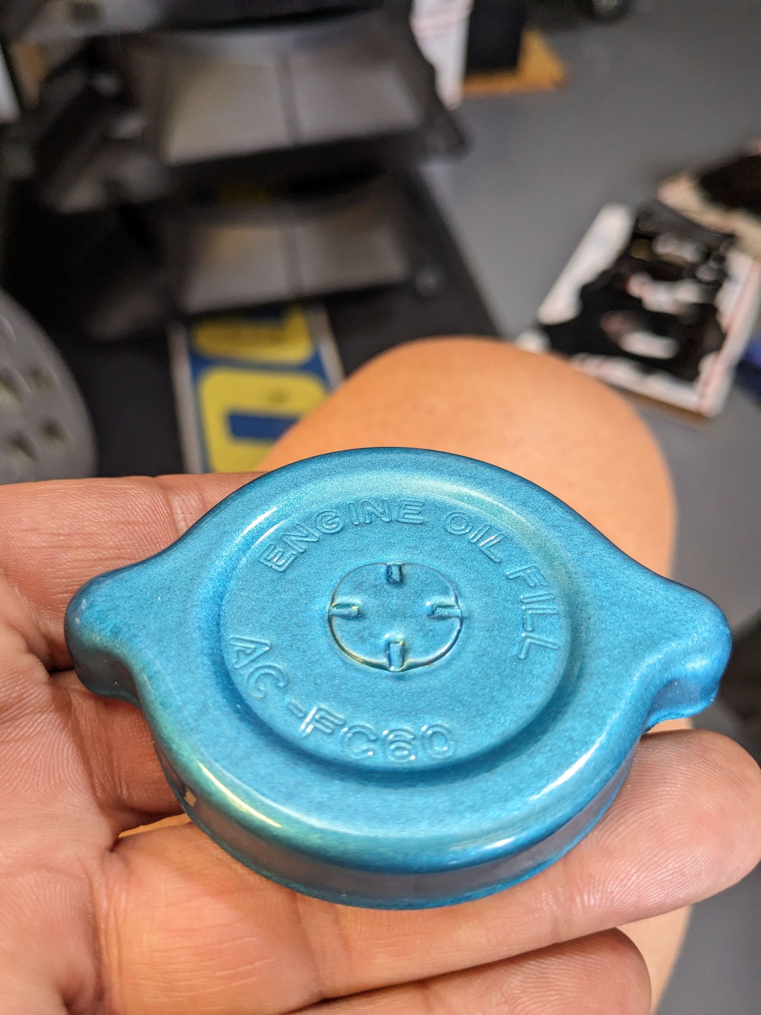

Original cap through the blaster and painted
Cleared the underside and installed new gasket
gasket from cheapo $4.90 Duralast cap # 8066. Had to trim a little for perfect fit

Yes there are 2 felt gaskets. One below the metal ring and one on top. I kept the lower in place being careful not to damage it in the blaster. Replaced the top gasket and works like a charm.
