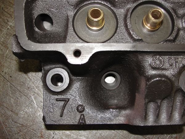

Old Dec 15, 2020 | 02:59 PM
Posts: 50,770
I always thought the lower case "a" represented the small design change to signify the case hardened seats?
1971 G and 7 heads (sans "A") have hardened seats. So do J and 8 heads. It's not a lower case "A", it's a small capital A. Ironically, in the case of the CA heads, both letters are the same size and smaller than normal.
Old Dec 15, 2020 | 03:09 PM
Posts: 50,770
I guess I still have a question though, which maybe you answered by default?
The "reasons" for the additional "A" was to "signify" a design change of which was the transitioning to case hardened valve seats during this time frame? That's what I recalled during this period of time, but I'm not completely certain, perhaps you know for sure?
It was a change of some sort, but as the 1971 heads show, the hardened seats aren't that change.
