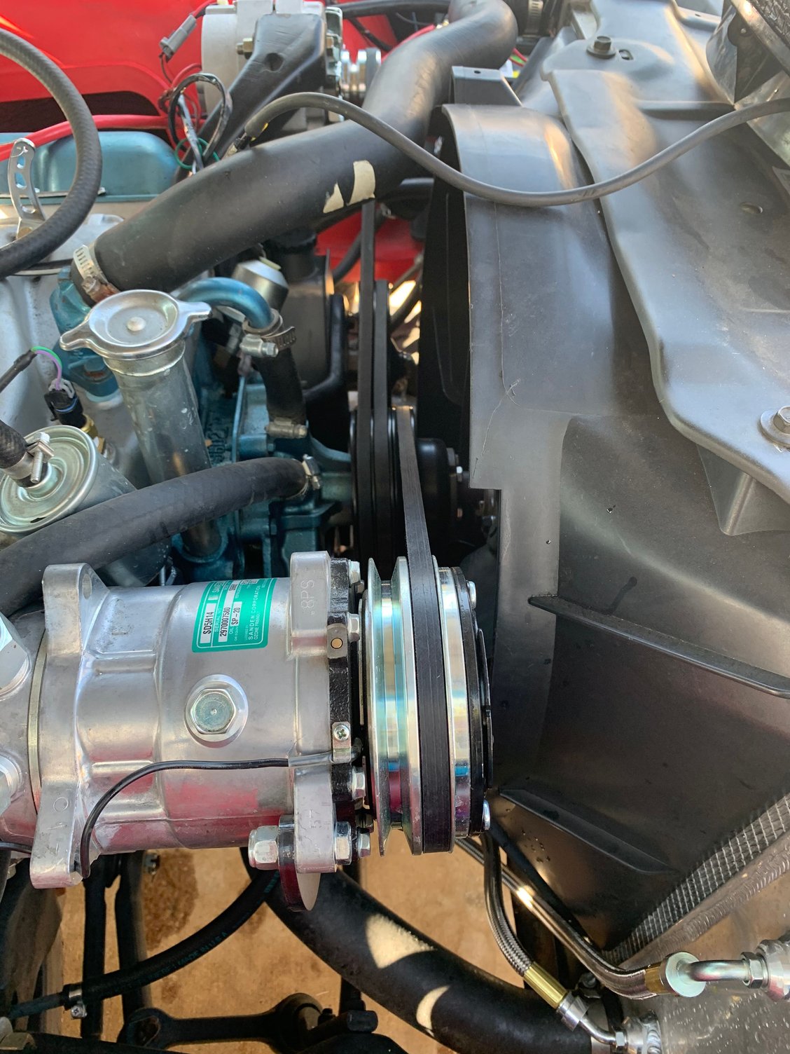

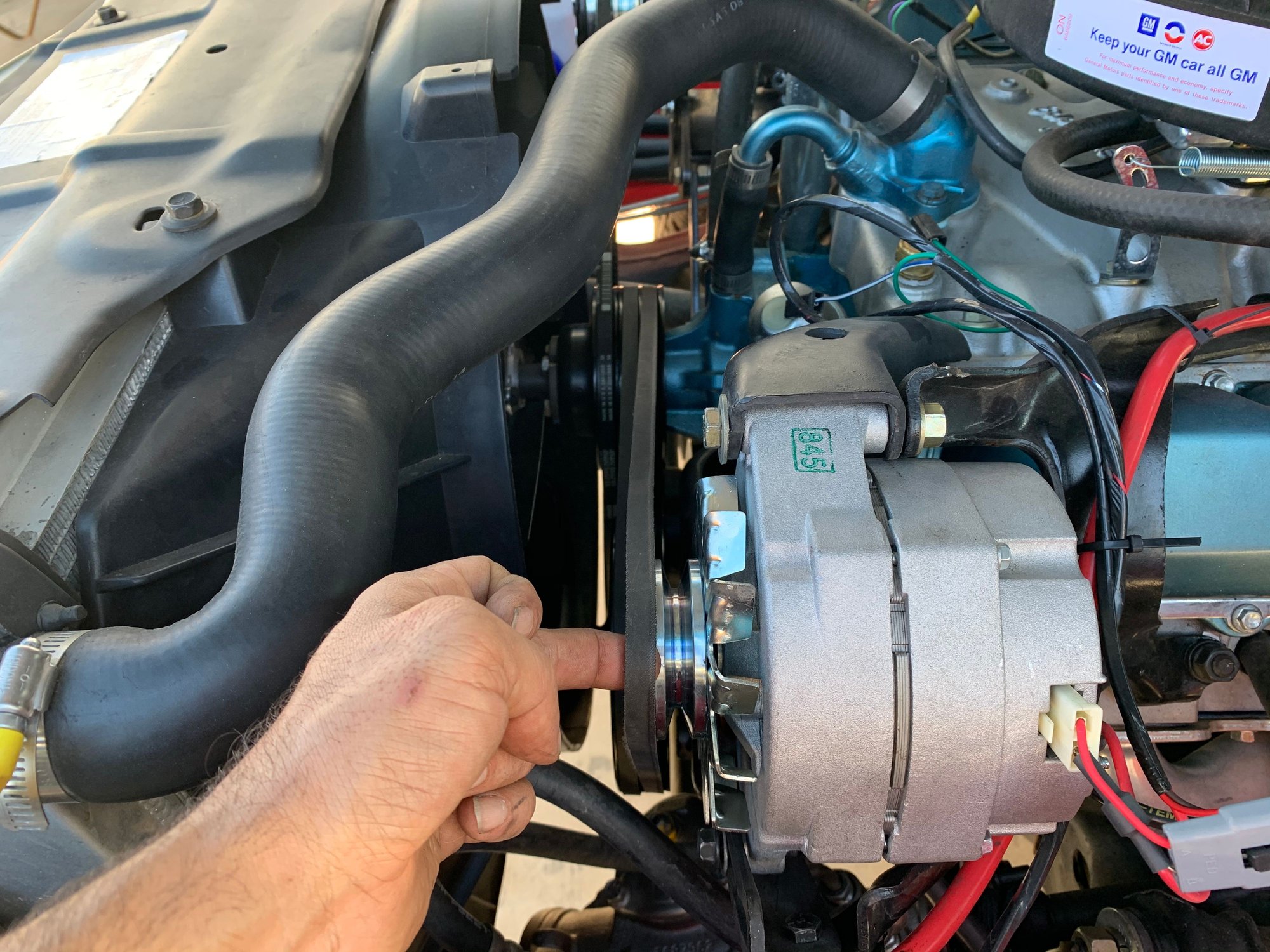

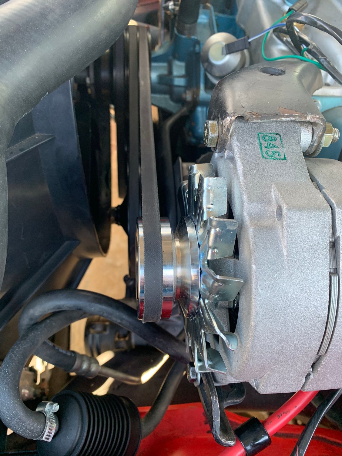

anyone with Aluminum heads ever run into this problem with the C and H alternator brackets? The crank, power steering and Vintage Air all lineup perfectly but the alternator is one groove back from perfect. The alternator is from Autozone and is new and was correct part number for that year according to their system. The belt does go on but squeels back and eventually gets chewed.
did the stock C and H bracket need a spacer behind between the bracket and heads OR did the 1970 Olds 442 with 455 have a Dual groove pulley originally? That seems to be only immediate solution so I went ahead and ordered one.

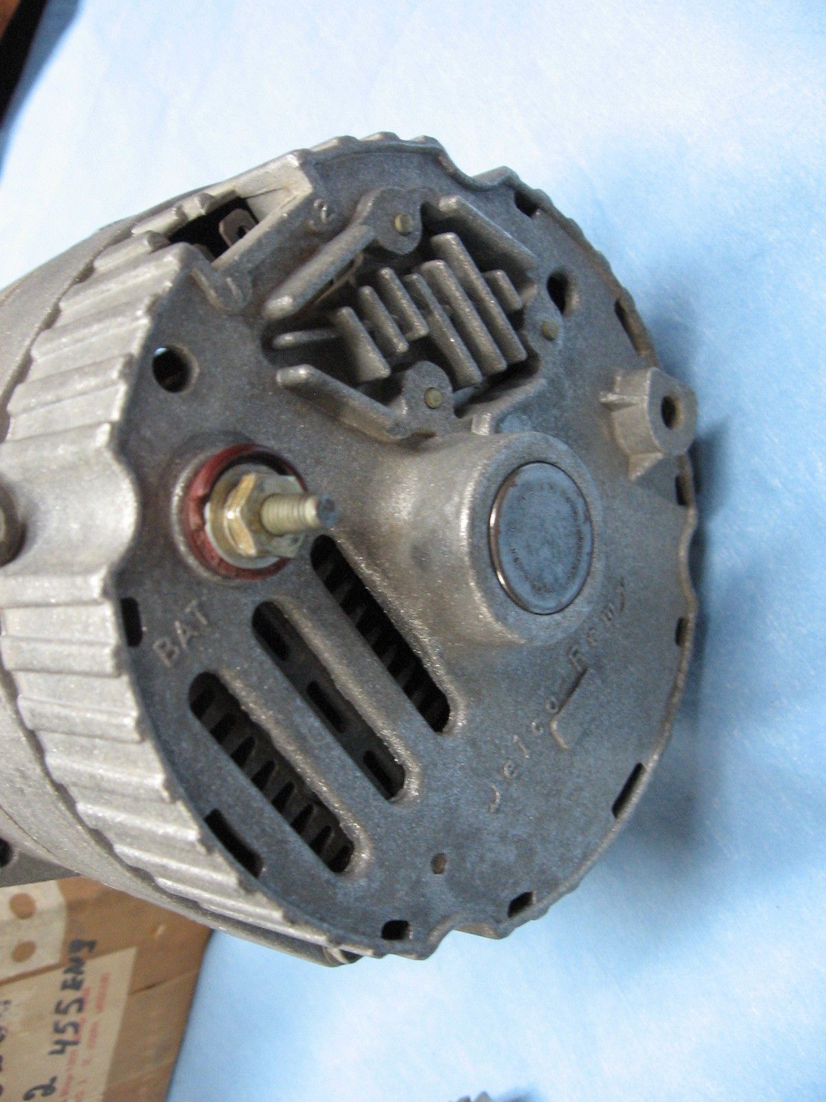

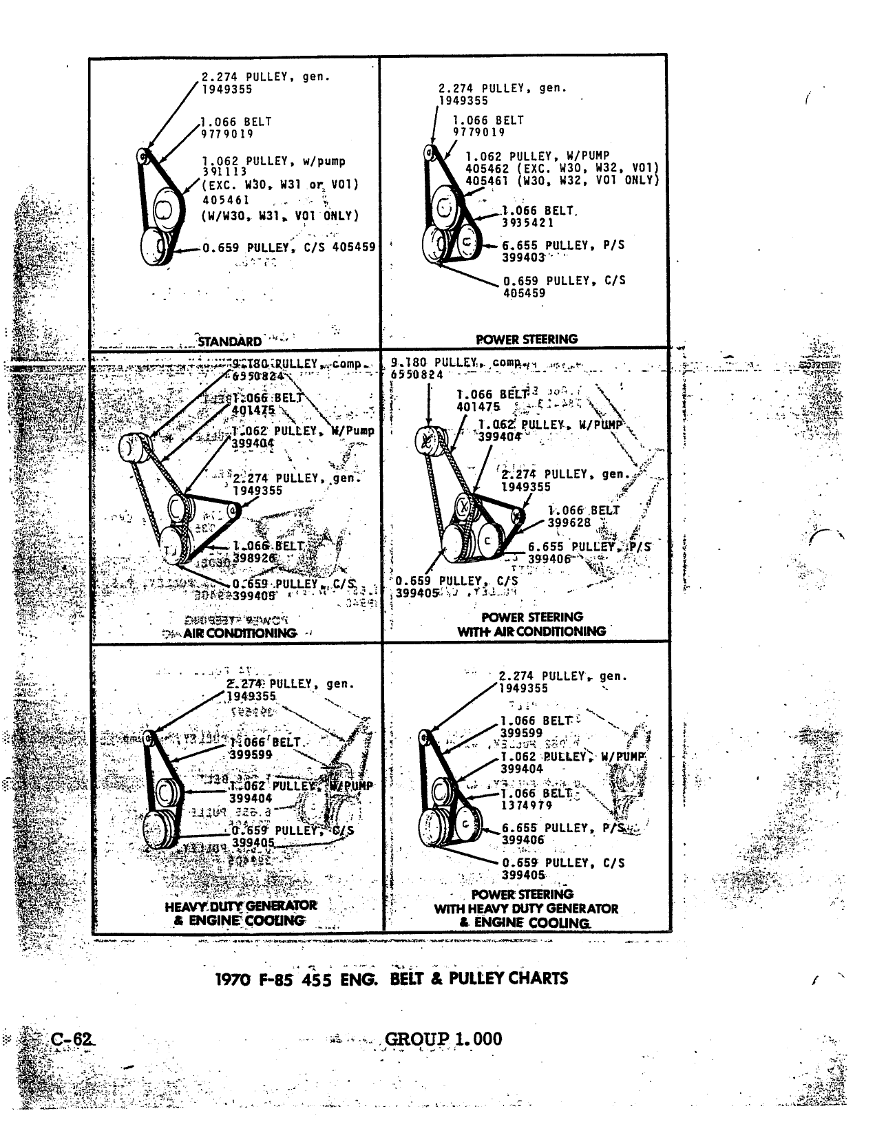

A single groove pulley is correct, and while it is dimensionally the same, that is not the correct alternator for a 1970 442. There should not be any spacers required.

I have aluminum heads, Vintage Air, and everything lined up on my car. I don’t recall what pulleys I used, but they are the correct codes for a 69 with factory air.
Im using a CS-130 series alternator. The original application had a serpentine belt pulley. I transferred all the v belt hardware and pulleys from the old alternator to the CS part, everything lined up.
Wish I could be more helpful. Was this a factory air car you converted to Vintage Air? If so, did everything line up before? If this is a new conversion, I’d suspect wrong water pump (with the matching but incorrect pulleys).

Factory pulleys for 1970 are:
KF 399404 Water Pump (three groove)
KC 399405 Crankshaft (three groove)
KH 399406 PS Pump (two groove)
1949355 Alternator (single groove)

Is hub on water pump set deep enough, power steering belt looks like it could go back too

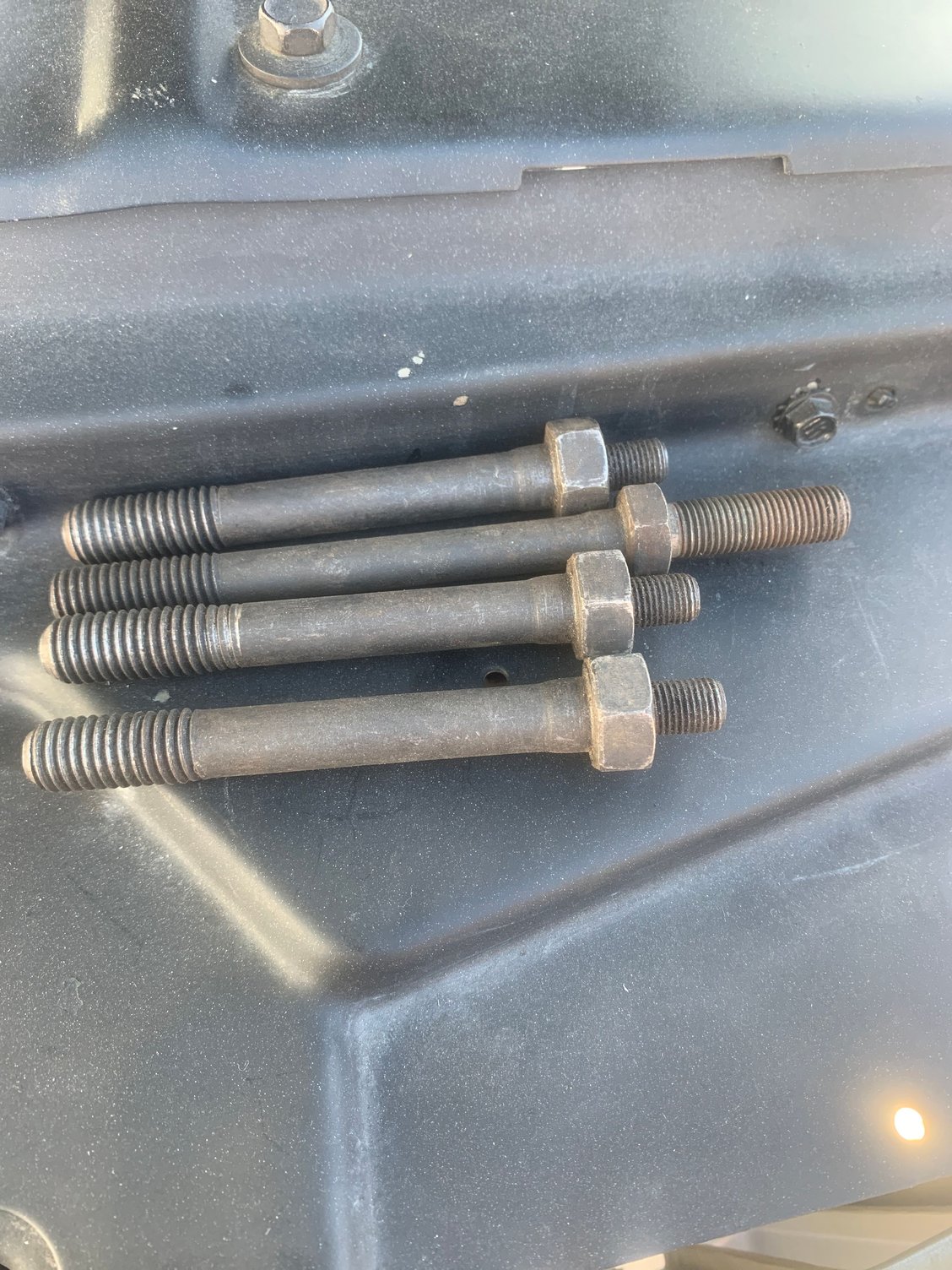

I think i may have found problem. The bottom back H bolt hole is under the head ARP bolt. The original head bolt had a stud. Here are OEM bolts. The rear bolt would give the alternator bracket a little more height and push the bracket forward. Which Of these bolts is right one to replace the ARP bolt?

The longest one (second from the top) wound be correct.

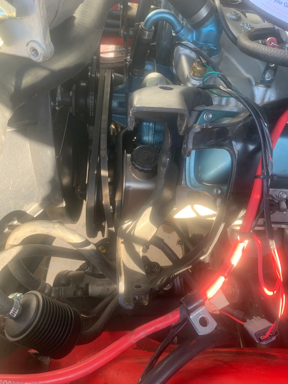

OR. Maybe the bracket is bent!?!!??
i bought the bracket off here five years ago when I started the project. Look how it curves back toward driver
The long one is also the only bolt in that photo that's 7/16". The other three are 1/2" and won't work anyway.
