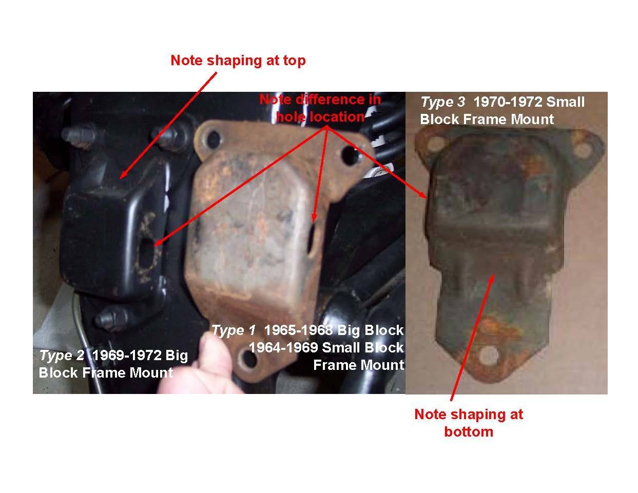

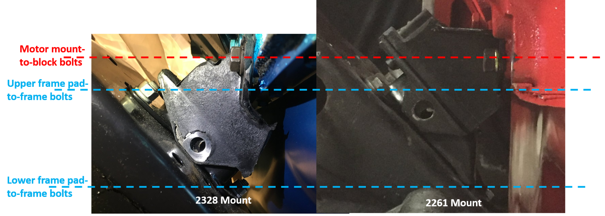

The motor mounts MUST match the frame pads. Without knowing which frame pads are in the car, there is no way to tell yo which motor mounts to get.
When matched properly, the crank centerline ends up in EXACTLY the same place, no matter which 1964-90 Olds motor you have. Note in the second photo below that the 2328 mounts with matching frame pads tucks the mount further under the pan rail and closer to the pan. This opens up a smidge more room for headers, no matter which motor you have. And once again, the only motor mount used in A-body cars was 2261, no matter which engine (330, 350, 400, even 455 in the 68 H/O). The only motor mount used from 1973-90 was 2328, no matter which engine (260, 307, 350, 455, diesel).

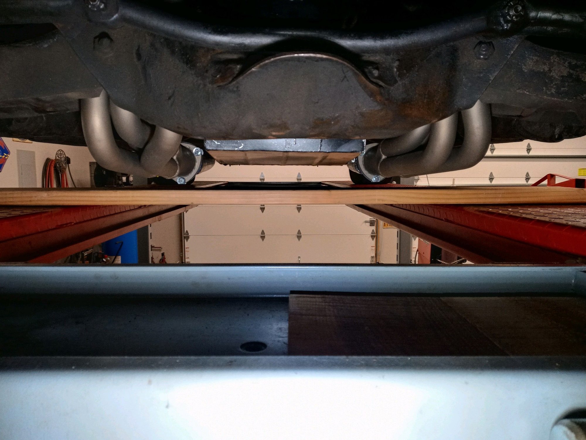

I've got a really nice set of long tubes from Hooker. Problem is on my car they are too low. Looks like the drop spindles have to go.
