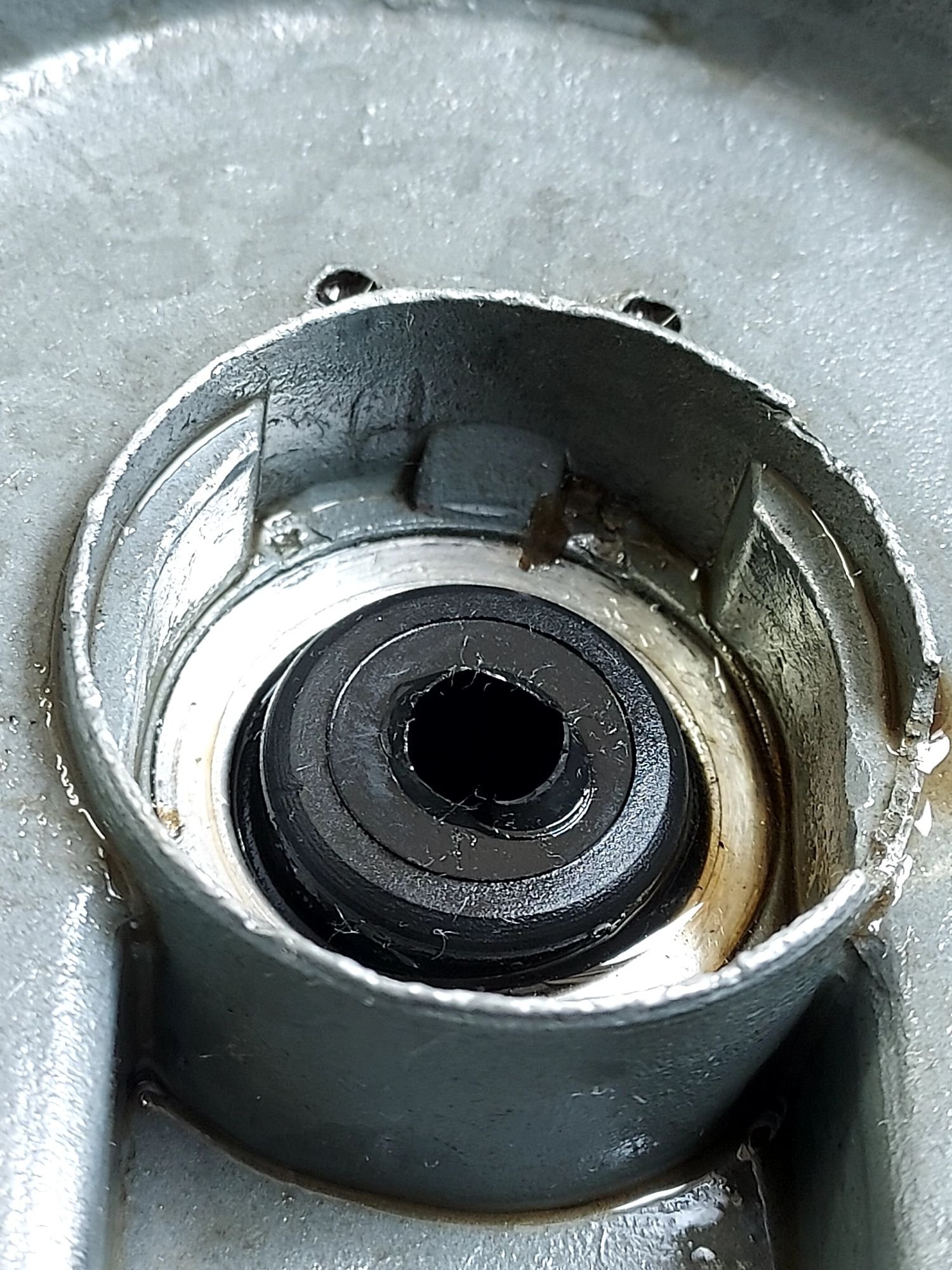

There are 2 hole inside here and looks to be a clip that isn't holding anything.
oil must be coming out of these holes.
I'm gonna open pump and look.
Fresh rebuilt pump maybe 200 mile ago

Brand new seal coming apart

Guessing is over.
Its 100% the fuel pump.
Oil pushing past bad seal and out the 2 vent holes.
New seal on the way.
