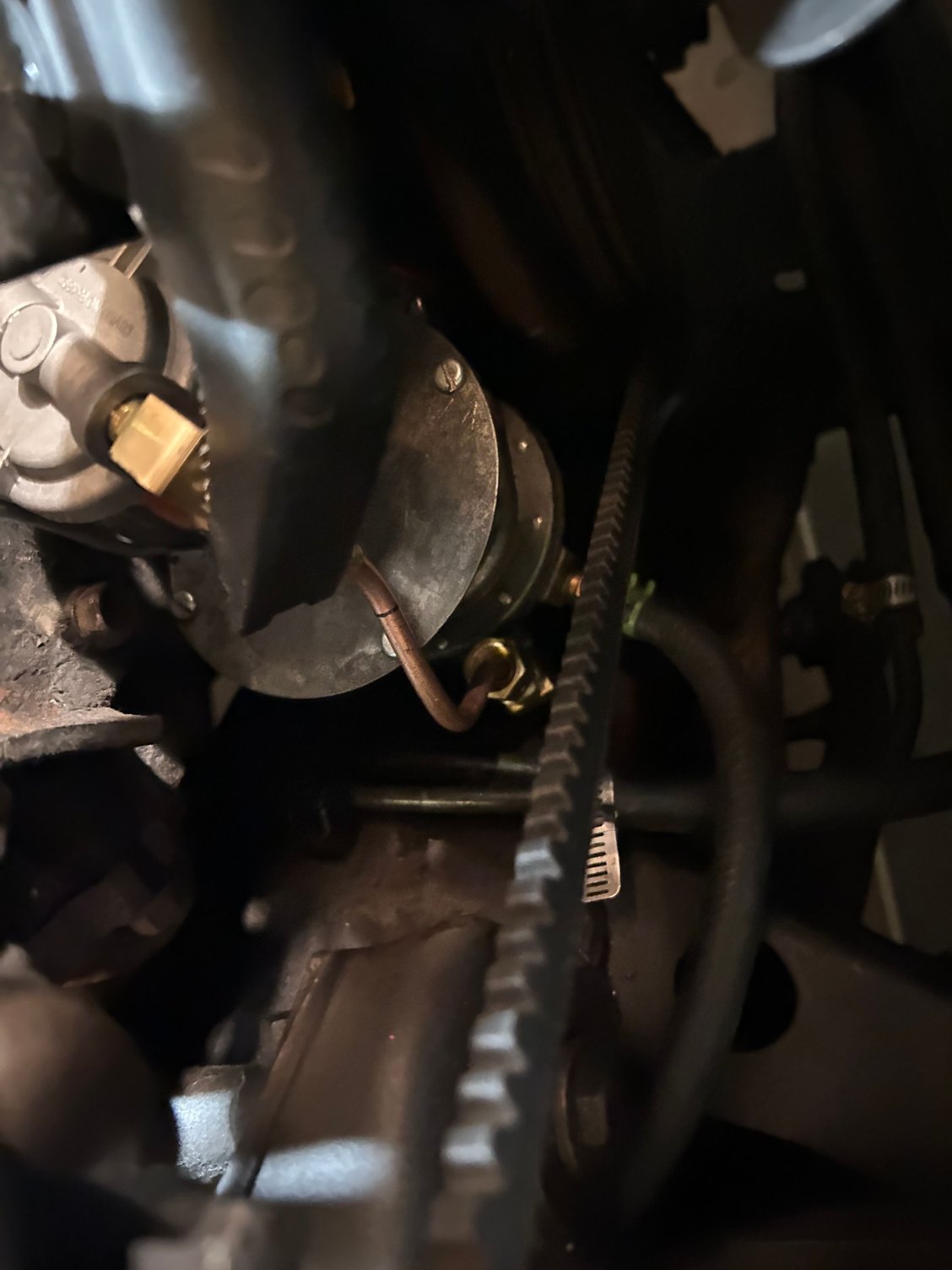

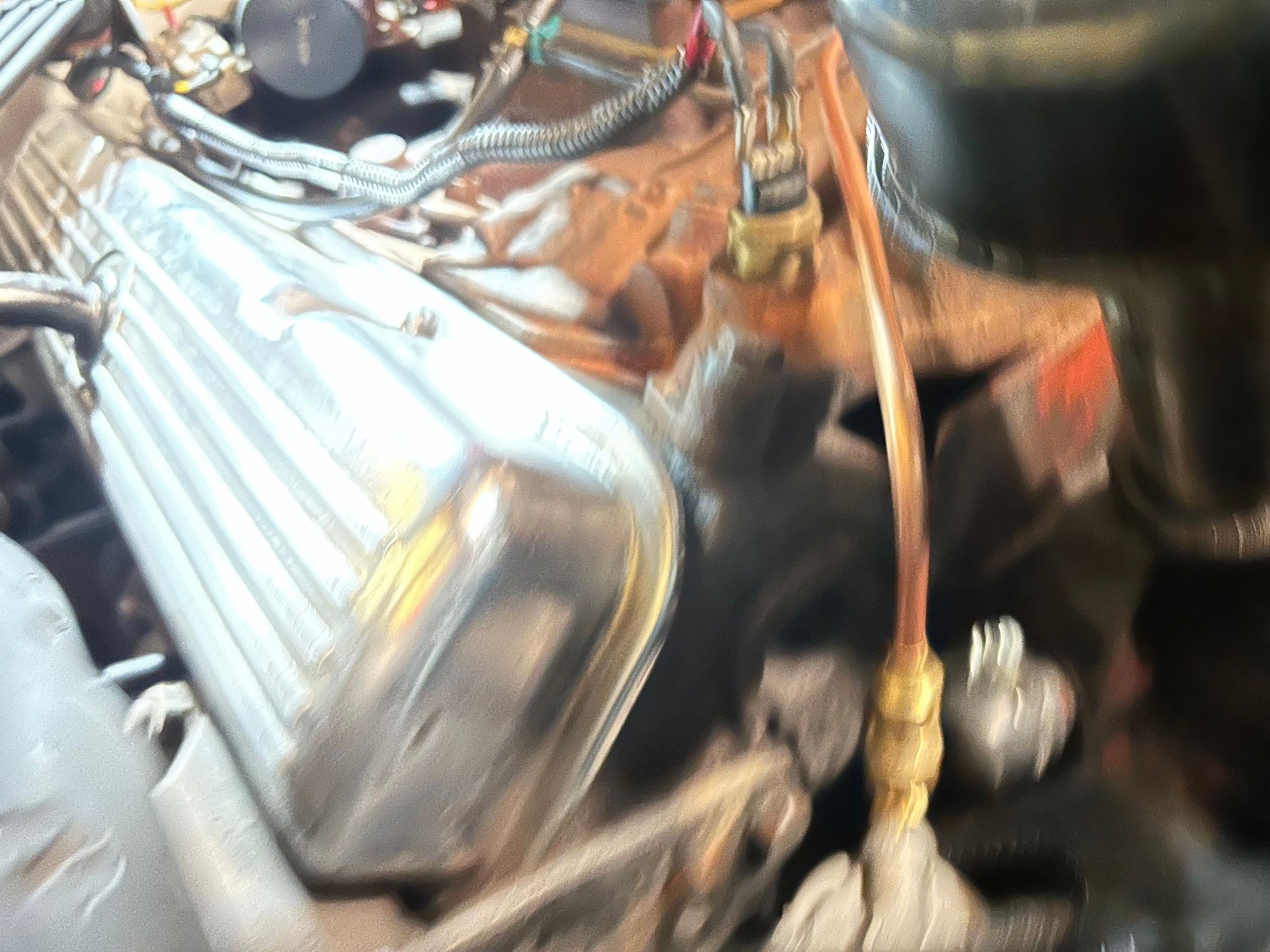

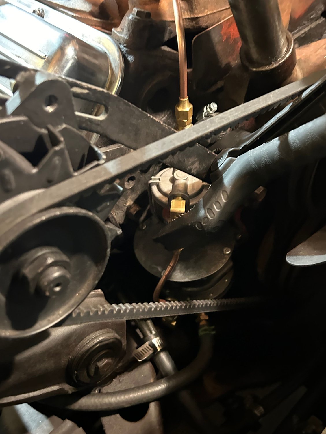

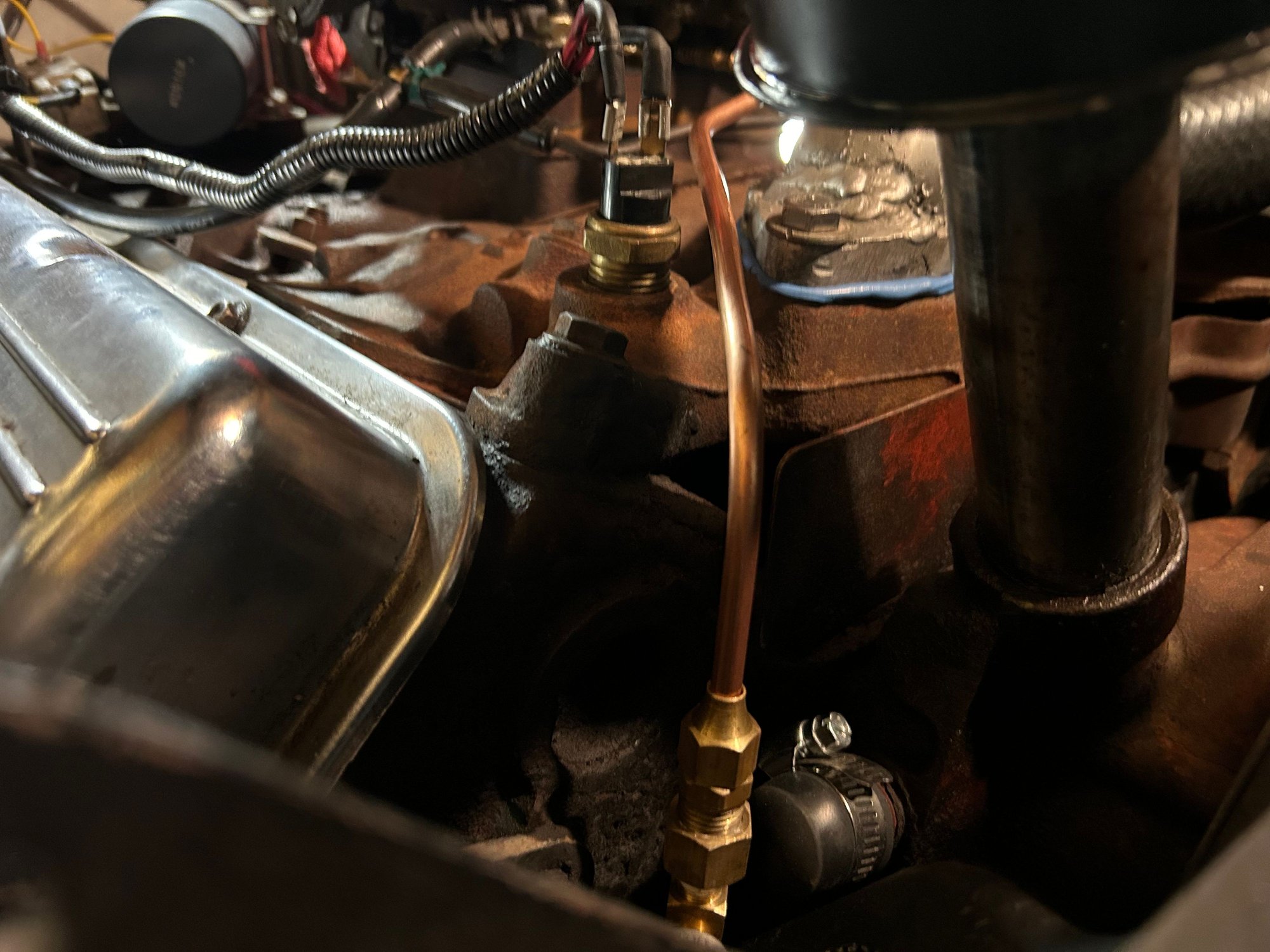

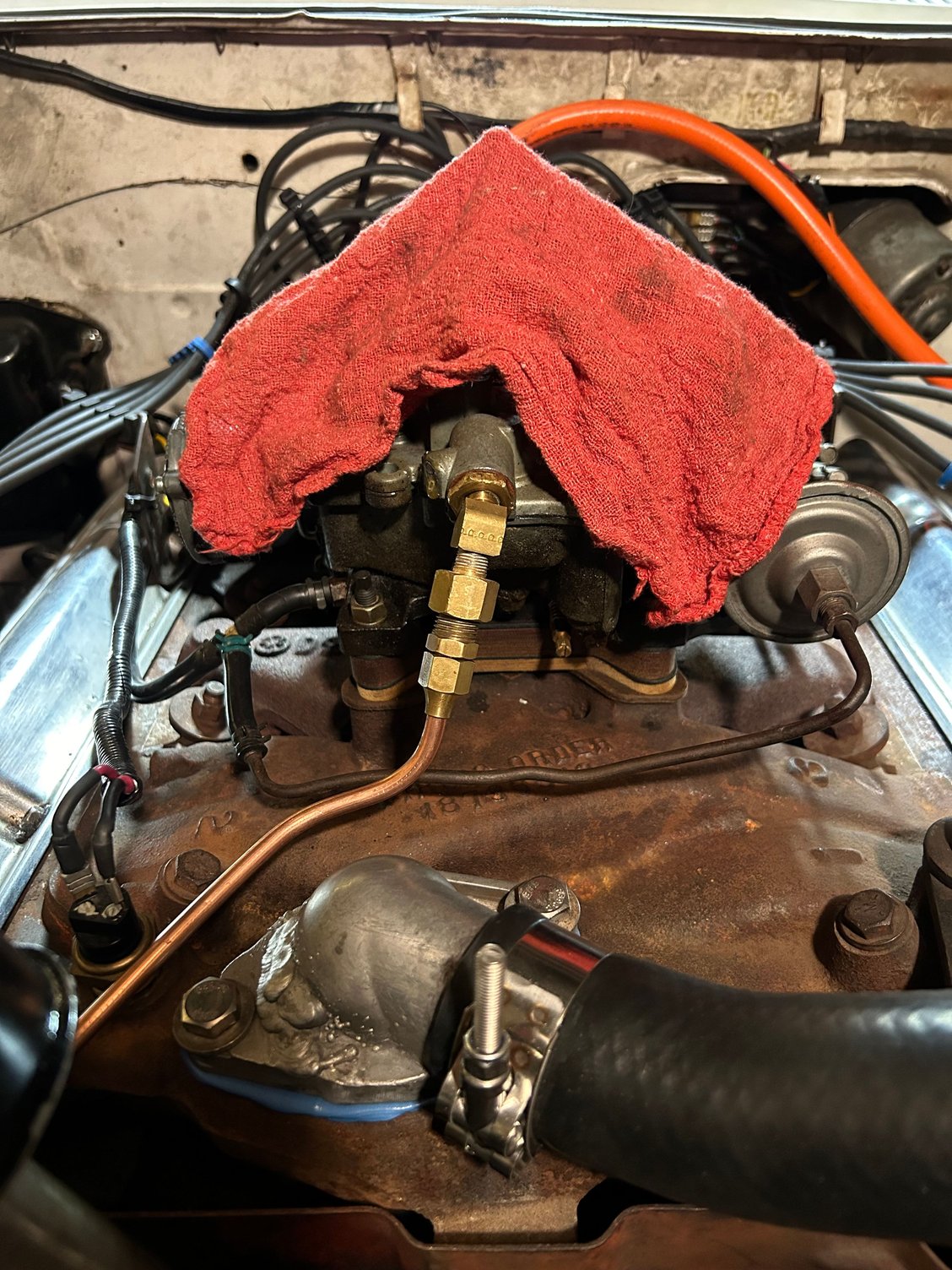

Thanks! Here’s some pics of my “mock up”. Is this path ok? Does it matter if it’s this close to the engine?
Old Mar 29, 2024 | 07:43 PM
ourkid2000's Avatar
Posts: 1,279
From: Nova Scotia, Canada
I think that looks really good. Just keep about a 1/2" clearance from the engine so that you don't risk any chafing and I'd call 'er good! Double check it for leaks as well.
Some weird looking fittings on that thing, is it stock?
Nope this is just temporary, they’re just compression brass fittings, not even tightened up, they will NOT be used for the final setup, this is was just to keep things in place until my 3/8 line and fittings show up. Don’t worry, I’ll double flare the connections properly.
