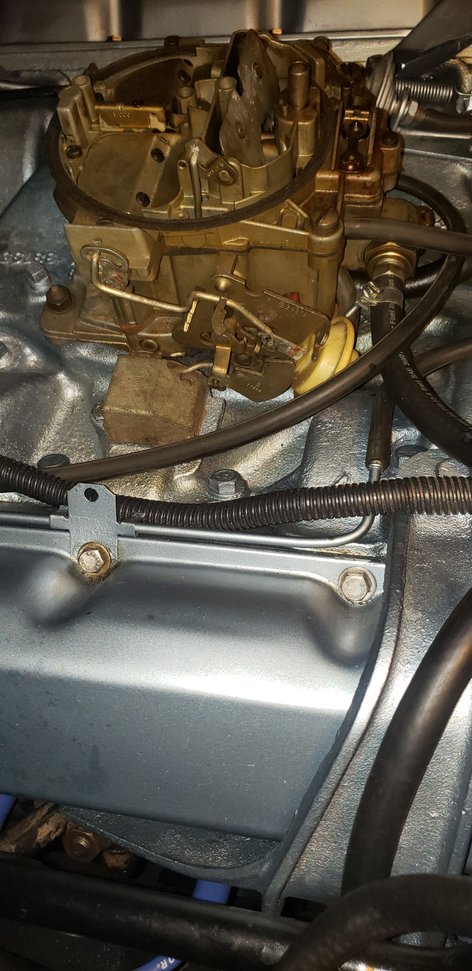

Ok so what type of choke is this, and what is this box mounted right on top of the crossover. Is there a thermostat in there?
