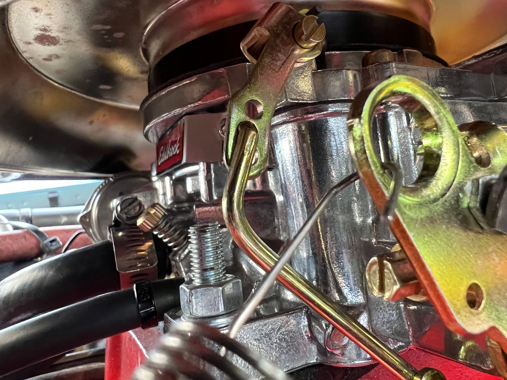

455 with the edlebrock performer intake and a brand new 1411 750 carb with electric choke. I just put the new carb on and I’m having an issue. The issue is when im sitting idleing in park and punch the throttle real hard the car like stumbles / shutters for a second then revs out . But if you gradually apply the throttle it revs out smoothly as it should . Car does not do this when driving and you stomp it doing 40 . I’m very confused as to why this is happening. I’ve been told by a few people that it’s just the nature of the beast but it did not do this when the 600cfm 1406 was on the car . Any input would be appreciated.

Check the accelerator pump setting. You may also need to move the rod to the lowest hole to allow a larger volume of fuel. The pump should put out fuel as soon as the linkage moves. Also timing can cause this issue.

I did move it to the center hole. This did help but not completely . The top hole closest to the carb was the worst and the bottom hole was not any better than the center.
