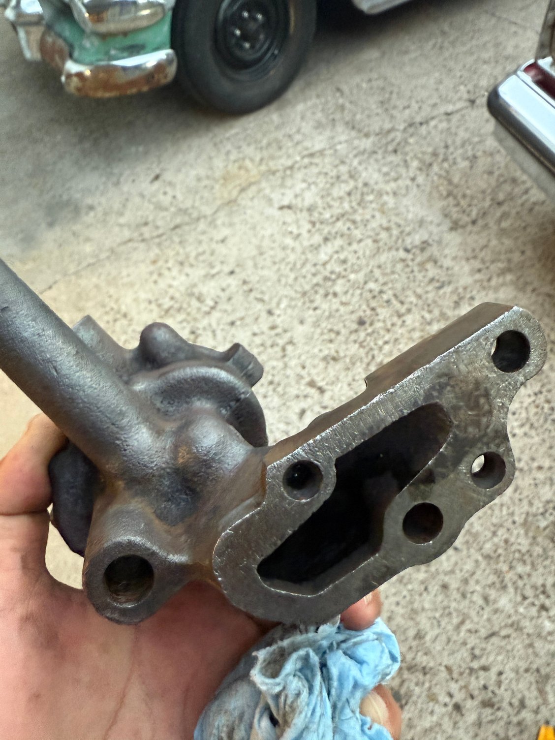

Coming back to an old question
I am currently redoing my oil pump and it looks like there are fragments of this gasket after I took off the plate to the pump. That is where this gasket lives. All my internal parts are fine but they don’t just sell this gasket anymore by itself you have to buy it as a set. When I looked at some information about oil pump designs it says metal gaskets like these were used to creat pressure. As my initial thought was what is it going to leak if it sits in oil. It leaks air— pressure. Again if the metal is pretty flat there shouldn’t be much room to cause an issue. I was going to just spray a copper coating on each said and put a little more lbs of torque on the bolts… any alternative suggestions. For a couple bucks I would have said it’s worth the safe guard but for the kit. I mind as well grab a new oil pump.

There is a specification for clearance between the bottom of the rotors (gears) and the bottom plate of the oil pump; thus the need (sometimes) for a thin gasket there. That spec is found in the CSM. In my 1967 CSM that spec for all V8 engines is 0.0025 to 0.0065 inches.

I am not sure how I would measure the gap but the pump doesn’t turn when everything is back together and tight. I believe it is for clearance and I am curious if newer internals will keep everything from sliding around too. This is where the gasket goes.

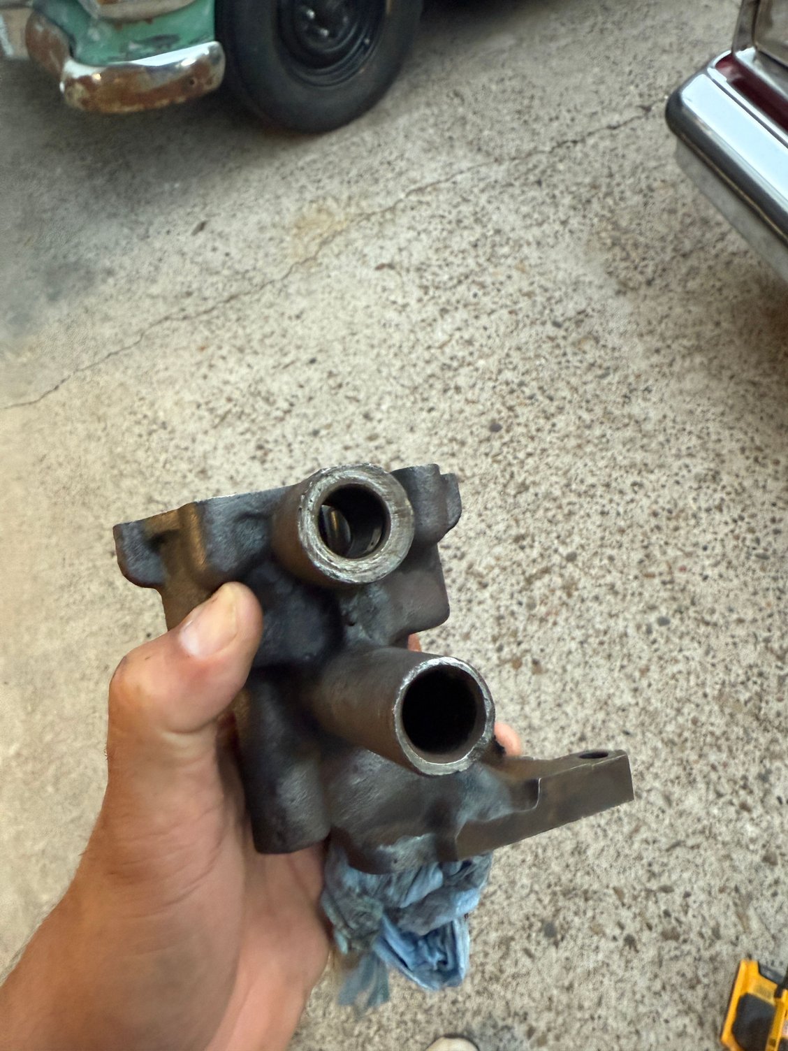

This is where it mounts to engine
This is where the pickup and the spring goes
