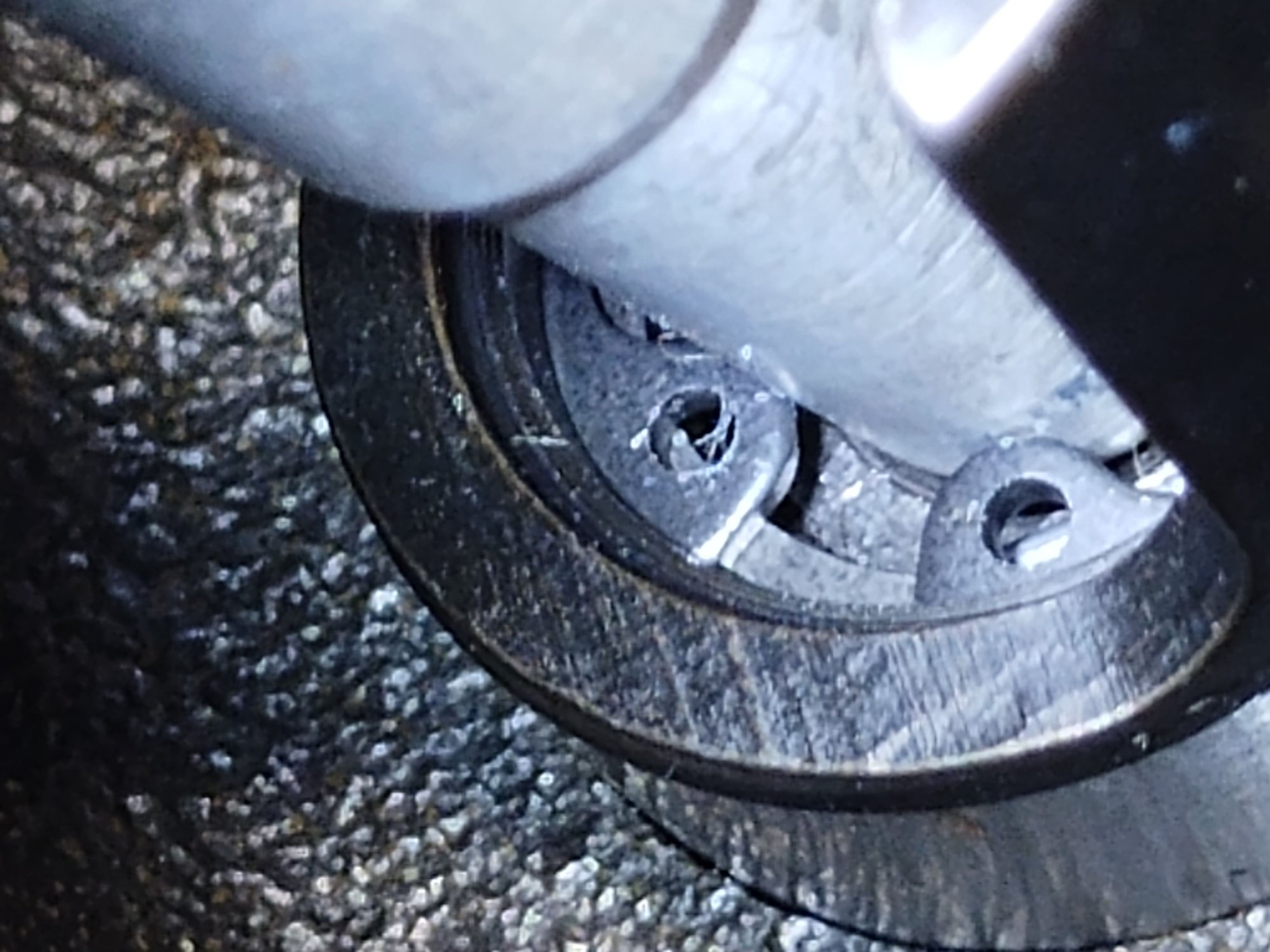

Make sure and take a close look at the snap ring that holds the cartridge in place. The early ones had a snap ring that would actually hit the pushrod. Comp has the correct rings and will send you a set for free if you need them.

Thanks Bill, I will request a set if needed. I am planning on 3/8" push rods, which will probably have interference.
Old Aug 20, 2025 | 06:55 AM
BillK's Avatar
Joined: Dec 2016
Posts: 1,971
Here is a picture of the new clip. Easy to see the difference.

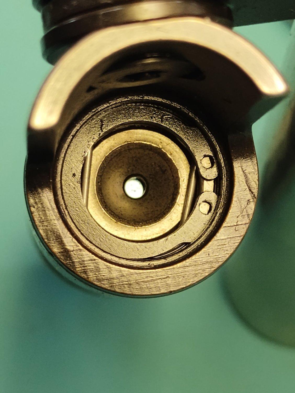

Here is mine dated 02/16/22

No need to get Mark involved. Send an e-mail to Comp with their contact form. Thats what I did and I had a set of the new clips in a couple of days. You will need a very good set of snap ring pliers with very small tips.

Comp used an unusual ring on these lifters. When I needed them I also checked McMaster and could not find them. I get stuff from McMaster at least once a week. Not saying they cant be found with some searching but its a lot easier to get them from the source. Comp sent the correct ones out so it was not a problem.
Have you actually seen the Evolution lifters ? They have a separate removable cartridge in the body. Looks suspiciously like some type of import engine lash adjuster.
