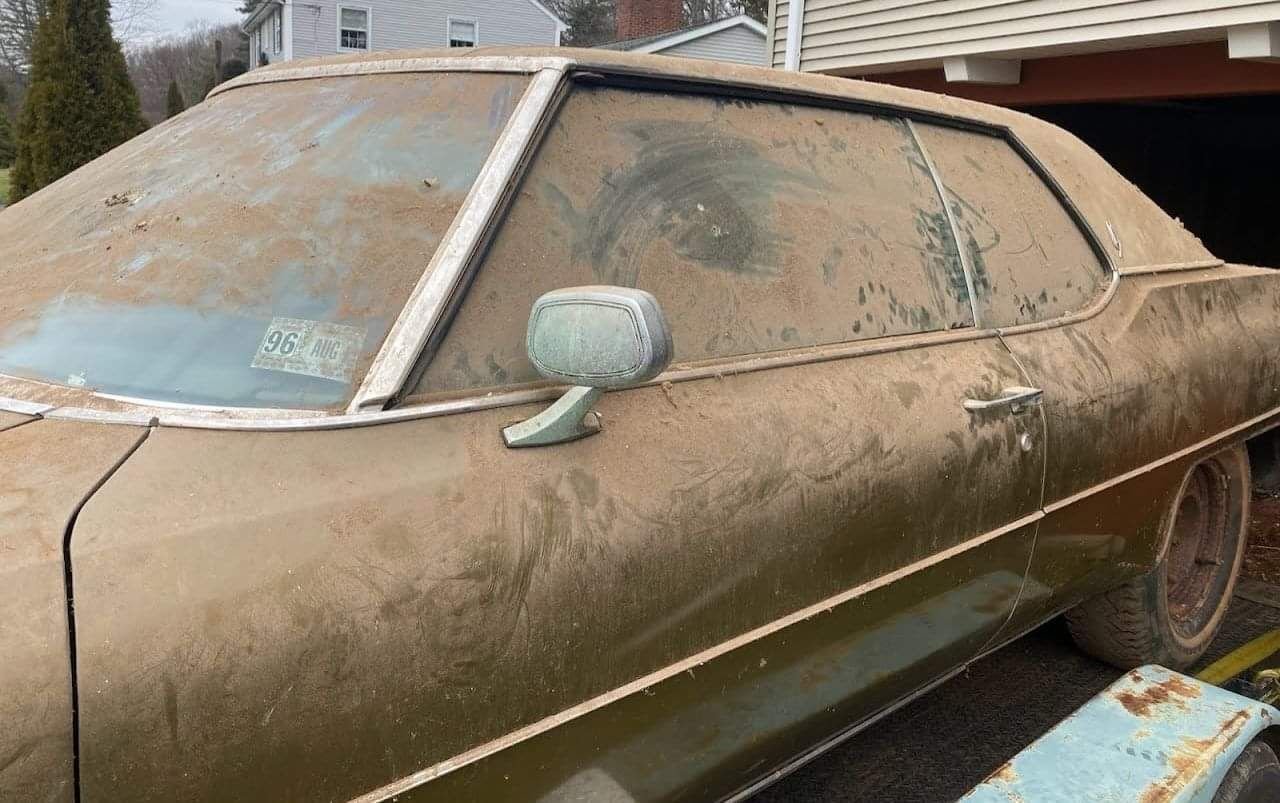

72 98, NICE car! Got any pics?
The first couple are from the ad on Facebook Marketplace when it was pulled out of the garage is sat in for the last 20-something years. It ain't perfect, some surface rust here and there and other stuff like trunk pan need immediate work. Interior is incredible - though I did just post in ..."Interior" section about how best to clean the cloth seats; if in fact they're cloth :-). Not hard plastic vinyl. Loving bringer her back to life.

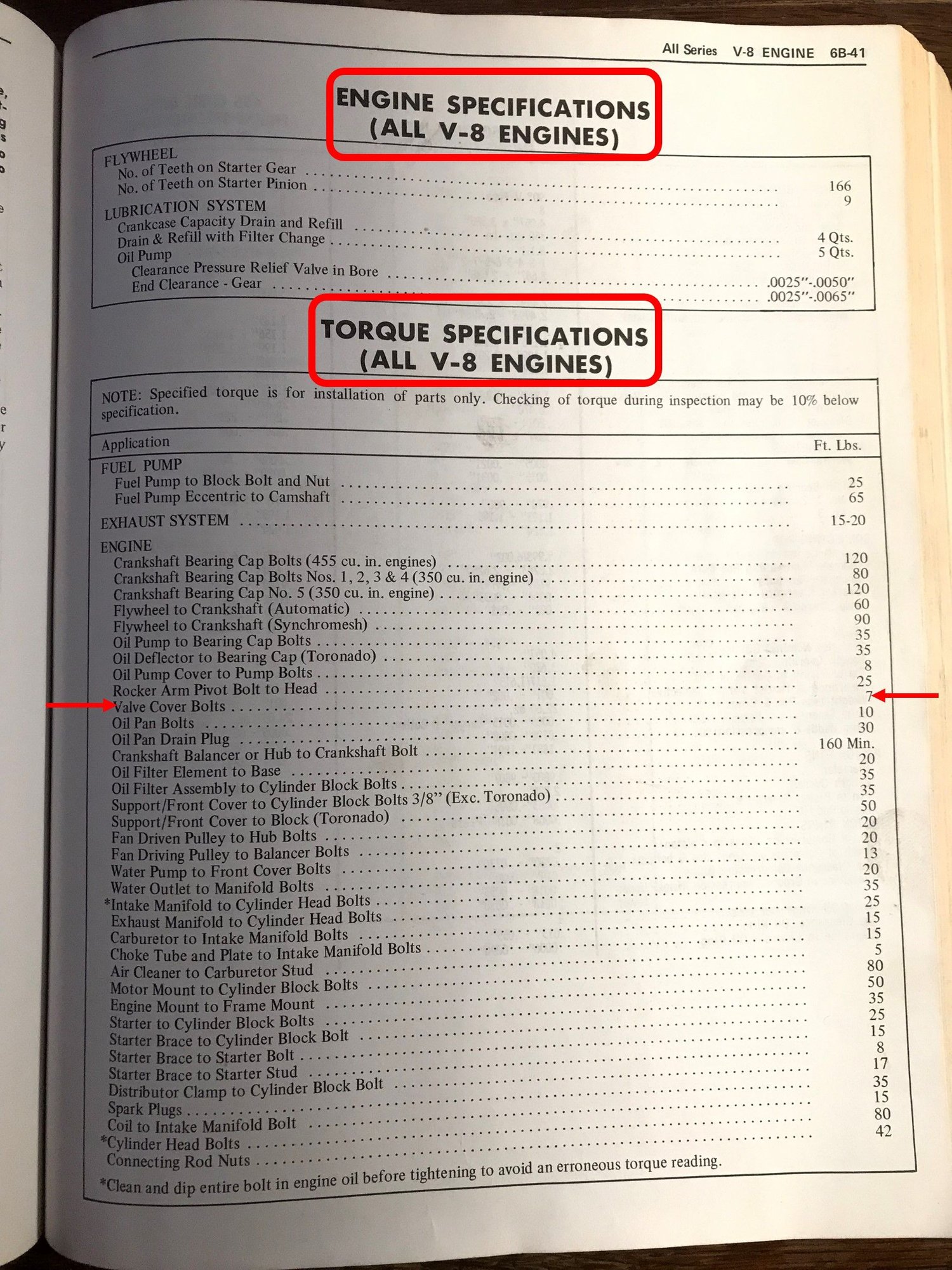

. Thank you. What should I torque them too?
Old Apr 4, 2023 | 09:06 AM
Posts: 25,676
I believe the torque value is listed in the CSM.
Old Apr 4, 2023 | 09:10 AM
Posts: 25,676
My (personal) cheat-sheet list demonstrates 7 lb-ft/bolt. Perform it in a cross-pattern.

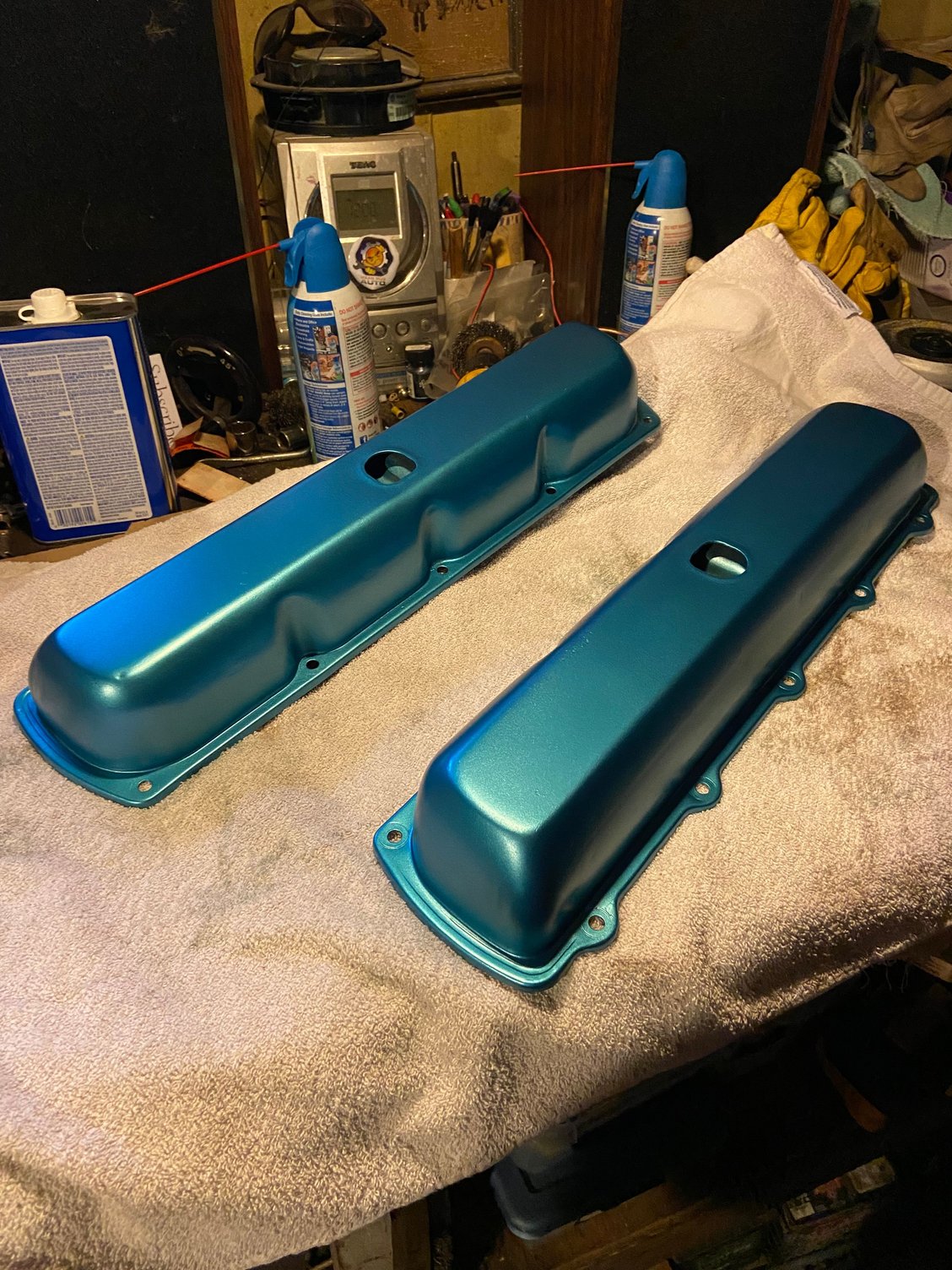

I did as post #12 mentioned, and most of the bolts holes that jut out were in fact warped a bit, so she’s good and smooth/level now. Cleaned the heck out of both mating surfaces and getting ready to reinstall. I painted them yesterday with Fusicks Olds color paint. Question:
Are we still using gasket sealer these days, and assuming we still do - what’s the best kind?
Old Apr 12, 2023 | 11:06 AM
Posts: 25,676
Valve covers look excellent. What type gasket you using - cork or poly/fiber? I know folks who don't put any gasket sealant on cork while others do & if they do it's a very thin amount barely enough to wet the surface of the gasket & only enough to hold it in place to the bottom of the valve cover while you install the valve cover. You'll most likely get many suggestions on which to use, but the past several times I've had my valve covers off I've installed them w/ Permatex® Ultra Grey® RTV Silicone Gasket Maker - mostly because I had a tube of it and I've never had any leaks.
