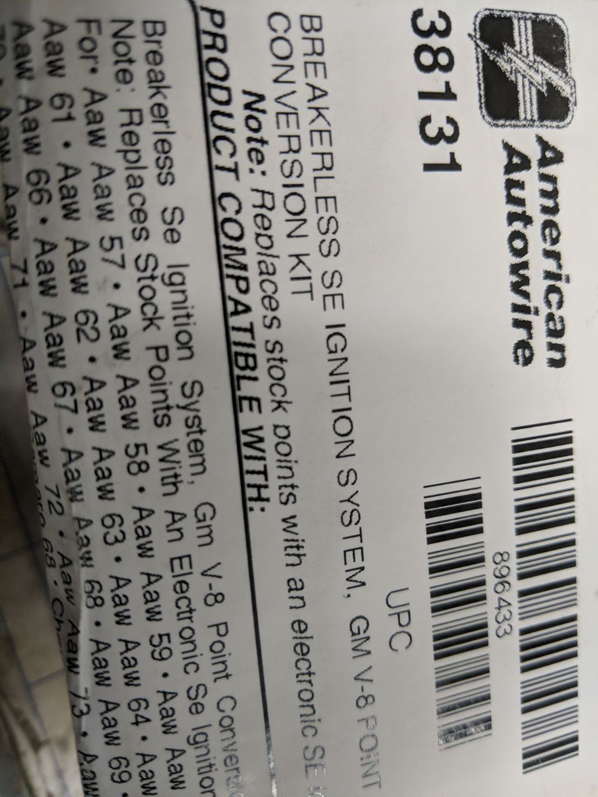

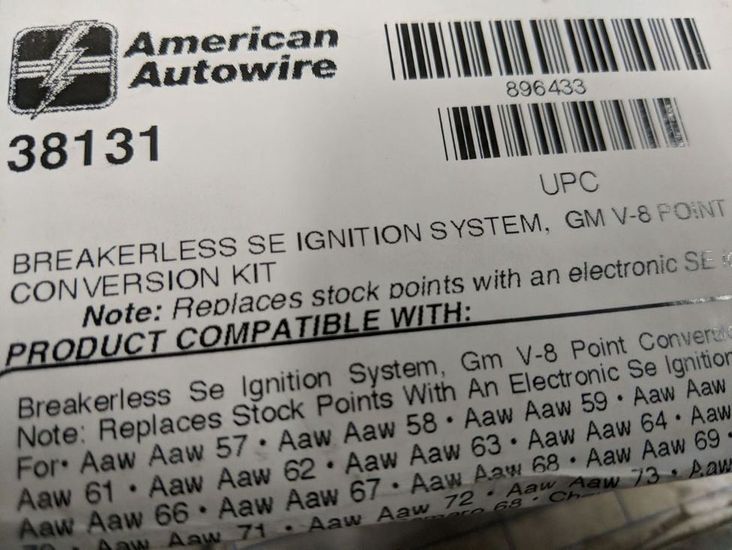

I currently have this unit in my ‘70 W-30 4-Speed. Right now the car will crank but will not turn over. I have no Spark to the #1 cylinder. Engine is 100% stock except for this conversion from points. I want to buy a replacement unit before I take the air cleaner assembly off to get to the distributor. It’s possible that the coil is bad - I do have a replacement one in case. But can anyone recommend a replacement breakerless ignition part ?

I have used those Hall Effect modules without ever having a problem. May be the coil is bad.

I've ran the Breakerless hall-effect style for 5 years now. Last year, I went to drive the car out of the garage, and it just died like the key turned off. No spark. I've had issues with coils, assumed that was the problem, throw a coil on, still no spark.
I assume it's the Breakerless, pull the distributor, change the Breakerless module, it started, put it into gear, rolled about 5 feet forward, and it just died. Now I'm pissed...
I used the original coil trigger wire, and it turns out the wire inside the distributor had rubbed a small spot through where GM crimped on the line stop and was grounding on the distributor housing. The Breakerless modules were fine.
So anyways, the Breakerless has been good to me.
