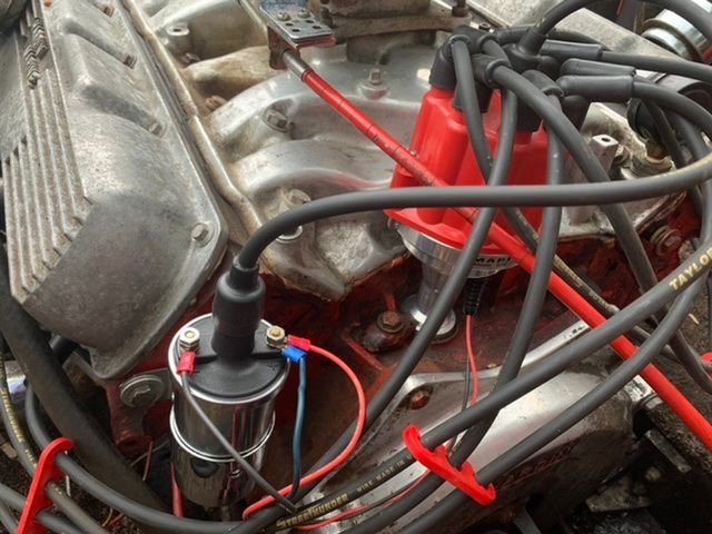

Im hoping someone can help with a Pertronix III distributor and coil I have in a jetboat. The engine ran with the old points distributor, however that old thing was on its last leg and had some problems. So I upgraded to the Pertronix III. After install and setting the initial timing, I never could get it to even hit. I took a volt meter and the coil it is getting 12v. After getting frustrated and letting it sit a couple days, I came back to it and it fired right up on the first try and ran fine. The next day I decided to set the timing with a light and it fired right up again. I had to shut the engine down for an unrelated issue for just a moment and tried to start it back up... nothing. I let it sit over night and still won’t even hit. I’ve attached a picture of how I have it wired, which is from the instructions included with the unit. I’m beginning to think the new distributor is bad. I’ve checked all cylinder compressions and I’m getting fuel. Anyone have any ideas before I call Pertronix?

Your link does not work. Do you have power to the coil+ in both start and run key positions? Run a temp. jumper direct from the battery+ to the coil+. Just remember in order to turn it off the jumper needs to be removed.

Eric's advice about hooking the distributor directly to 12V is spot on! Sometimes Pertronix units and HEI modules can fail internally. That's why I always keep a spare HEI module in my glove box. It's a bit pricey to do with Pertronix. It may be the biggest draw back of running their ignition system.

Thanks for the tips guys. She’s up and running now. After jumping the coil, the engine fired right up. After some more checking, I finally determined my key switch had gone bad. When turned into the start position, it would activate the starter but nothing else, including the coil. Thankfully NAPA had a new key switch in stock that works perfectly. The key switch was the last thing on my mind of things to check... lesson learned.

Glad its running, the starter feeds the coil when the engine is cranking.
