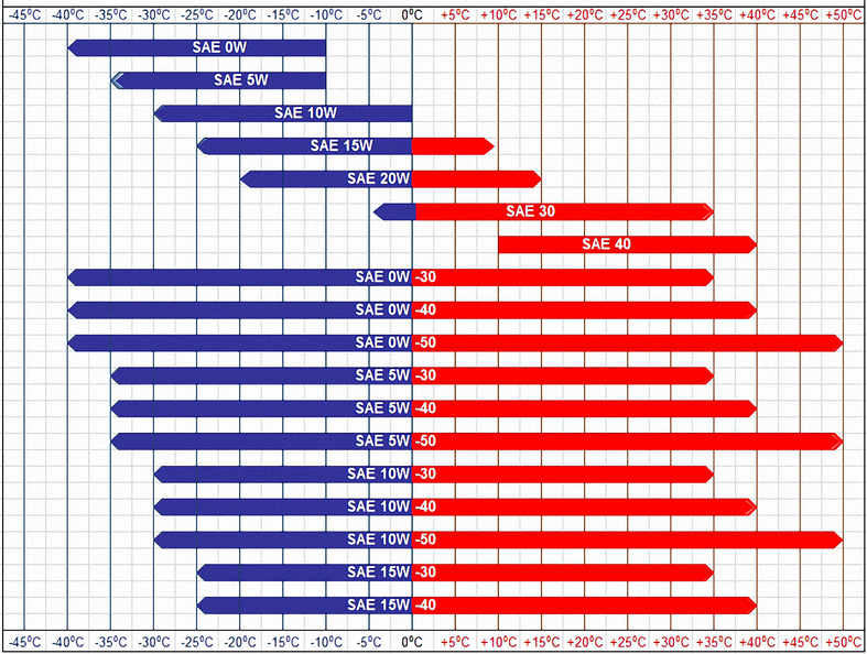

In my case, it's because I live in a hot environment. The engine oil charts show 10w-30 is good for up to 95ºF, and we are above that for 6 months every year, and during the peak of summer, it gets 20+ degrees higher than that.
So yeah, molasses for my engine.

Posts: 15,409
Joe,
All of the charts I found online are similar to the one below, showing 30w oils at max of 35ºC / 95ºF. I have no idea why this is different from the 1971 chart you posted.
https://www.motorstate.com/oilviscosity-htm/
