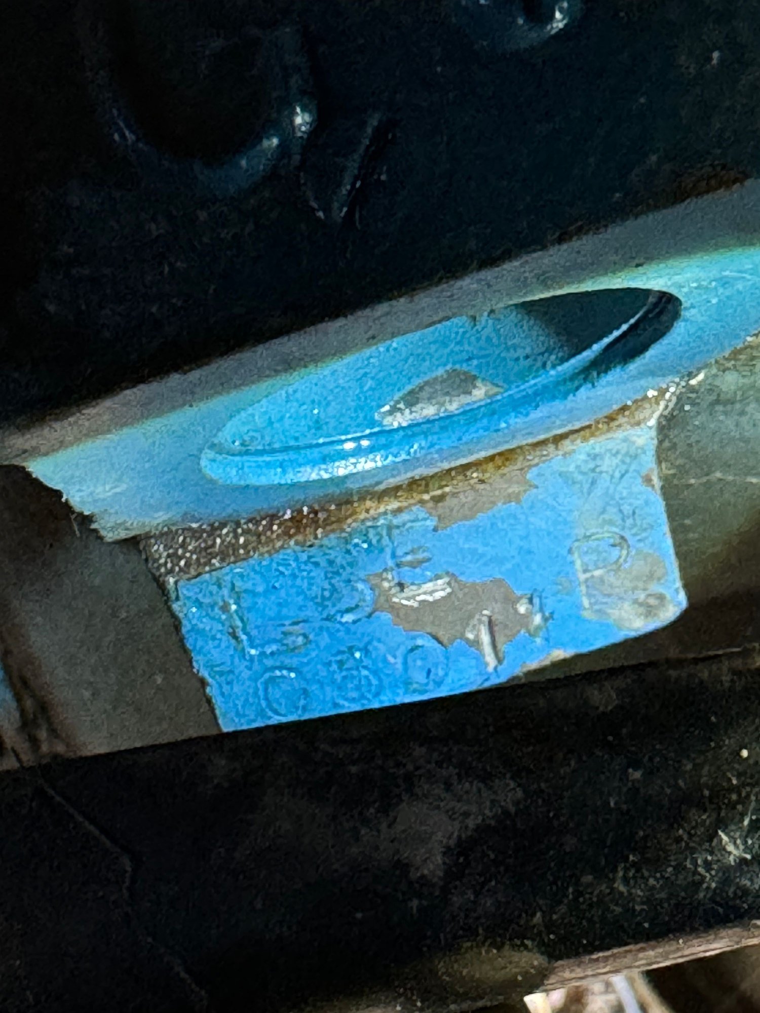

455 ID engine

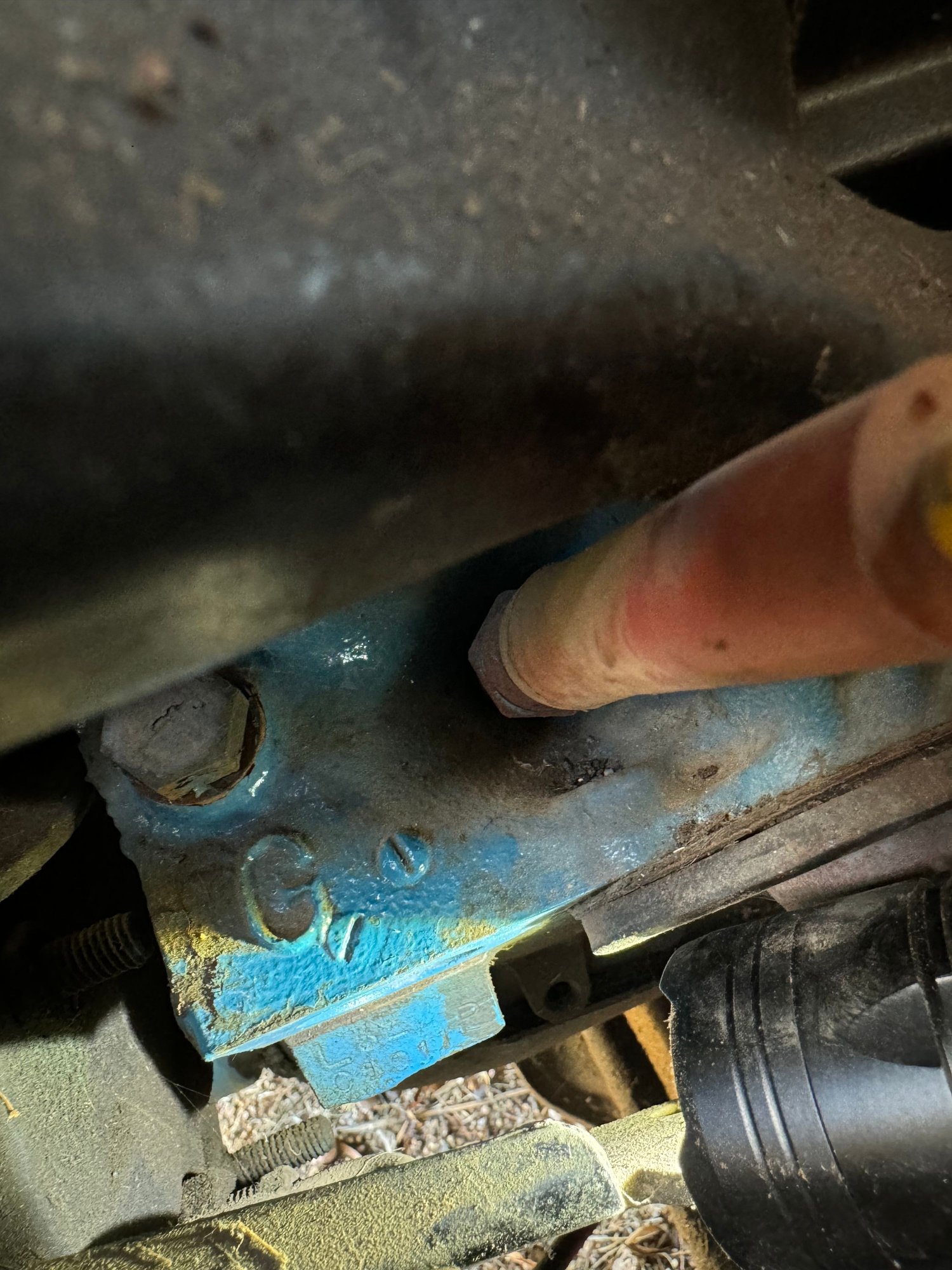

396021F block but what year? heads are 71
cannot read too well L S E?

Looks like a ‘73 service replacement block.

L equals Oldsmobile, but what makes it a 73 I didn’t read the whole article. Thanks. Much appreciated. I thought G was 1971.

Nothing says that the heads were born on that block.
