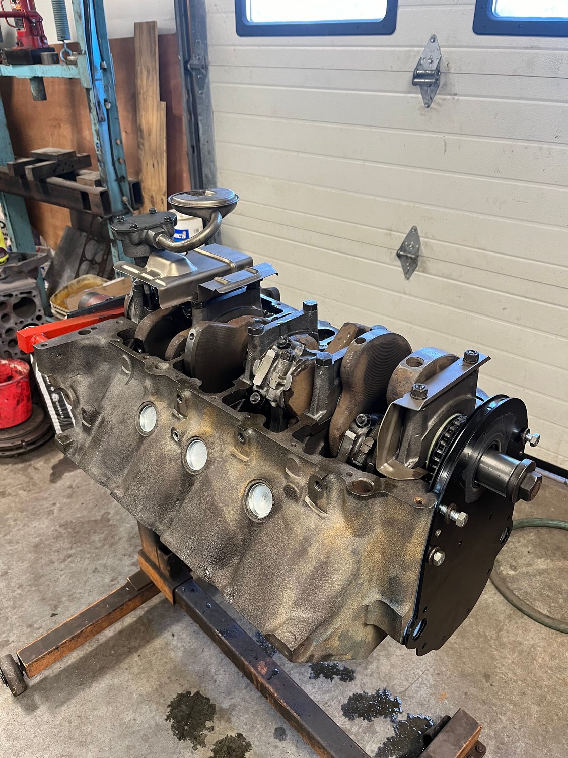

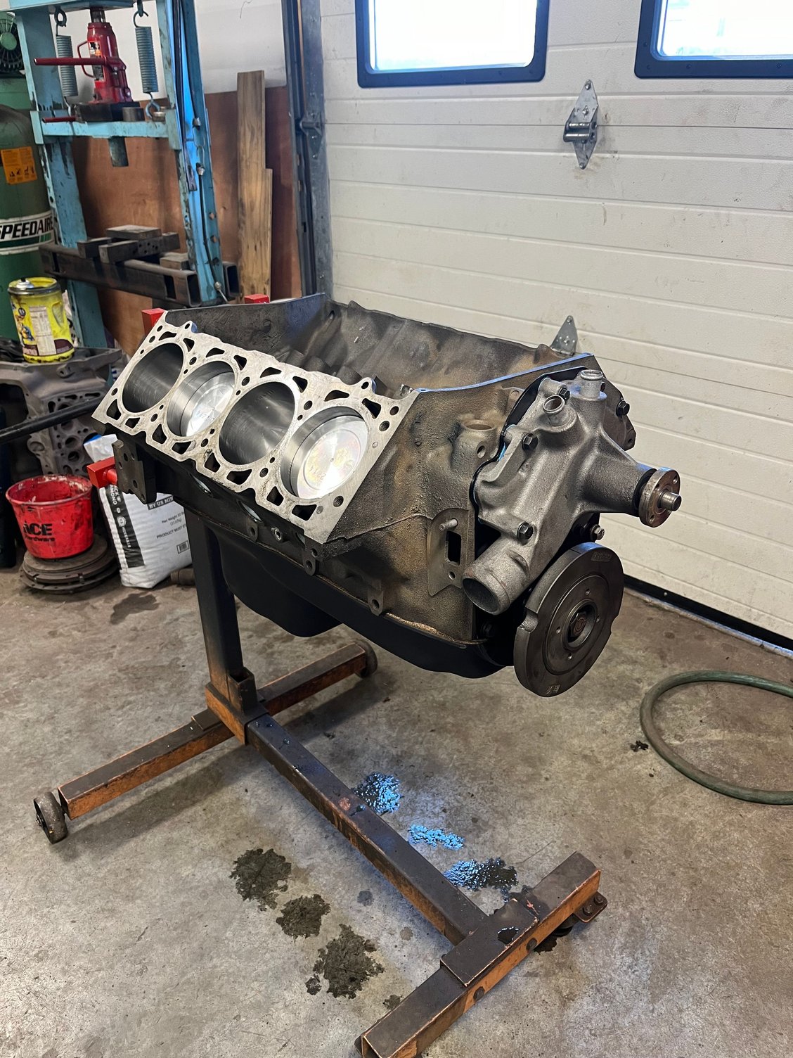

Engine progress
Bottom end set now on to the heads.

Give us some details , is that a 455 ?

Jetmek's Avatar
Joined: May 2023
Posts: 136
From: New york
66 425. I bored it 030 with egge hole fillers. 10/10 crank balanced assy. New m22 and camcrafters stock regrind on cam. Rod big ends specd in limits so no work needed on those. Working on the heads
