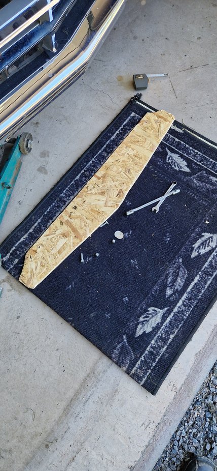

Made a ruff sample of board to fill the void , should make a better flap later just testing.

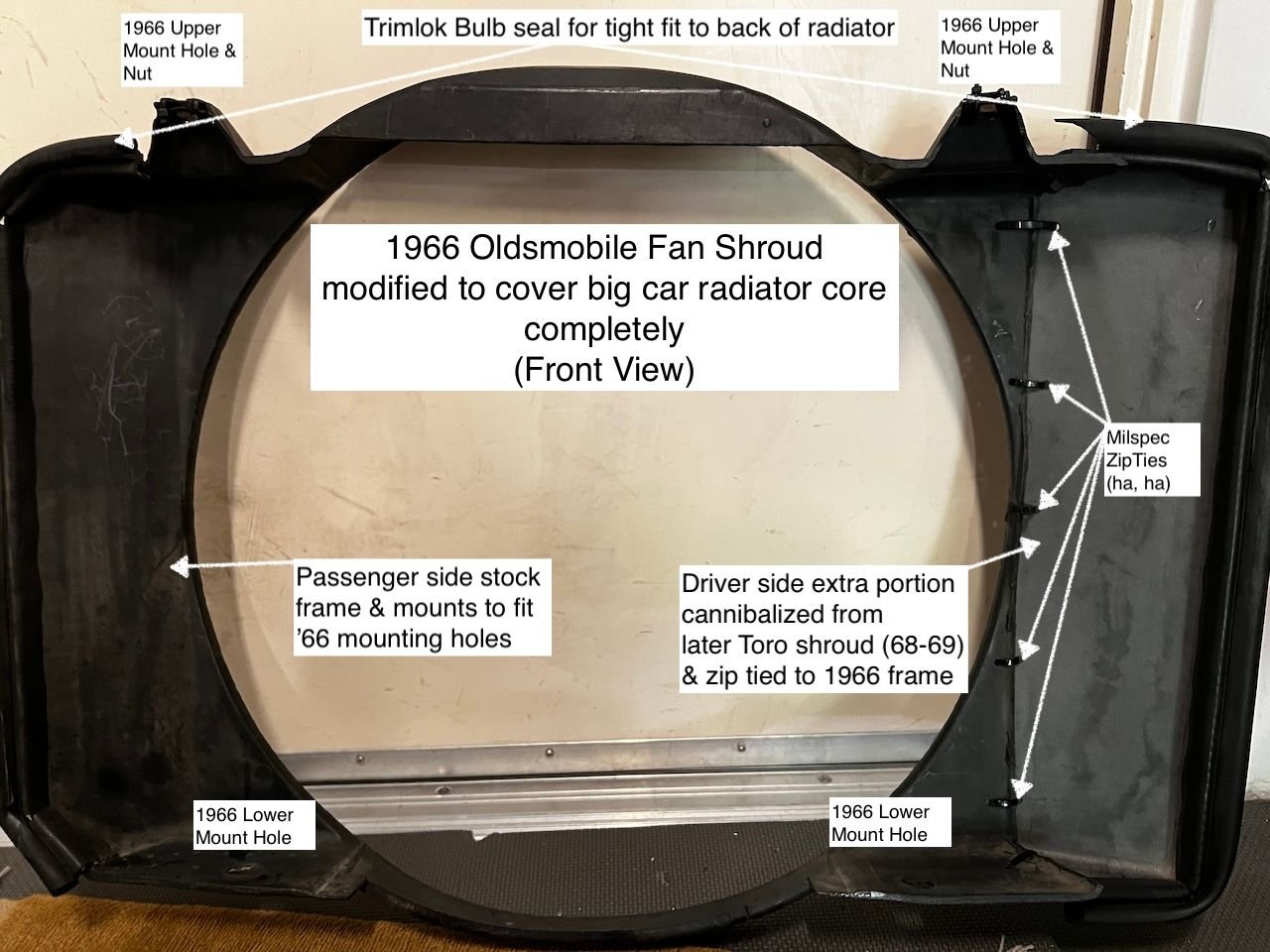

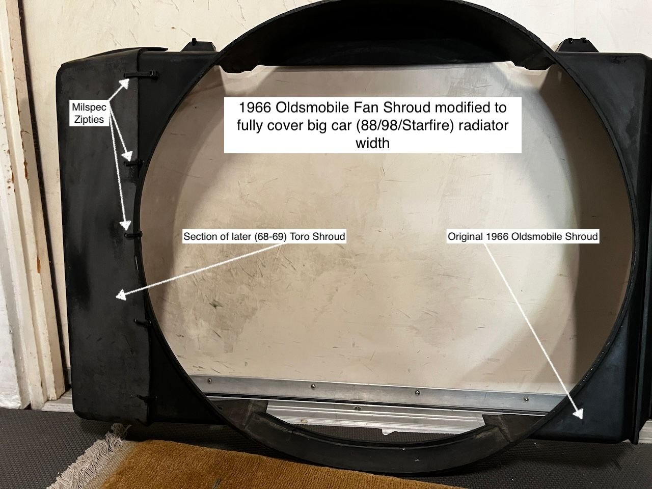

Long ago I was a disappointed that Olds didn't use 2 different size fan shrouds in 1966 since the big car radiators were wider than the A-bodies. If you're going to run a shroud, shouldn't it cover the whole rear of the radiator to keep things as cool as mechanically possible? To me, uh yeah. To Olds in 1966, not so much. Years ago I was trying to improve on what Olds did in 1966 for cooling since 1) there are more cars on my roads; 2) our ancient cars spend more time at low speed in traffic than they used to; 3) At least in my part of the world, temps are higher on average, or at least when I drive; 4) they're older and weren't designed for our lower quality, lower octane gasoline.
Anyway 8-10 years ago, I raided the boneyards & snagged a couple of late '60's Tornado fan shrouds. I gamely tried to just bolt 'em in, but their mounting points were different from my '66 big cars. So I fell back to I cannibalizing them for parts to fix/ augment / improve my own shrouds so that they covered the entire rear side of a '66 big car radiator. I don't believe I ever posted shots, please excuse me if I've forgotten.
Long winded way of saying, here you go with my modified 1966 Oldsmobile fan shrouds which cover the complete rear of my bigger-than-Cutlass radiators:
Front View (with classy zipties!)
Ziptie some extra width on your '66 big car shroud using later GM driver's side parts. Be sure to use milspec tiptoes (ha!)
Rear View
1966 Oldsmobile Fan Shroud modified to cover entire big car (88/98/Starfire) radiator width, which was wider than Cutlass/442.
Hope this helps some of you. I'd guess you could get a bunch of shrouds as candidates for surgery and fit the best you can. Key thing is that the shroud pulls air from across the entire radiator core, not just 60%...
Cheers
Chris
