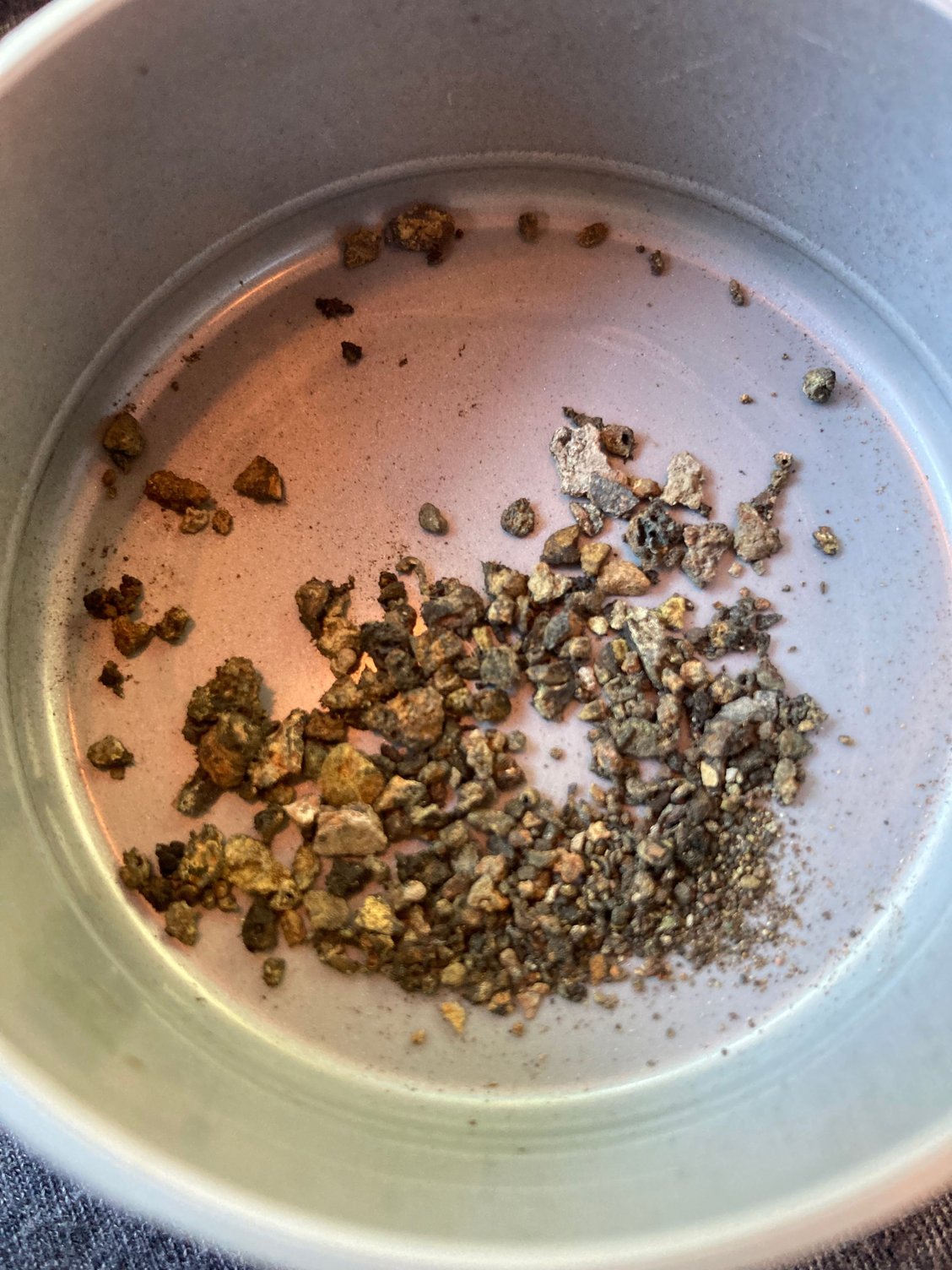

I also read that when draining the system, two plugs on either side of the block should be drained as well as the petcock on the rad. Could there be a lot of buildup that hasnt been drained from the system? The car was sitting in a garage from the mid 90's until 2010, when I took it under my possession. I did see clear water running out when i removed the thermostat, undid the hoses from the rad, and flushed water into the top hose until it came out the bottom end of the water pump outlet. where the lower rad connects to.
Old Jun 22, 2022 | 09:38 PM
Sugar Bear's Avatar
Posts: 4,098
Yes there could be build up but it usually isn't that bad. If you are running the car and the system is staying clean then it likely isn't a plugged up block. Attempt to remove the plugs if you can access them but keep the force applied to a reasonable level. If they are seized don't break them off to later find there wasn't a problem.

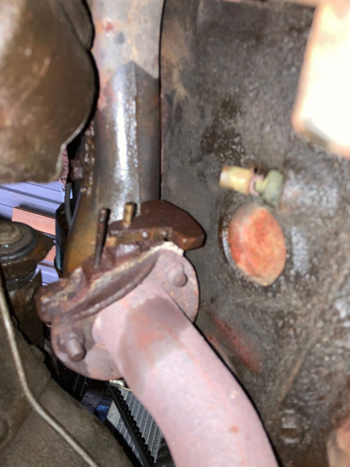

Alright guys, so here's the latest:
I did check the heat rise valve on the driver's side exhaust manifold; it was STUCK. Attached is a pic of the position I was able to move it (with a dead blow hammer handle, and a smaller hammer hitting the dead blow on the counterweight of the valve). Does anyone know if the position in the picture is open or closed? Whichever it is, it has moved to the postion pictured, and has been stuck opposite for god knows how many years.
Used a temp gun on the engine. I was getting readings of 230 from my temp gauge and it was damn close on the engine; radiator measured 218 degrees at the middle, that was the highest.
Upper rad hose read 220-221
Lower hose 209
Should there be different temps on the intake manifold? A jump of 254 degrees to 280 in an area. Is that common?
Looking at the heat riser valve. No coil there I took it off for now, part had broken off anyway

That weight should be hanging straight down when the valve is wide open.
Try to move it some more.
If you can't move it anymore, then as suggested, remove the flap valve inside of it.
The heat riser isn't needed on a car that doesn't operate in freezing weather.

The heat raiser valve operation is essential to proper engine operation. Oldsmobile factory engineers incorporated the heat raiser into its engines for several reasons. If it wasn't needed it wouldn't have been installed. It warms the intake manifold to prevent carburetor icing in cooler temps. It keeps the atomized fuel/air mixture in suspension to prevent puddling in the intake manifold. Improper operation or elimination of the heat raiser valve will (if stuck open or removed) cause poor engine operation when cold, and cause poor fuel economy. (If stuck closed) may cause fuel boil over, may contribute to higher engine temps.
You have found a defective part. Repair or replace it as needed. JMTC.

Have you resolved the heat riser issue?
Old Jun 28, 2022 | 08:07 AM
Posts: 42,475
You don't need the heat riser, many of us have cut stuck flappers out over the years with no adverse effects to engine operation. Yes, engine timing is critical to engine performance and operating temps.
Old Jun 28, 2022 | 10:45 AM
sysmg's Avatar
Joined: Sep 2010
Posts: 472
His was jammed closed. So he has an issue that needs to be resolved. Either remove it, open it permanently or fix it.

Heat riser is open; stuck open, but not closed anymore. It was so hard to move. Had to hammer it with a wooden rod.

Funny you say that….I am going to post pics of residue and particles (attracted to my magnet) that present themselves in the top of the rad after driving and letting the car sit overnight.
small crumb, rocky, jagged looking, mixed with rustiness.
I have not hit the tune up yet. I need to get a timing light yet.
The heat riser is a plate mounted to a rod, that goes outside of the manifold. It is possible that you "opened" the outer arm, and the plate inside is still frozen closed. If you're still having problems, investigate this.

I was able to move the counter weight in the position that someone here told me to move it so that the valve would be open. Maybe it’s just spun without actually moving the valve?

Here are the small particles
Here is a picture of the particles are found in the top of the radiator overnight after has been completely cooled I tracked them to a magnet it happens every time I drive it and let it sit overnight.

Posts: 16,688
That's pretty funky.
