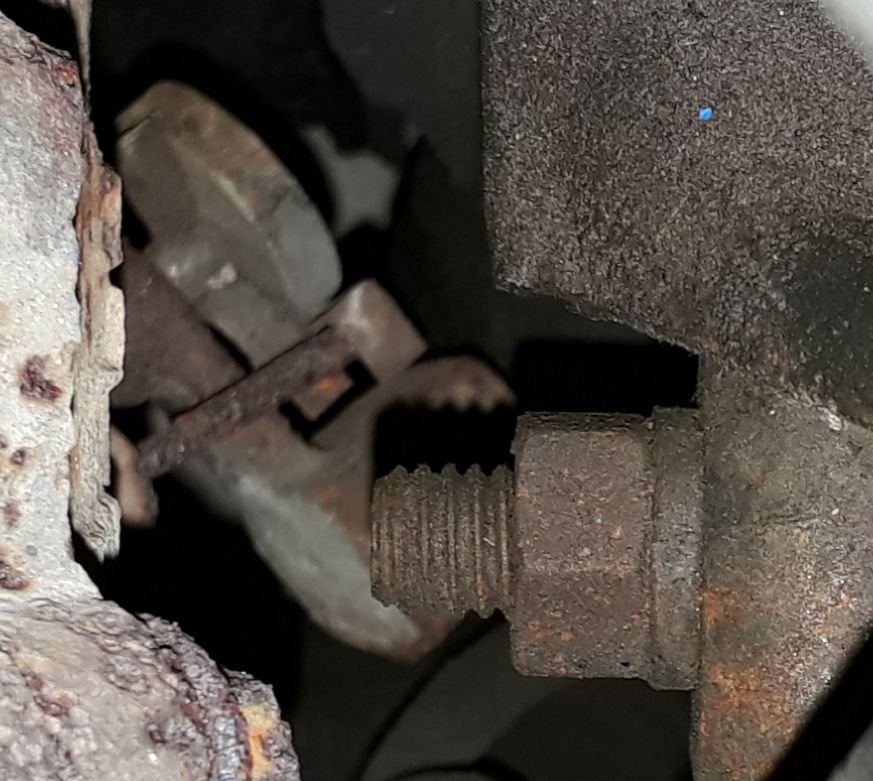

Could the exhaust manifold valve got stuck and causing this issue our last ride. Send a pic of it. Can move
it but the whole thing feels very sticky and wobbly. Have checked the Olds manual but is hard to se how it should
look when fully open. Checked my 88 also but there was no valve or maybe it have been removed earlier.

i was under the car this morning and unhook the bimetal spring
and secure the weight with a wire. Would like to remove shaft and valve but donīt take the chance of breaking
any bolt now when we have fun with the car. Better to check this in winter when car is parked.

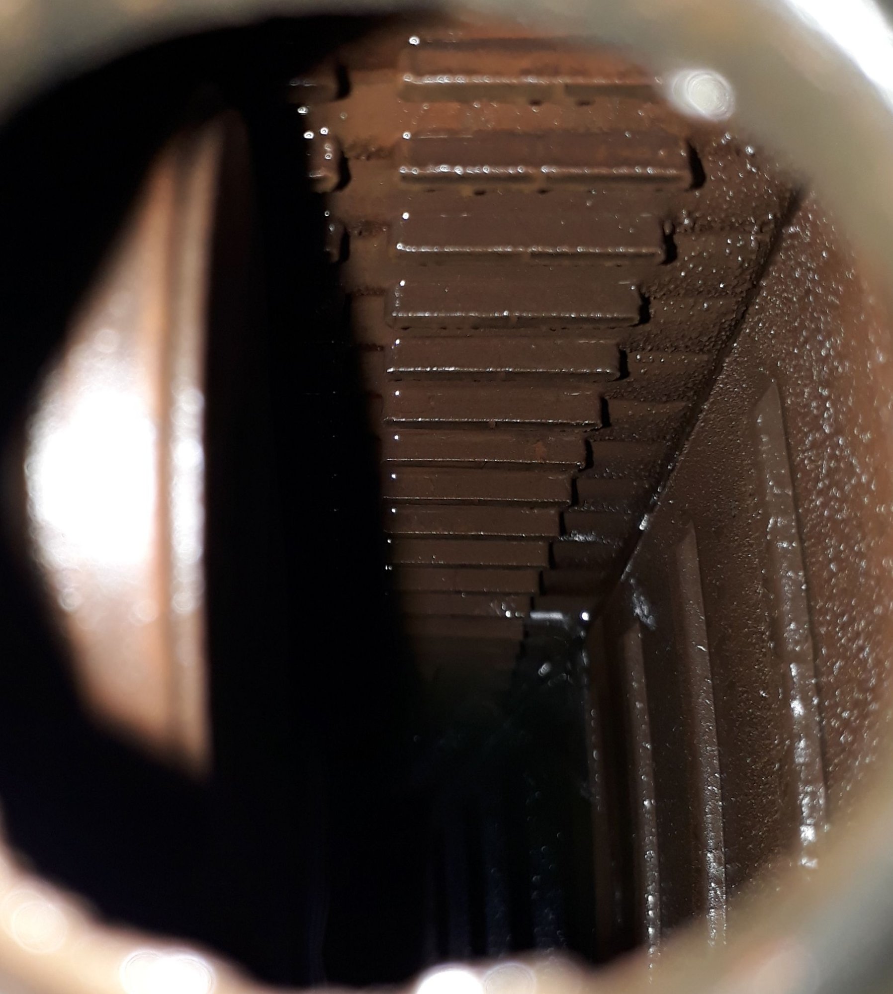

But i don't like the colour inside the radiator :

The cooling system needs to be cleaned, CRC ThermoCure works well. My suggestion is to clean the cooling system, replace the thermostat with another 180°, test or replace the radiator cap, replace the coolant and consider adding RedLine WaterWetter and see what happens. The flaps around the sides of the radiator are important to help the air pulled by the fan to go through the radiator core, no flaps allows more air to get pulled around the radiator.

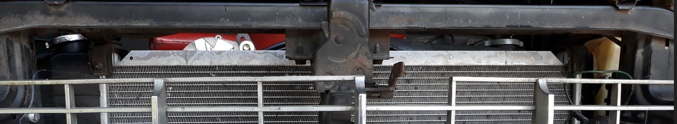

Should mount flaps around the radiator , testing this 3mm clear polycarbonate .

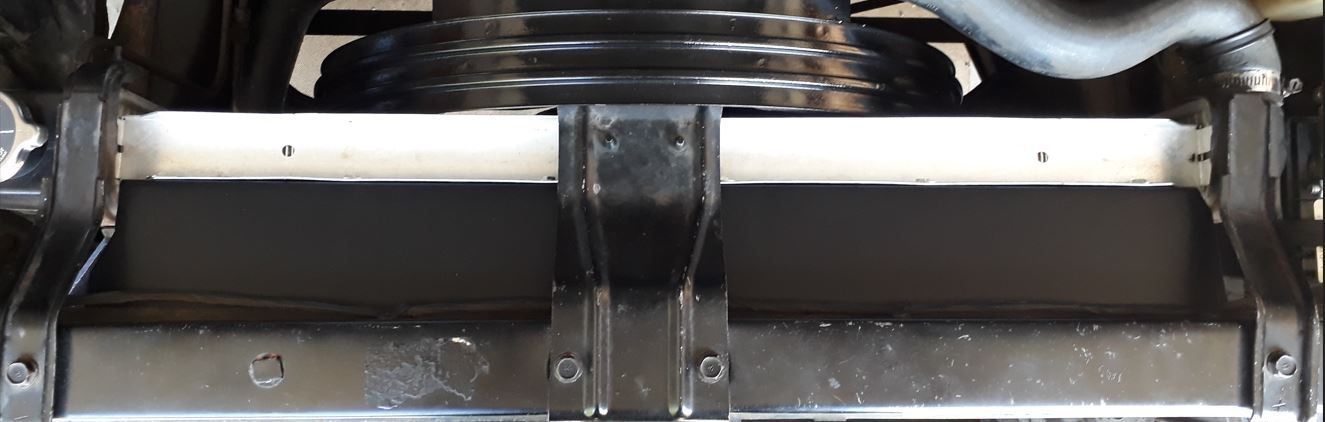

Finally the rain stops for a while and i have use some alu sheet metal to cover the gap on top of the
radiator , drain the cooling system and i have never seen such cooling fluid in any vehicle before .
Have filled the cooling system with Therma cure now and should drive a couple of days before flushing
the system a lot.

After 30 us miles the radiator looks better , should drive the car a couple of days before i flush the system. But no signs of overheating or coolingfluid under the rad . Have not replaced the stat yet.

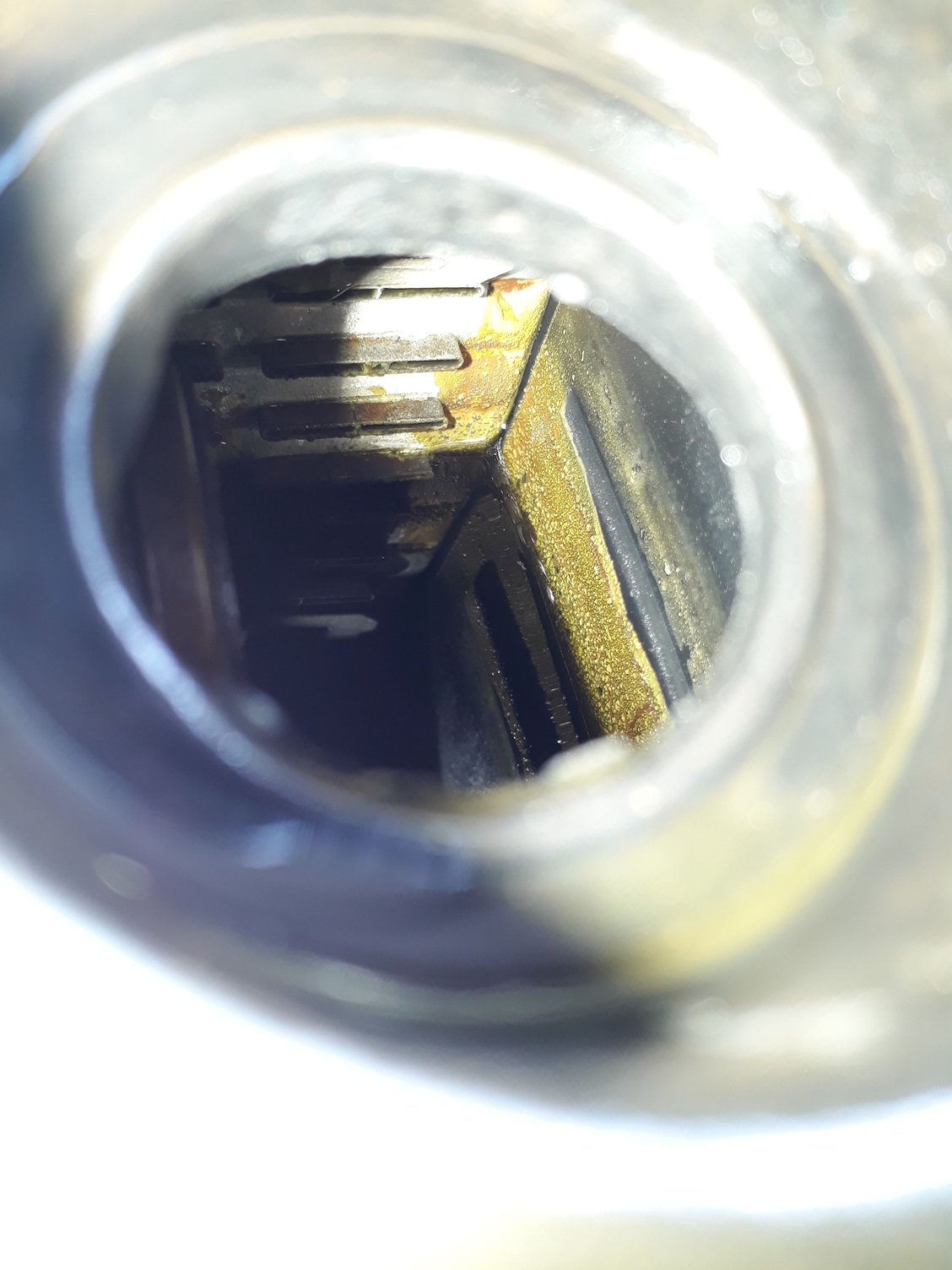

Yesterday i flush the cooling system after i had the Thermocure in it for 3 days.
Before the Thermocure :
After one day driving about 30 us miles :
And after 3 days the radiator look like this hard to say miles but around 75 maybe. Alu radiator with plastic
tanks , half full with water :
A lot of black "water" came out of the system :
Here a pic of particles coming out , replaced the heater core hoses at the same time and there was also
particles in the hose from heatercore to waterpump :
Should do one more flush in a couple of weeks before adding antifreeze , and also think if i should keep the
180F stat or replace it with a new or maybe a 160F.

This pic is from the radiator in the car when it came from US in 2018 , i replaced the radiator to a new.
I,m not sure how to test a radiator cap , feeling the spring and rubber surface ?

Today i flushed the cooling system again after i had water in system and a light grey fluid came out. Not
so many particles this time. Flushed radiator , engine and heater core untill clean water came out.
Refilled with water again and should drive a little before i flush again and adding antifreeze .
Should have these engine block bolts in mind
Sugar bear , when i could check this.

Big improvement, nice work. Perhaps a CO member would post a picture of the drain plug and its location.

Thanks maybe this bolt to the right of the exhaust pipe ? Looked in the Olds manual that says a bolt in both sides of the block.
Old Aug 5, 2023 | 08:21 AM
  #34
Sugar Bear's Avatar
Posts: 4,098
Yes the 9/16" hex head brass??? plug. Be cautious with the force applied, use a 6 sided socket or wrench. If it won't loosen, stop.

Thanks for tip both of you flushed the cooling system again today after driving yesterday and the
fluid that came out is much more clear now than last time so i should do this a couple times more.
Had the car idling for a while and i could feel the radiators left and right side is much hotter than the
area where the fans operate and could also feel the suction thru the rad so i,m glad a CO member
sold me an shroud
Maybe itīs better to try remove this bolts when the car is parked for winther , it must be an real nightmare
to break one of those in the block but all tip should be rememered.

If it is draining clear and running cool the drain plugs can wait. If you think you may pull them at some point, soak them several times with penetrating oil (ATF and acetone as suggested.
Old Aug 6, 2023 | 05:40 AM
  #38
olds 307 and 403's Avatar
Out of Line, Everytime😉
Posts: 10,082
From: Melville, Saskatchewan
Now I see it. As said, heat and I use a very long flex head 3/8" ratchet with a shallow 14mm or 9/16" socket. They can be pretty tight.
Based on the work you've done & the results so far to date, I would enjoy the car the remainder of the summer & if it's necessary to remove the bolt(s) I would tackle that job in the winter.
Regarding removal of any seized bolt(s), after soaking in penetrating oil: (1) have ready a long piece of pipe/tubing/breaker bar to gain as much leverage as possible to free the bolt(s) - length is your friend in gaining leverage & force/coercion/strength; and, (2) don't be afraid to apply a little clockwise force to the bolt(s) to free it up - not a lot, just enough so you might get the rust to break free under the bolt head and first several threads. Be judicious.
