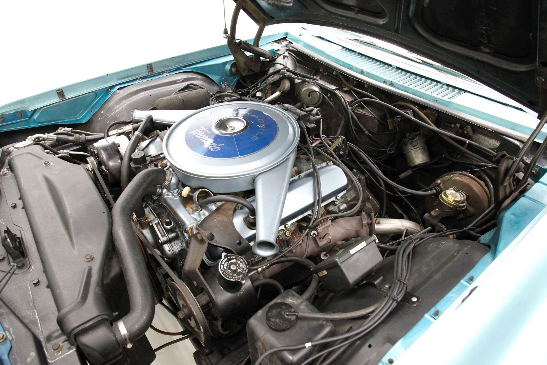

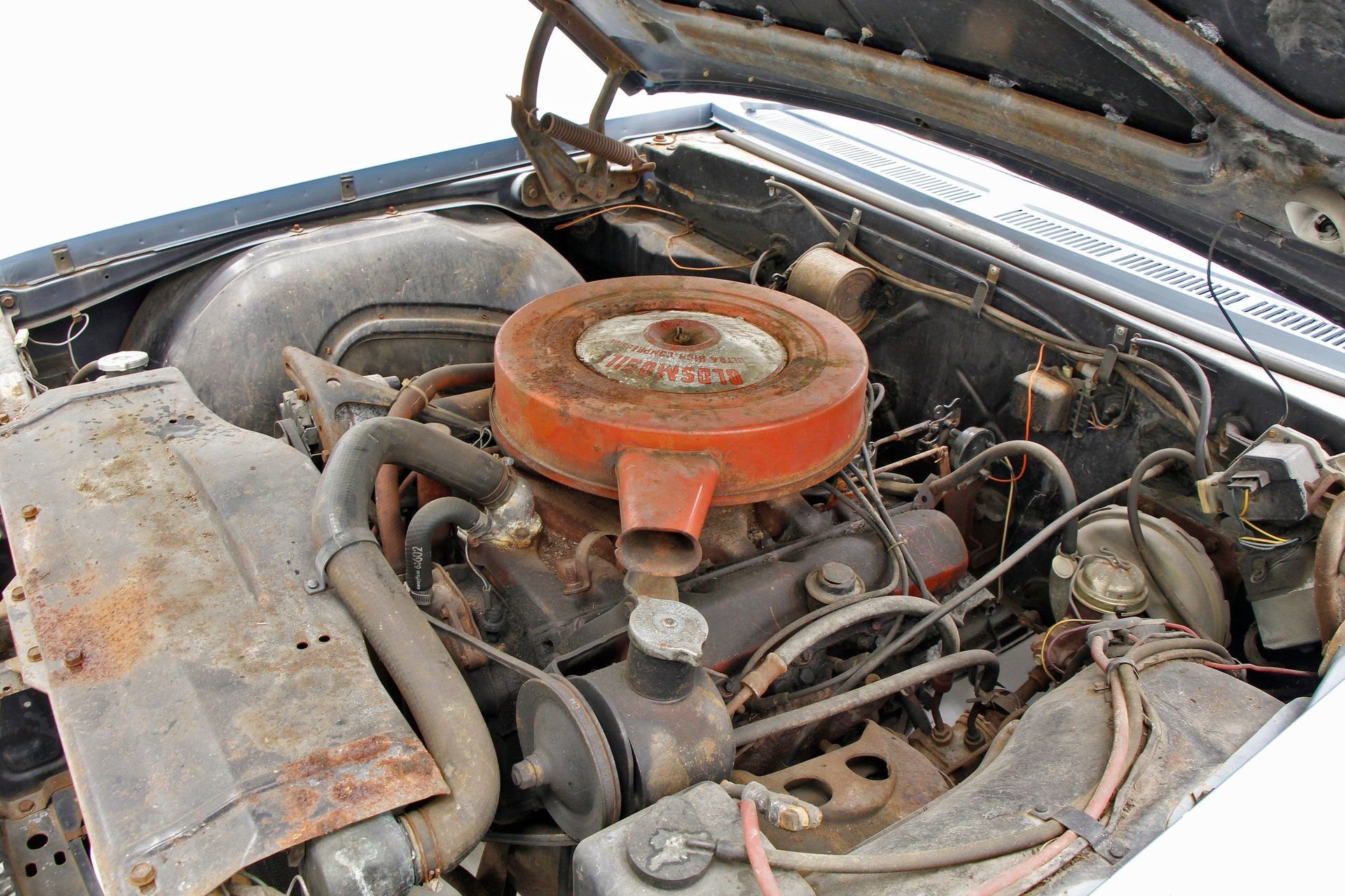

Posts: 50,802
The Toros had issues due to their aggressive styling and the fwd, so the manifolds and oil pan are different. Bracketry did not change.
Wanna bet? 1966 Toro vs 1966 Delta 88. Note that the Toro PS pump bracket is different and the pump is further outboard and lower to clear the hood. The Toro had room to move the pump because the engine was offset to the passenger side. By the way, the Toro exhaust manifolds are different to clear the transmission.
Old Feb 24, 2025 | 08:59 PM
Posts: 50,802
And before someone points out that the Toro in my photos above has A/C but the Delta does not, here's a 1966 Delta WITH A/C. The alternator isn't even on the same side of the car.
