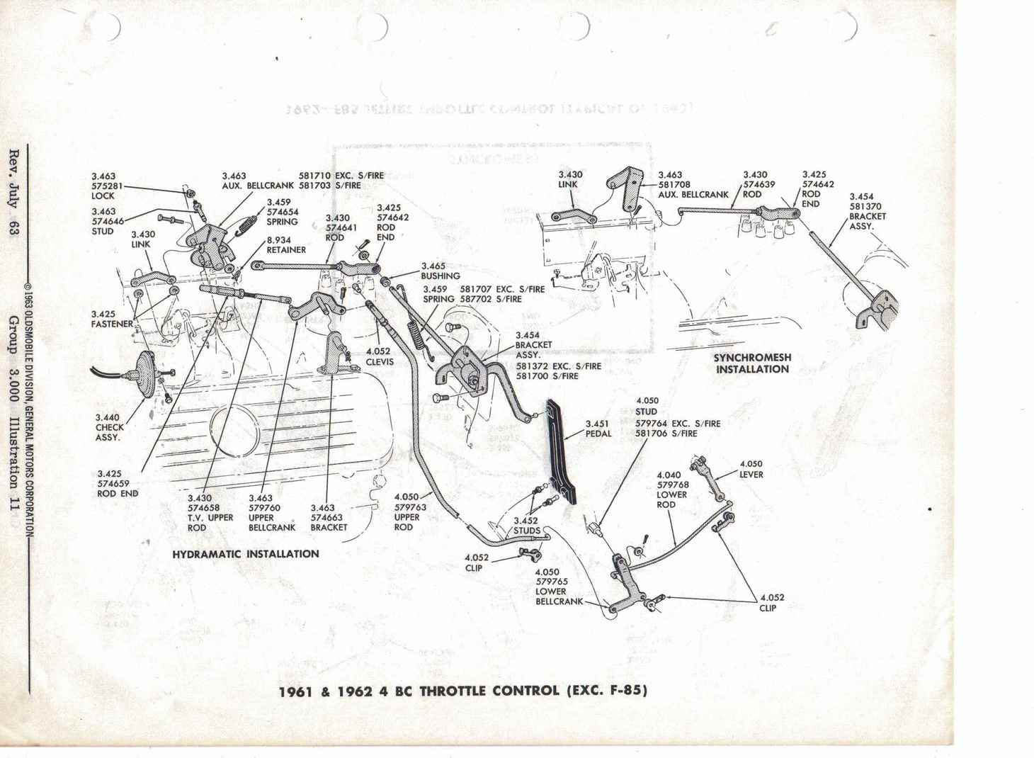

If you don't already have one, an Oldsmobile shop manual is a very good investment.
These are the books Olds mechanics used at the dealership.
In 1962 Olds published a supplement to their 1961 Shop Manual.
You will need both books if you have a '62.
Among the many other things you will find in the shop manual, are instructions on how to adjust the transmission throttle linkage.

There may not be anything wrong with that transmission. It is what they called a "Slim-Jim." They are a different animal. People tend to say unkind things about them. Damper plate bolted to the flywheel like a manual transmission. No external torque converter - it has a fluid coupling (that fills and empties) inside the trans behind the front pump. It will not shift like Turbo HydraMatic. Adjustment and fluid level are important.
Old Apr 23, 2024 | 08:11 AM
Mikeyt's Avatar
Mikeyt
Joined: Apr 2024
Posts: 356
From: NC
It just shifts way too early no matter how much throttle you give it.
Old Apr 23, 2024 | 01:11 PM
Charlie Jones's Avatar
Phantom Phixer
Posts: 5,522
From: Apopka, FL
Make sure the linkage between the carb and the transmission is connected properly.
Will do.
Thanks again Charlie
