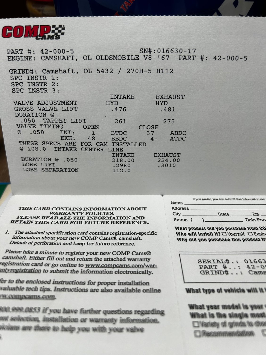

I know this is a really old thread, but you wouldn’t happen to remember what cam you used would you? I’m doing the same thing. I have a bone stock 76 455 with massive dished pistons and just want to see what I can do to help it as cheaply as possible and put it in a 87 cutlass. I already have a performer intake and w30 manifolds for it. Thanks

The cam for this car was sold to me by Dick Miller. The invoice stated special grind from comp cams .cam card says ol 5432/270h-5 h112 . I'll try to get a pic of the card and post it

  #62
deadeyejedi's Avatar
Joined: Sep 2012
Posts: 1,968
From: saratoga springs,n.y
I gave Dick all the specs from my car and he cam up with this cam.

thank you for the reply, unless I missed it reading the thread, you kept the deep dish 76 pistons in the motor, correct?

Yes the factory deep dish pistons it has dual exhaust turbo 400 trans and 256 rear gears . We redid a set of e- heads and put and edelbrock performer on it . The car is not a beast off the line by no means but will cruise at 80 all day long .It still does have the umph to lay down a posi though . Good luck with your motor 👍
