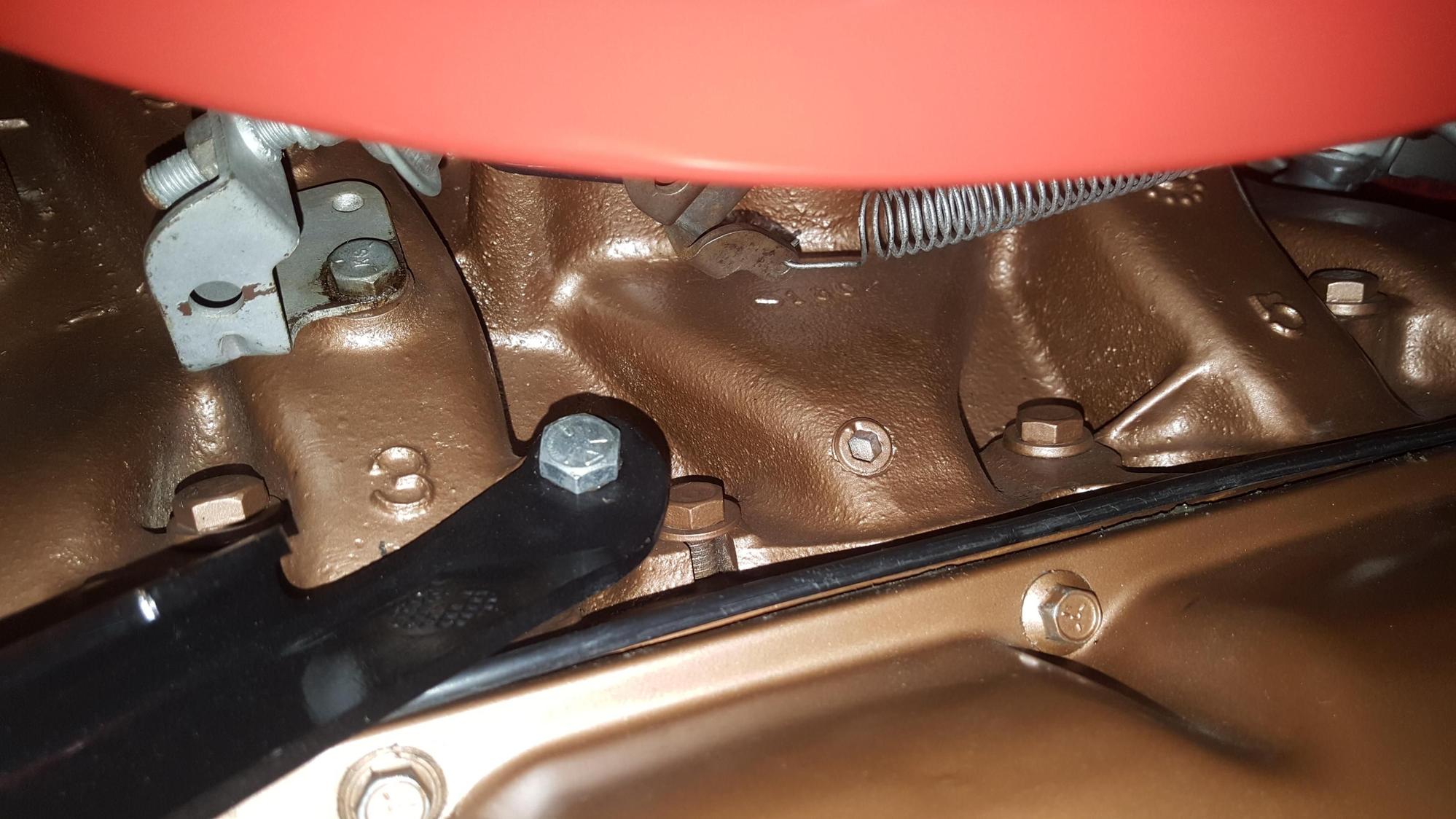

Block off the crossover in the intake, not the heads. Easier to do, (weld in the iron plugs), and easier to machine out if it ever needs to be reversed. Dont fear the Olds iron intake. Thou its not light.
20 years on this intake paint.
