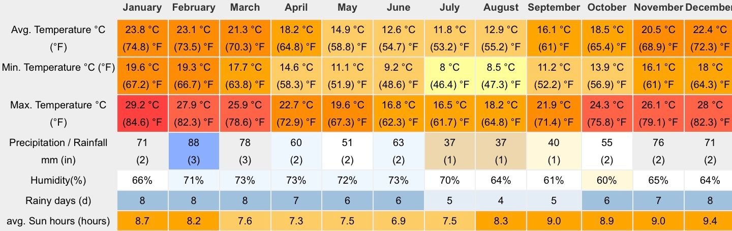

Thought I would continue this thread instead of creating another of similar.
Time to dump the run-in oil and go to regular.
Pretty much a new engine. Fully reconditioned. Bored 30 thou. Pistons to take unleaded/LPG.
Should I stick to what is suggested in the manual or I can you suggest what to go for re our local temps.
The last few years November December January have hit 104 plus, but I don’t drive in those conditions usually. 90-95 is about the limit when I drive the Oldsmobile.
I have added a graph for my local temps.
it’s a lot colder at times in the U.S than Australia.
Thank you.

Old Oct 1, 2024 | 05:38 AM
Posts: 42,475
10w30 should be fine in your part of the world.
Old Oct 1, 2024 | 09:29 AM
Posts: 16,688
Agreed, X2. That's a pretty temperate climate for Australia so I think 10W-30 should be fine.

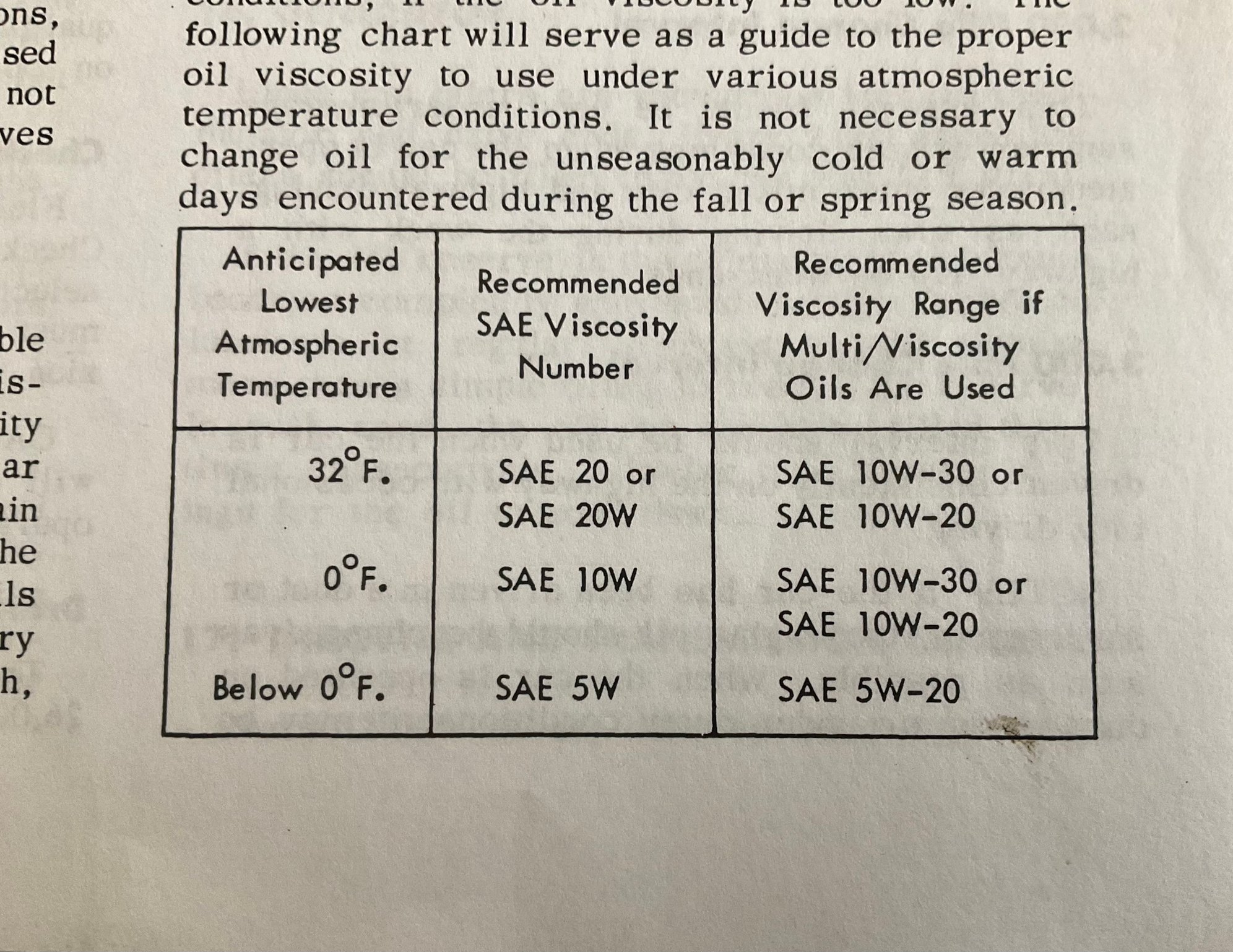

Old Oct 1, 2024 | 04:48 PM
5998DownUnder's Avatar
Joined: May 2010
Posts: 557
From: Australia
Sorry the pic so big.
That is from the manual. We don’t have the cold temps here as you guys do so unsure if it needs to be adjusted to suit this temp.
