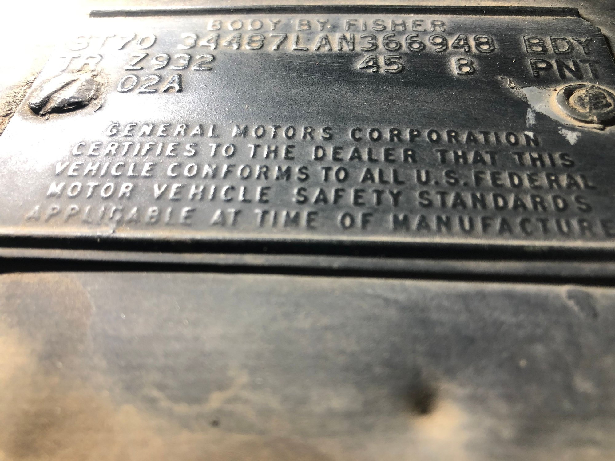

Ok so I think I have most of this decoded. The only thing is Trim Z932? I assume the 32 is green, the 9 stands for bucket seats. The Z?? Console?

When you figure out the Z you will make mankind happy.

Z indicates Canadian.

Cannot be Canadian since the car was shipped to Perryton Texas.

No W-30's ever built in Canada,all were built in Lansing. That code hasn't been verified all across the GM brands.

Yeah that is what I was just reading about. No clear cut answer it seems. Thanks for the responses.David

Z should indicate something like special order override, but, OP's car, along with many others, have been perfectly standard. He has a 45 green car, green interior is an accepted choice, black stripes, black vinyl, all of these are standard. The only thing non-standard is the aftermarket stuff, which has nothing to do with Lansing.

The Z code has been talked and debated for years. All GM brands have this code it seems but it hasn't been found out yet.

Indeed. I also read your previous comment saying the same. I think the reason it hasn't been figured out is that peoples' thinking is not including manufacturing. Considering that it is clearly
something for the trim package, and it's simply a modifier of the trim package to be "special," I don't think it has anything to do with the car itself. This would make anyone trying to link it to Canada,
chrome bead around the dash, headrests, or colors.
I have two theories.
A: They're customer order cars. No rhyme or reason to any options triggering the Z, other than someone ordered this one, and that one was just generated to go on a dealer lot. Proving this is difficult
due to Lansing's tossing the real build sheets, and the broadcast card doesn't say special order anywhere (to my knowledge). This can be proven by finding Z cars with customer order sheets, and non-Z cars
without them.
B: They were hot pick cars. I don't know how much people know about automotive manufacturing, but, parts of the plant are in sequence, and others are in buffer. This is the same for any car plant, new, old, GM, Ford, Toyota,
whatever. In Stamping, you are in buffer. You are not building the hood for the first car out the door, then the hood for the second, and all you do is make hoods. What you actually do is stamp hood outers for a while to fill up
your buffer stock, then hood inners, then the decklid outer, then the right door skin, etc, etc. You are filling buffer stocks. Weld shop is the same way. You assign a body number (more on that in a bit), but you are building to a
buffer. For us, that means so many of each body type intermediate and full size Oldsmobiles, whatever Lansing and Fishers cars were. Same thing with paint, but now they are painted cars. But, all paint shops have huge
buffer lanes where all the red ones are, all the green ones are, etc.
I'm going to make a fine point here. I don't know where in Lansing or Fisher the cowl tag was stamped and attached. Now, I'm a Toyota engineer, but, not only that, I work in Final Assembly, and, not only that, but I have replaced
the machines that print the Certification Label (which is the modern day cowl tag) on Toyotas at my plant. I could talk you through brand and model of the printer, who makes the paper, and what all the data are. There are
even Highlanders going to some parts of Europe that have labels I made myself (to a design). The reason I say that is we have two things on our CR label that an Olds does not, and that is VIN and Sequence Number and other stuff
that is not germane to this conversation.
This is important for a reason. My machines for the CR labels are Trim 1, Process 1. Literally the first guy on the left side of the line, in the Assembly shop. This is done legally. As soon as the cars are in Sequence Order, they get a
Sequence Number which means NOTHING to the customer. It's just 000-999 and roll over that lets you find cars in the shop. "What's the pilot cars today?" "436, 437, and 438 and they just left Trim 1." for example. However, the VIN
is legal. It has a serial number on it that is part of the production order going out the door, and is used for recalls. So, Toyota can't put that sticker on until we know the order, and we know which car that one will be when we pick it out of the
paint buffer and send it to lift to Assembly. At that point, it is in order, and we can extrapolate that that shell body has that VIN now.
But, Olds didn't do that. The cowl tag has no sequence number or vin. It only has body number, and cars, while they do GENERALLY follow body number, they don't HAVE to. All those cowl tags are black, and they have black seam
sealer on them. I don't think there's paint underneath them. I think they got put on back in weld, back when the car was optioned a certain way, and everyone knew what it was going to get, but not necessarily when, because it had to
go through the weld buffer and the paint selectivity buffer to get picked in order to get lifted to Fisher Assembly.)
My second theory is that a Z car was a car ordered to be produced more quickly than standard, for some reason, and it got to skip the buffers in between the shops, and that letter told Fisher to skip the lines and send it to Assembly faster
than normal. If anyone cares, it typically takes, on a 1 minute cycle time, about 8 shifts to get from the back shops to the front door, but I think it sits for a while. Typically, it's two shifts a shop, but I bet they could get them out a day sooner
if they had to by skipping the queue.
Enough of a novel, you get the point.

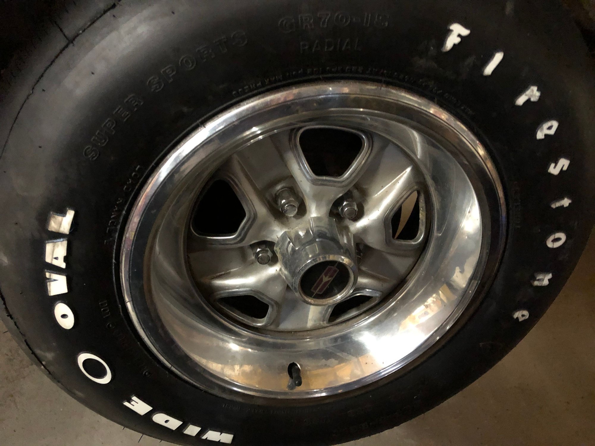

The car has 15 inch wheels added maybe as far back as 70’s I assume. Hard to say when. New Coker tires.

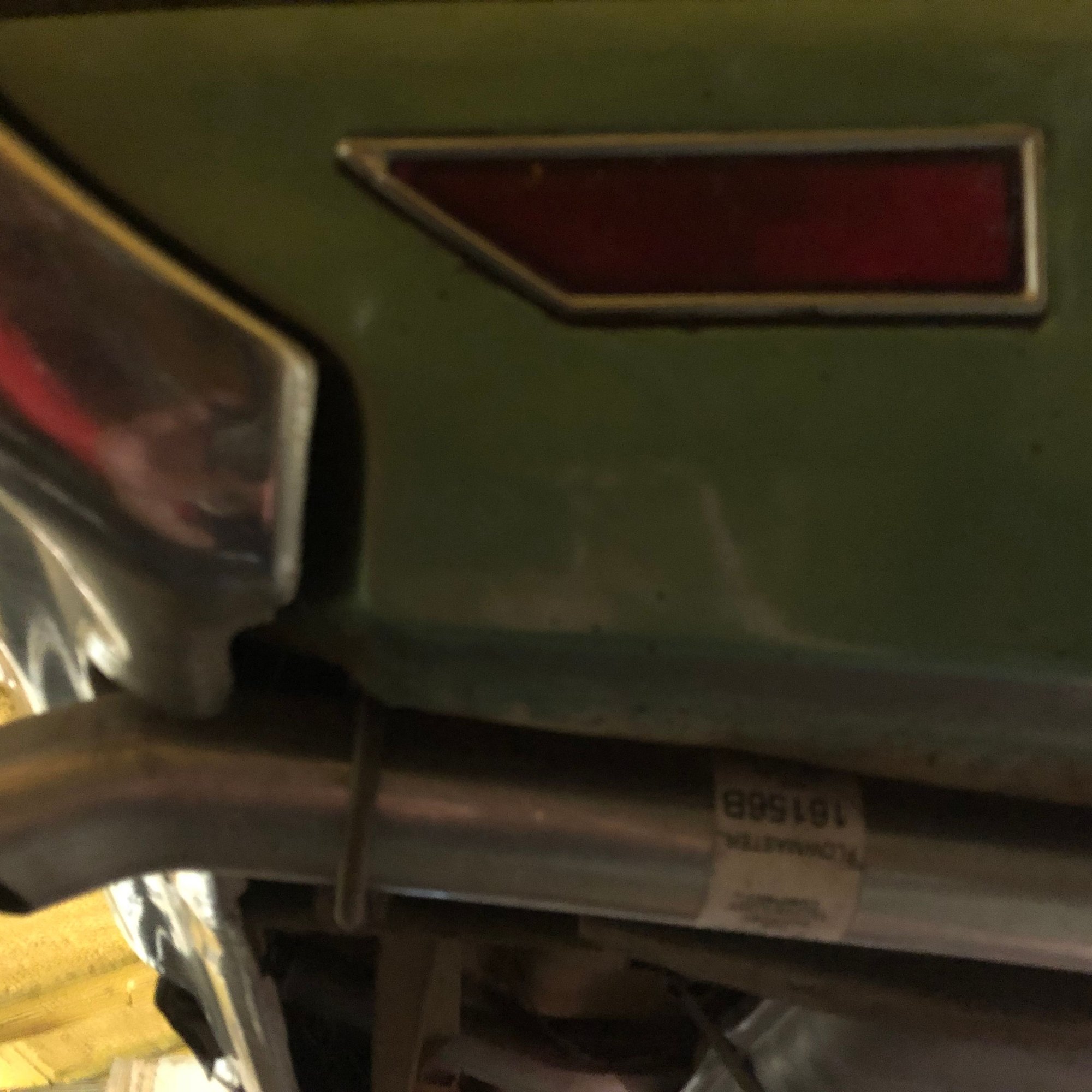

No rust anywhere on body panels. The one rear quarter is just grease.

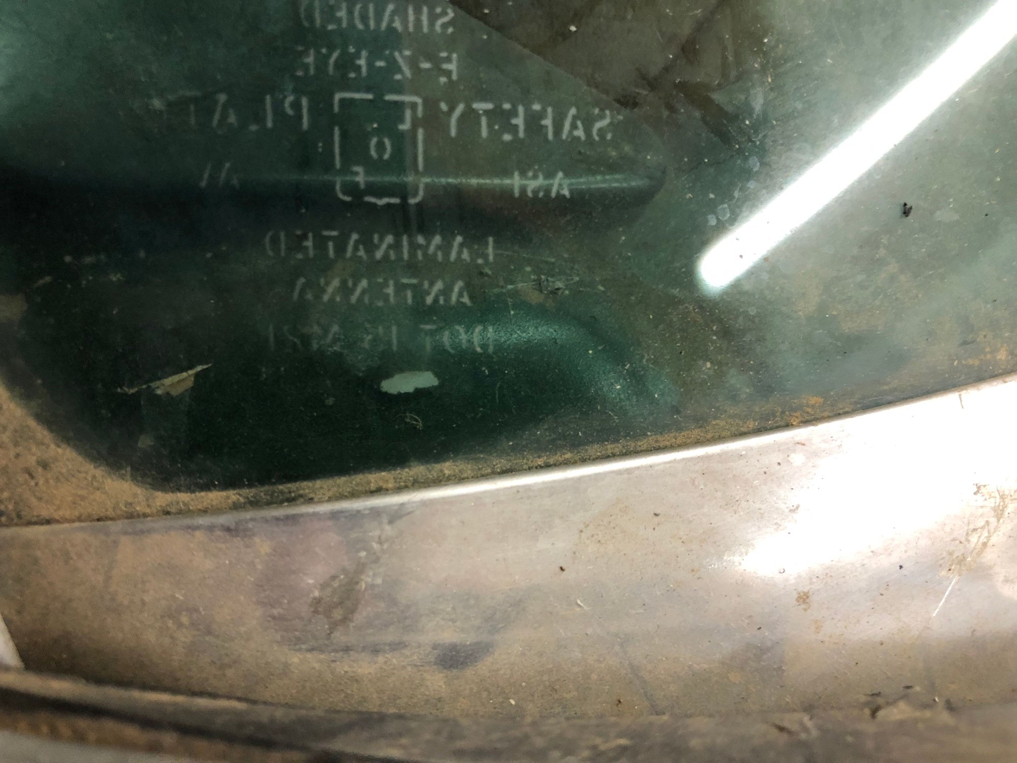

Did not even realize car had power steering. All glass original

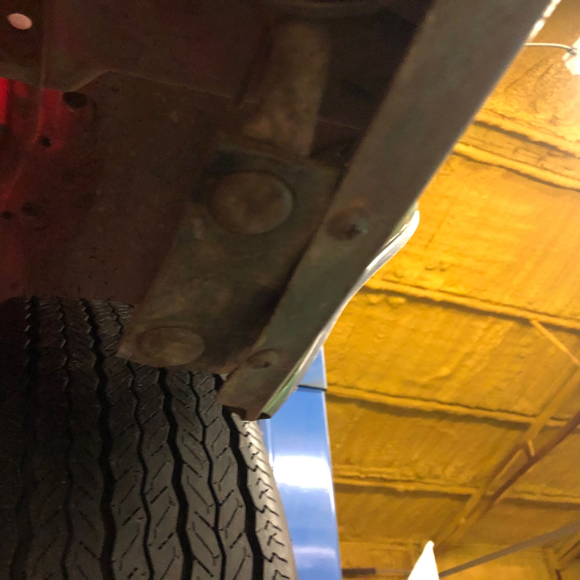

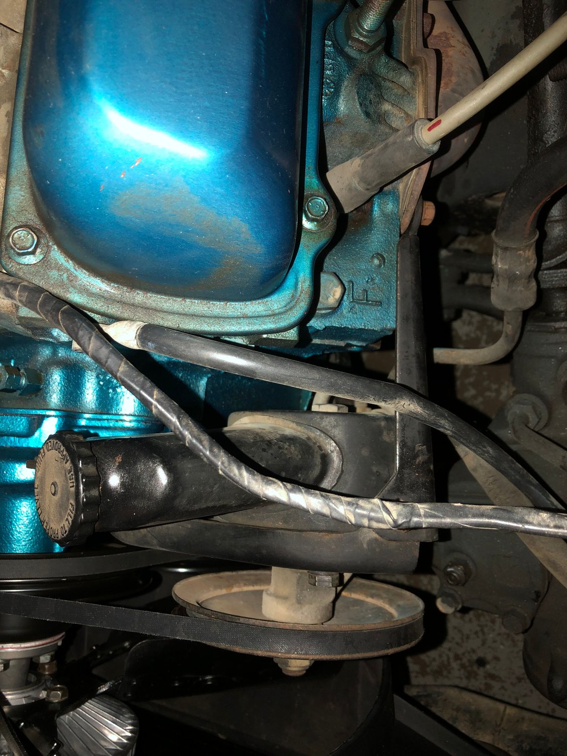

Red paint on front sway bar? Not sure if it is factory but obviously very old.

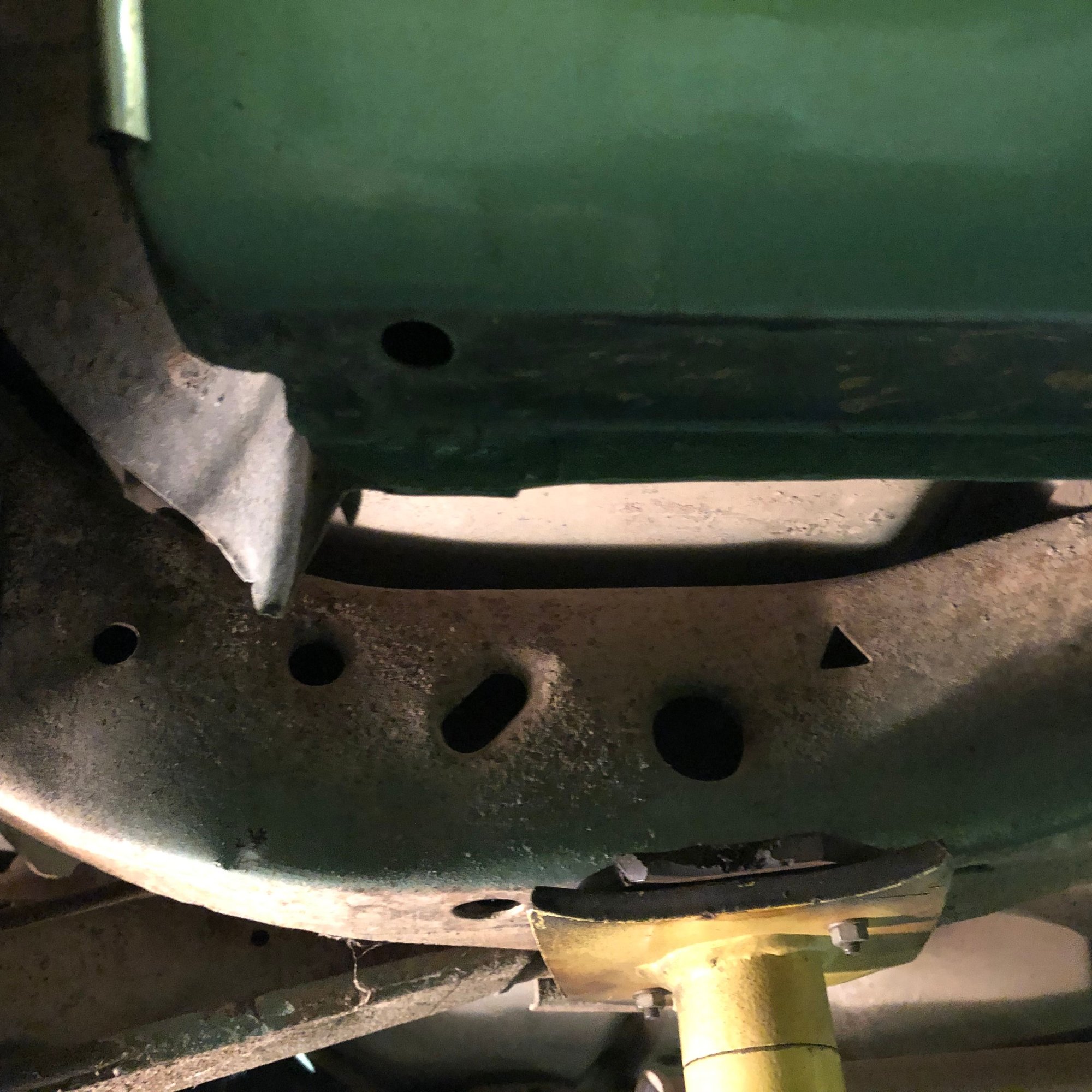

I have been curious about the hole at the bottom of the quarter. The OEM one I bought had it but I wasn't sure if it was supposed to be there or someone drilled it out? I didn't have much to go by so I plugged mine. Now Im thinking I should drill it out for drainage because it makes sense? I've seen under carriage pictures of cars but dont remember the hole jumping out in pics but I'm thinking both sides should have them. Anybody verify?

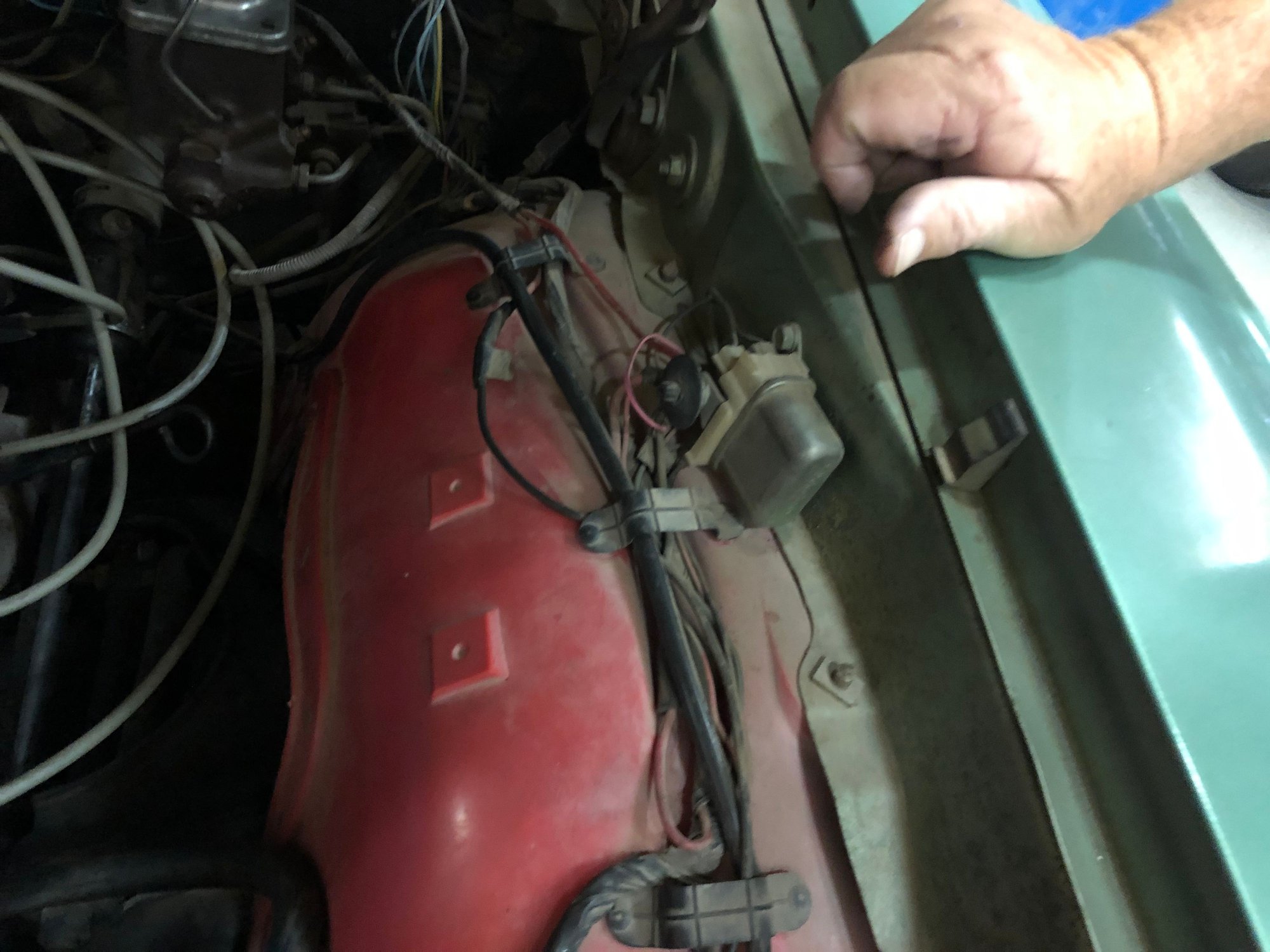

For the sake of safety, be mindful of the tan wire grounded to the clip above the master cylinder shown in the group of pictures at post #73. It looks to be the wire from the brake distribution block?

If you are speaking of these holes, yes, both sides.
