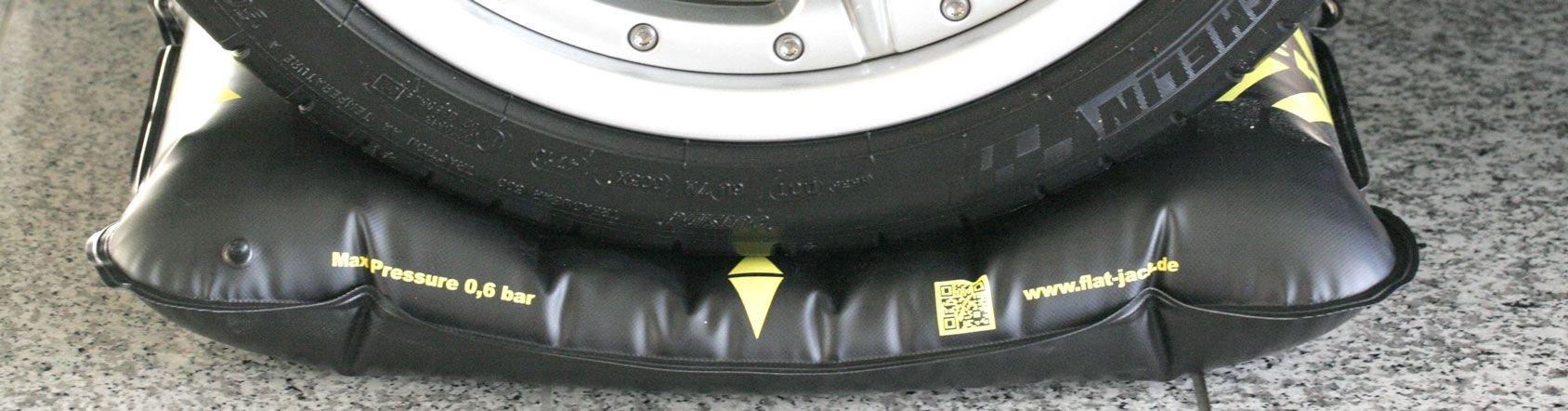

Has anyone ever tried this or anything like it? This one was written up in the 1/7/16 issue of Old Cars Weekly.
http://www.flatjack.com/
They're not cheap. $120 each for tires up to 195 mm width and $150 each for widths up to 345 mm.
