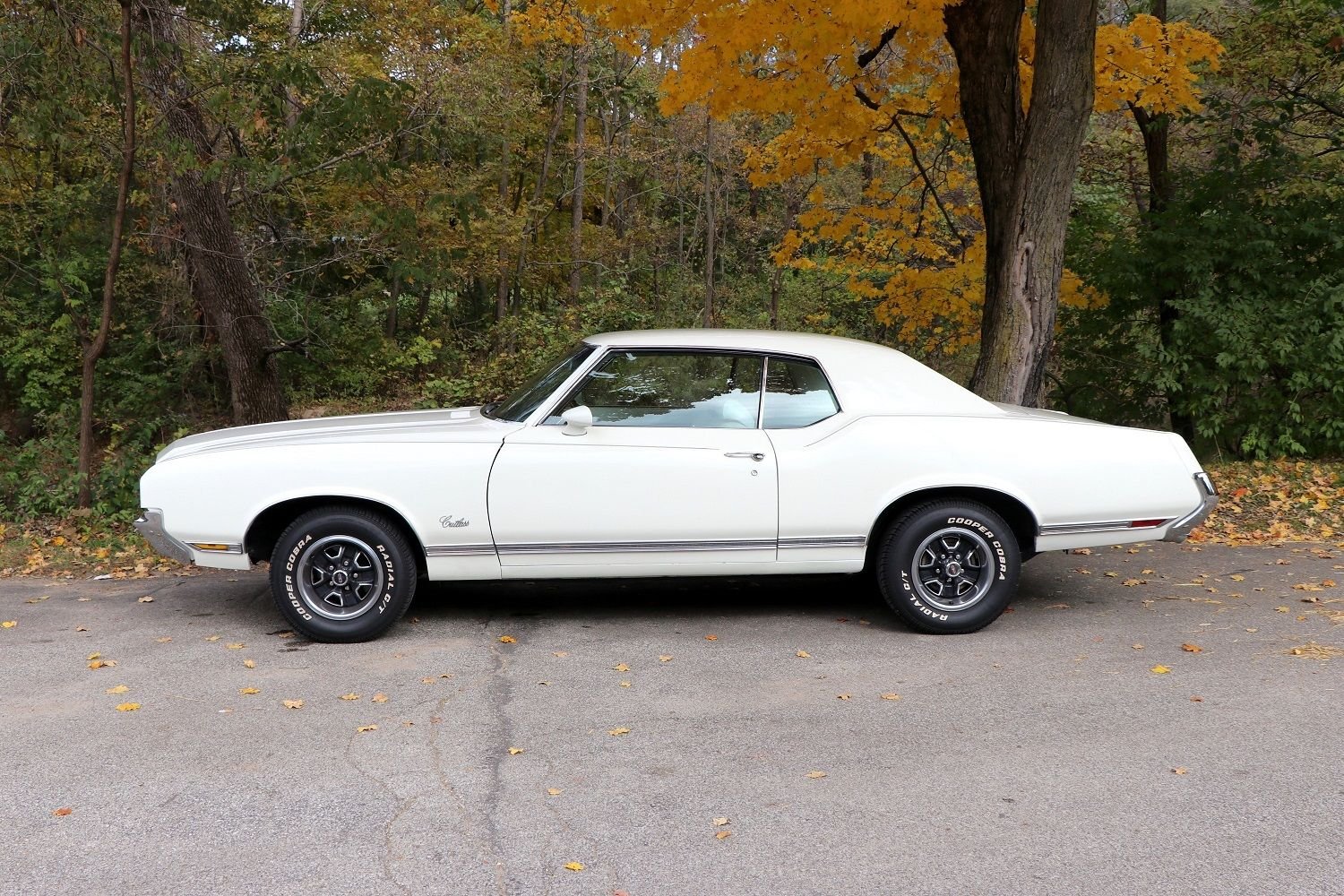

Hi, I was hoping someone who knows more than me (most people) about wheels can give me some advice. I am considering buying a set of 15 inch polished Torq rims. The sizes are 235/75 15 and 275/60 15, 15x7 in the front, and 15x8 in the rear.
Will these fit my 1971 Cutlass Supreme? They are brand new with caps and lugs. The man said he paid over $1500 all together. The ad is asking $1400 but I think he may come down a little tiny bit. I know it's a pain to get these shipped, mounted, etc. so at least I would not have to deal with that. Plug and play, if you will. My main concern is, will they fit and not rub or anything? I have stock 14 inch wheels on the car now. I'm not super worried about the speedo, we rarely even leave town with this car and honestly my wife and her friends drive it more than I do.
attached is a pic from the ad. Thanks! John

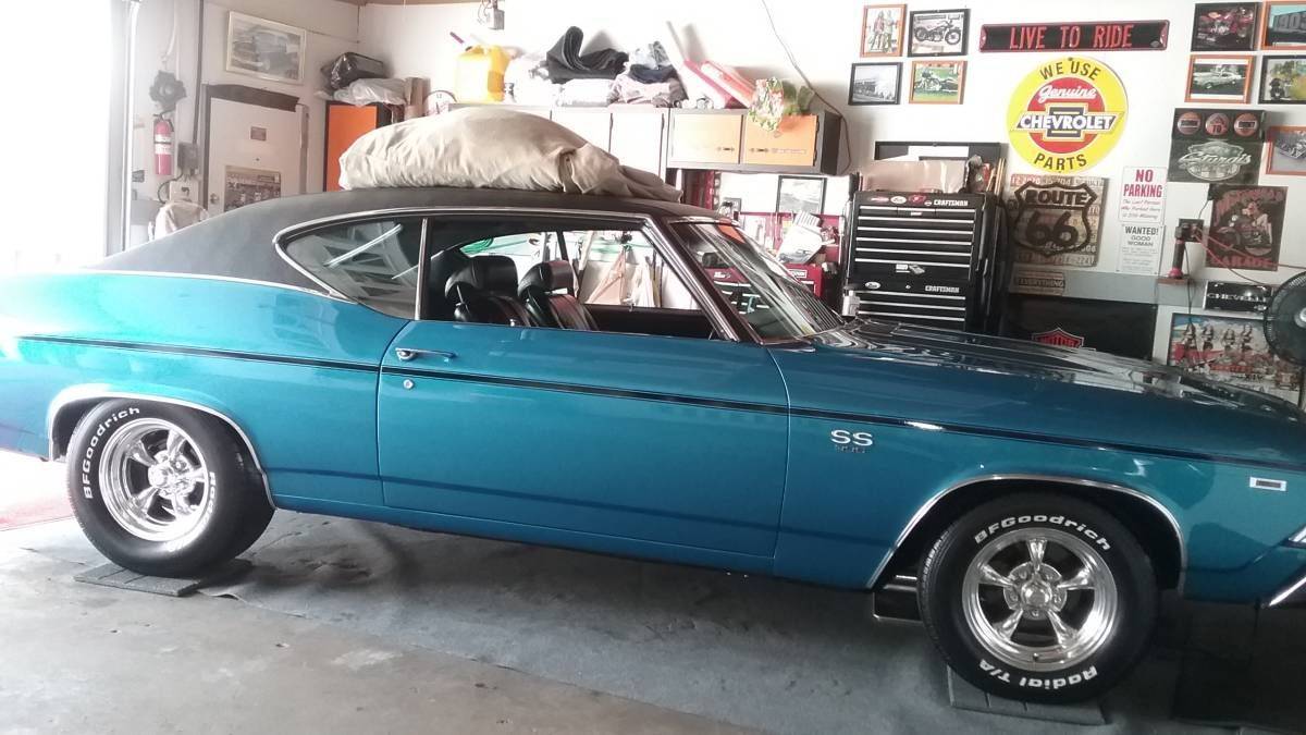

The front tire size you quoted does not exist, the rear tire in the picture looks wider than the 275-60-15, it looks like a 295-50-15 while the fronts may be a 235-60-15. Either way, if you have a discount tire near you, price what a set would cost new. I don't think your that far off vs the used.

If they'll fit under a '69 Chevelle, chances are excellent they'll fit under a '71 Cutlass.
