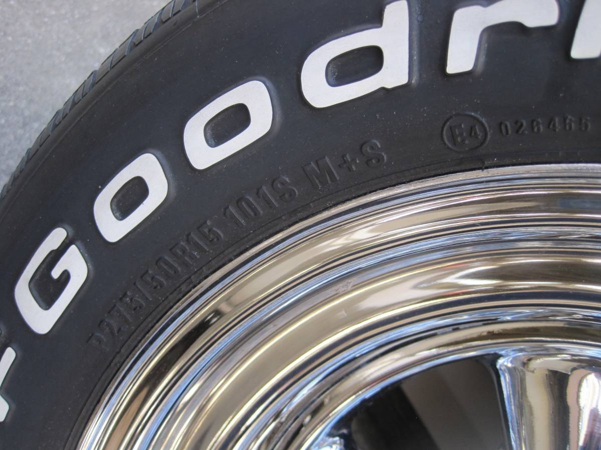

Old Mar 4, 2025 | 11:49 AM
Jimbo120's Avatar
Joined: Feb 2018
Posts: 32
Old Mar 4, 2025 | 12:00 PM
Posts: 50,768
BFG does not make a 275 50 15 tire.
They did up until recently
Old Mar 4, 2025 | 12:15 PM
Jimbo120's Avatar
Joined: Feb 2018
Posts: 32
I didn't check the date code, but I'm guessing if a deleted size, they may be too old anyway.
Old Mar 4, 2025 | 01:42 PM
Posts: 42,475
Recently meaning before 2009?
Old Mar 4, 2025 | 05:16 PM
Posts: 50,768
Hey, I consider any car made this century to be a "new" car.
