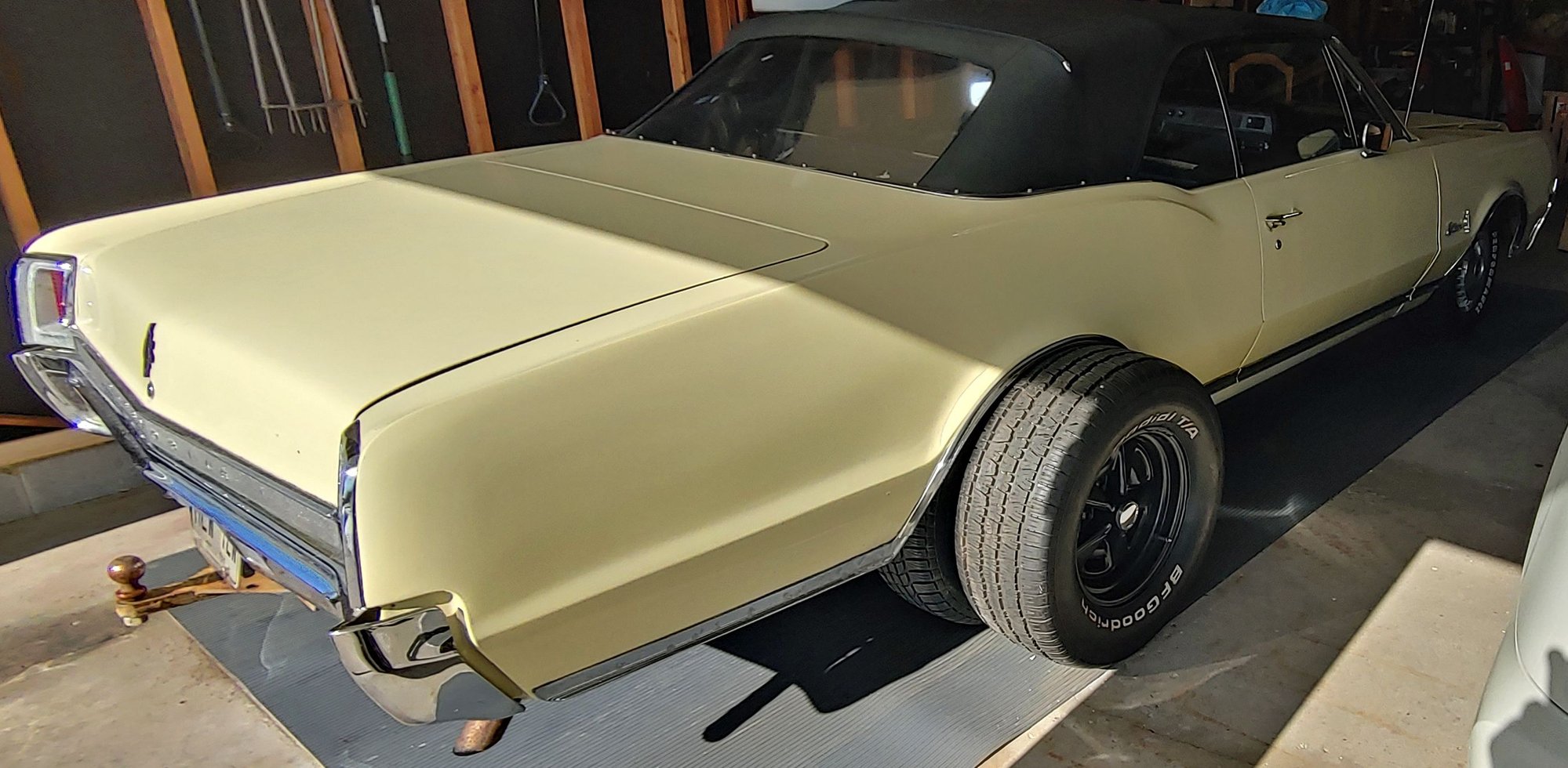

So I went away from ordering American Racing rims! I found these Pontiac OEM rims that I like (should fit- I hope ha).

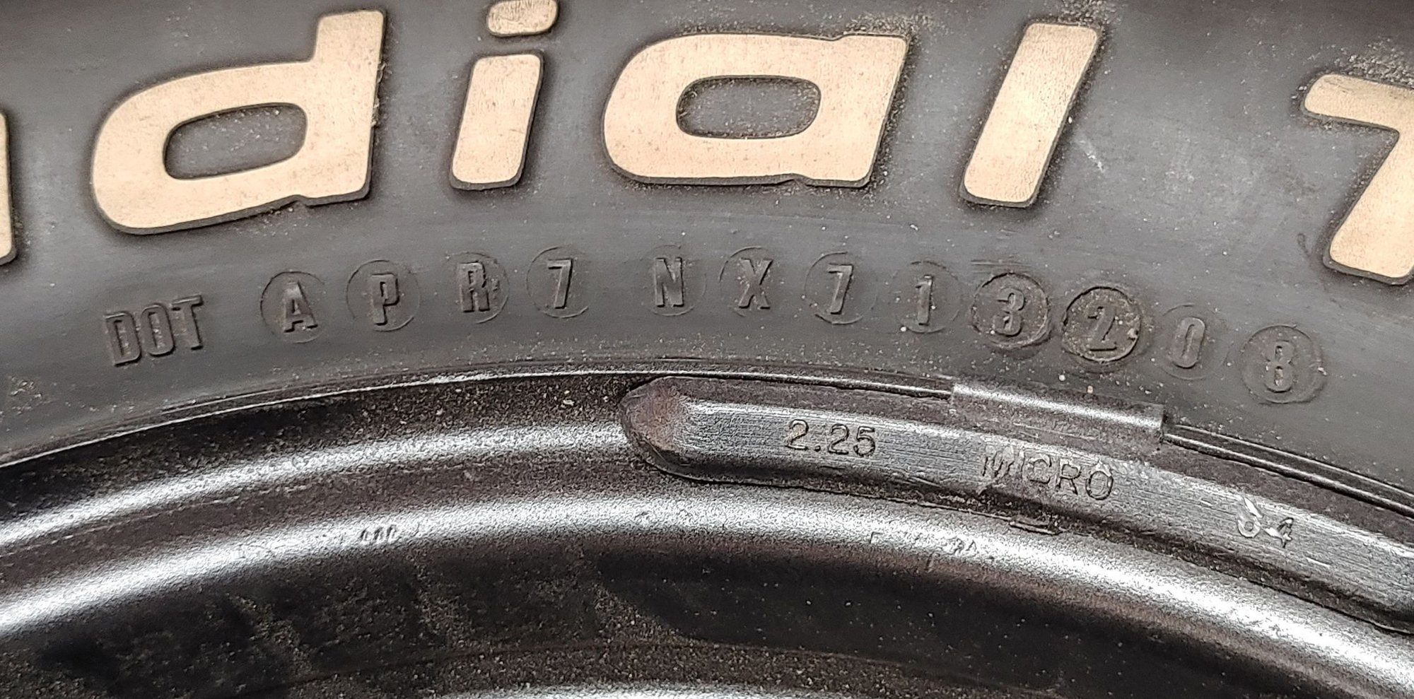

They came with 2x 275/60/R15 BFG's on the rims - correct me if I am wrong, 2008 is the date code (pic below)?? I already bought 2x 235/60/R15's for the other 2 rims (front). Now- question, should I buy 235's for the rear to match, or should I go wider in back- what are the implications?

yes, 32nd week of 2008

I like your Cutlass Convertible! You better get new tires especially if you’re towing.
That hitch will come off soon. But yes I'll buy new tires to replace those 2008 ones ha.. to bad, they told me they never used those tires because they didn't fit. Seems like a long time to keep tries that didn't fit!

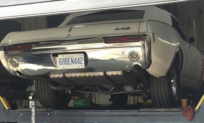

Here's one of mine. 66 442 with 15x8 Hurst wheels and 275/60-15 Nitto 555's

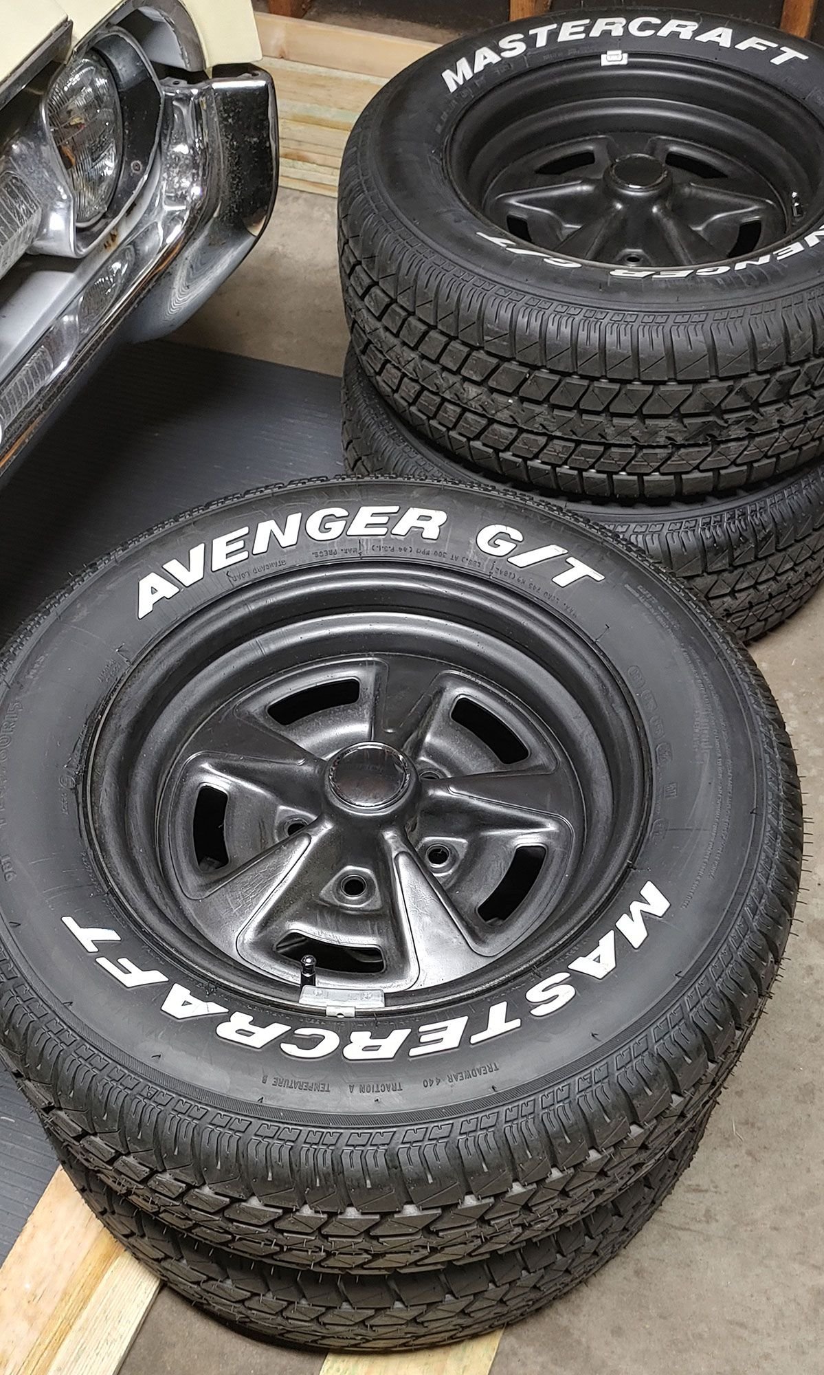

Final results! 235 R15's all around on Pontiac rims + OER DK79 High Crown lug nuts
