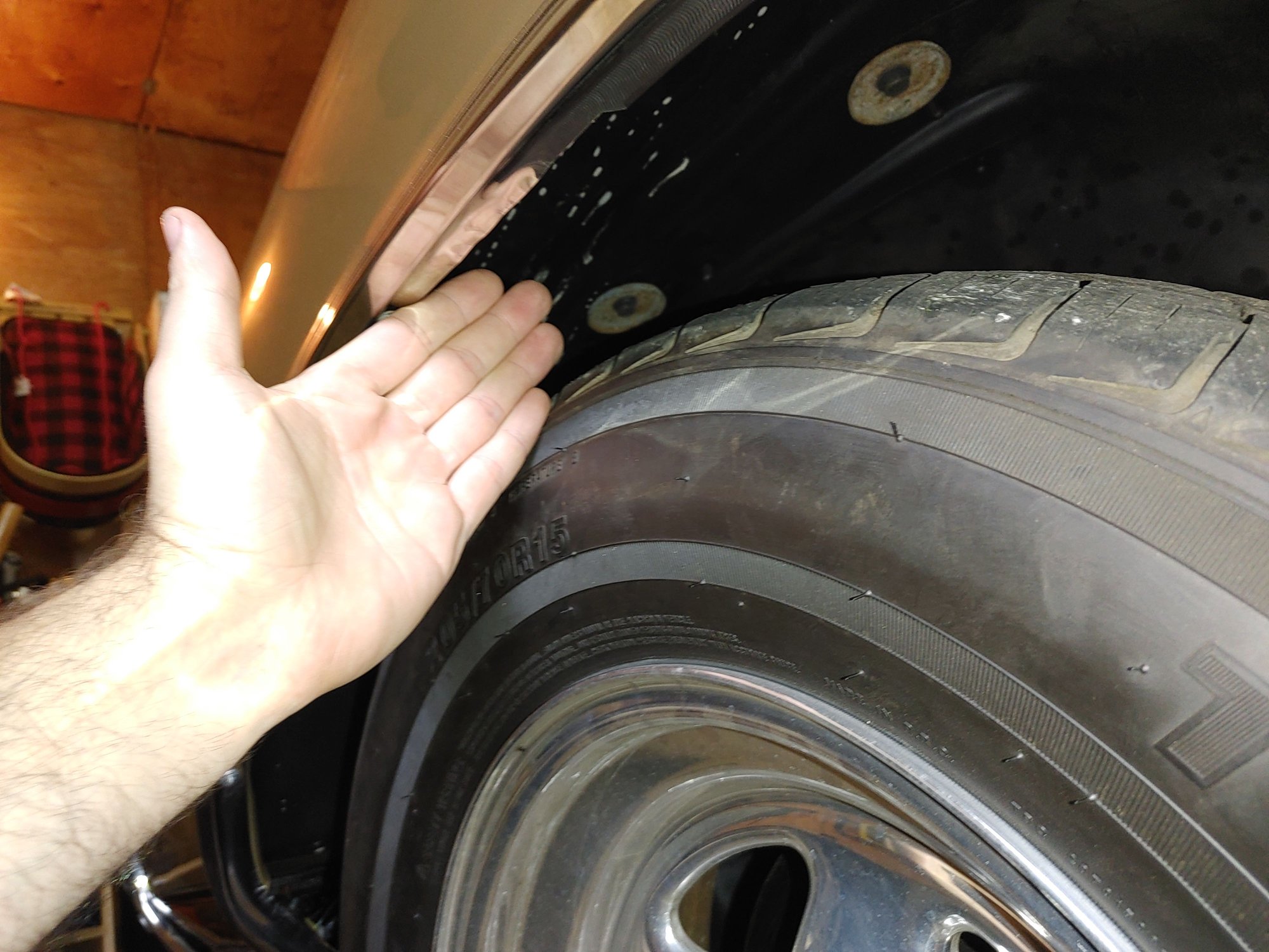

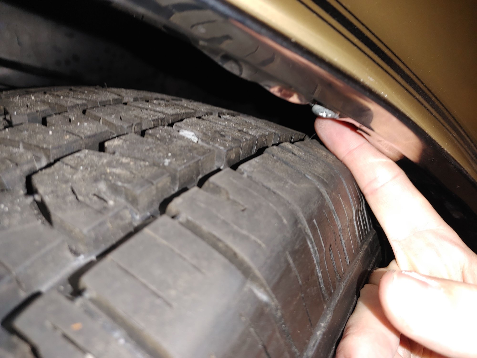

I need to change my front tire size. i have 235/70r15 but I almost ripped my chrome trim.
I have 2 inch drop spindle and the mags are American Racing AR23 with -6mm offset

235/70-15 tires are just about 28" tall, about 1.5" larger in diameter than OEM. That's your first problem. The second is, what's the offset (not backspacing) on those wheels. It appears that they have negative offset, which pushes the tire towards the outside.
235/60-15 tires are exactly the same width (235mm section) and are just over 26" tall. Stock tires were about 26.5" in diameter.

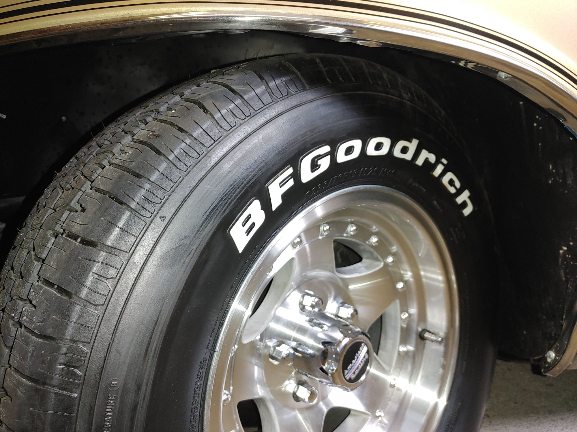

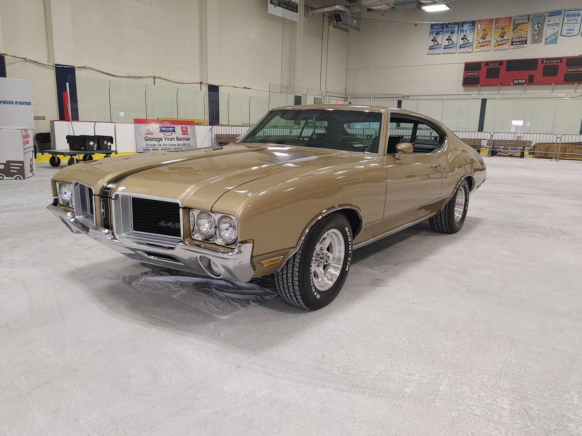

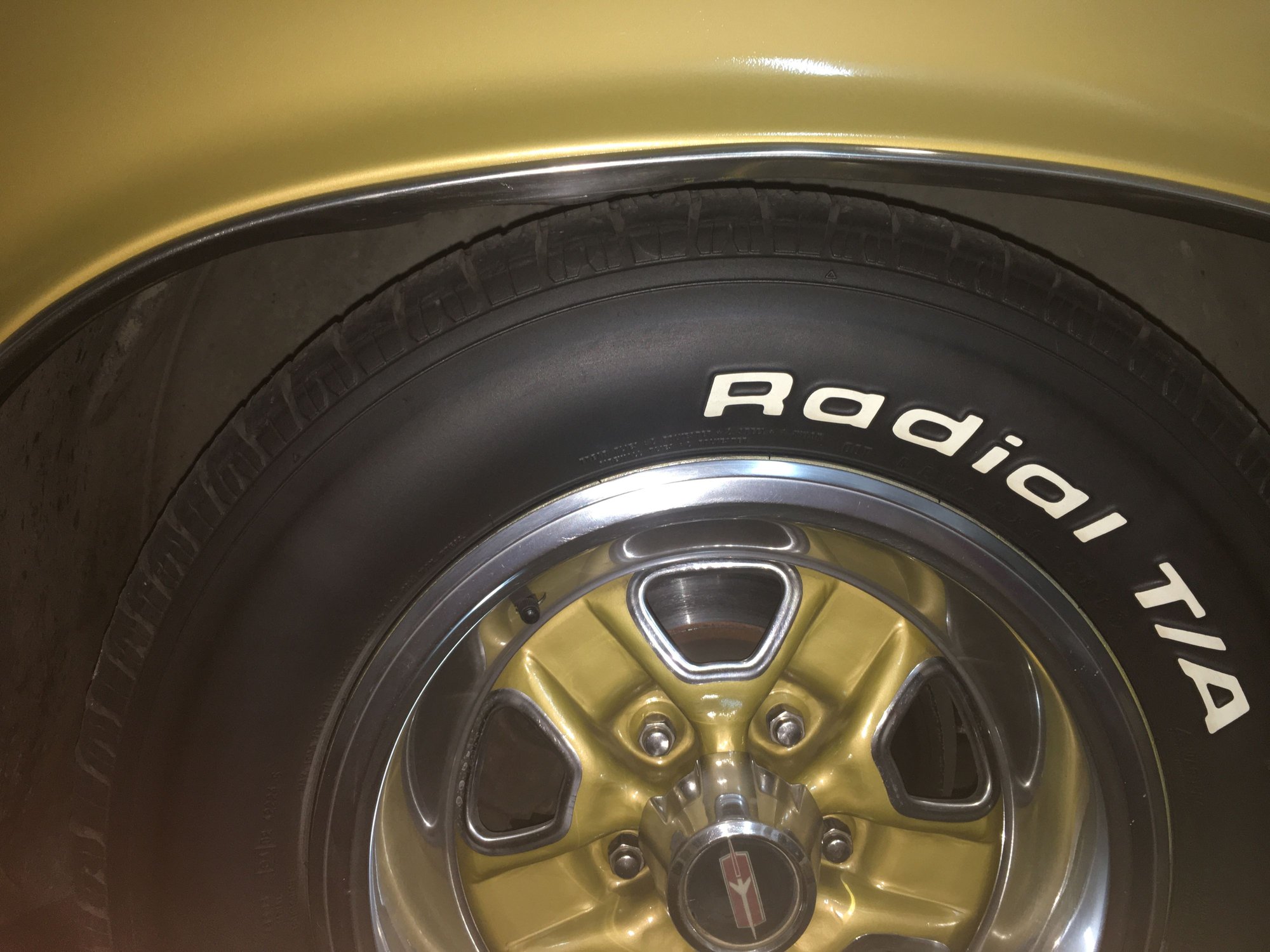

I think one reason they look too small is the car’s front ride height appears to be much higher than normal. Your first pic with the very tall 235-70s shows a huge gap above the tire to the fender lip. On my car with 245-60-15s the gap is much smaller.
I am.confused? The pic with the gap is 205/70r15

This is the pic with 235
I also mentionned that i have 2 inch drop spindle so my front is no supposed to be higher than normal

Those are the pictures I was referring to.
the picture with my 235/70 the wheel are turned maximum to the right **
Just to clarify for me, does your 245 stay in the inner wheel or does the tire is slightly above the chrome trims?
I try to know if I can put these even if I have -6mm offset.
