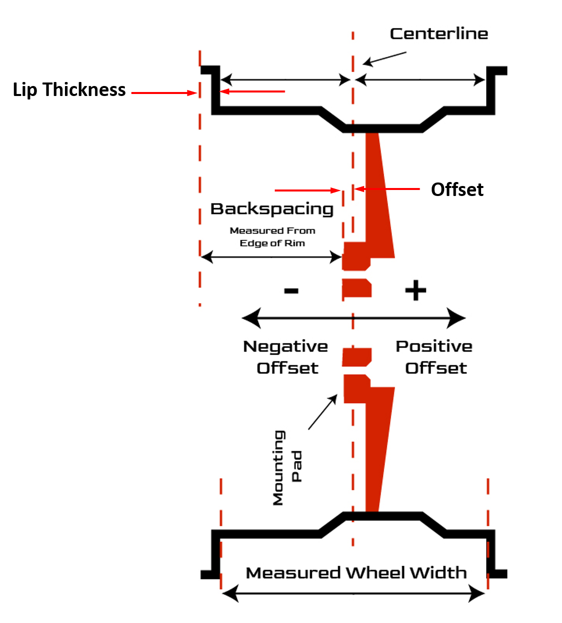

For zero offset, the backspace minus the lip thickness should be half the rim width. This puts the wheel mounting surface exactly in the center. If the backspace minus lip thickness is greater than half the width, that's positive offset that pulls the tire inboard towards the frame rails. If smaller than half the width that's negative offset that pushes the tire outboard towards the wheel opening.
This illustration is showing negative offset, as the wheel mounting surface is closer to the backside than the front side of the wheel.

I measured my rims and I have a positive offset of approx 1 inch. The wheel mounting surface is closer to the outside of the rim then the inside. So where do I go from here? Why would the front tires rub the fender when making a sharp turn?
