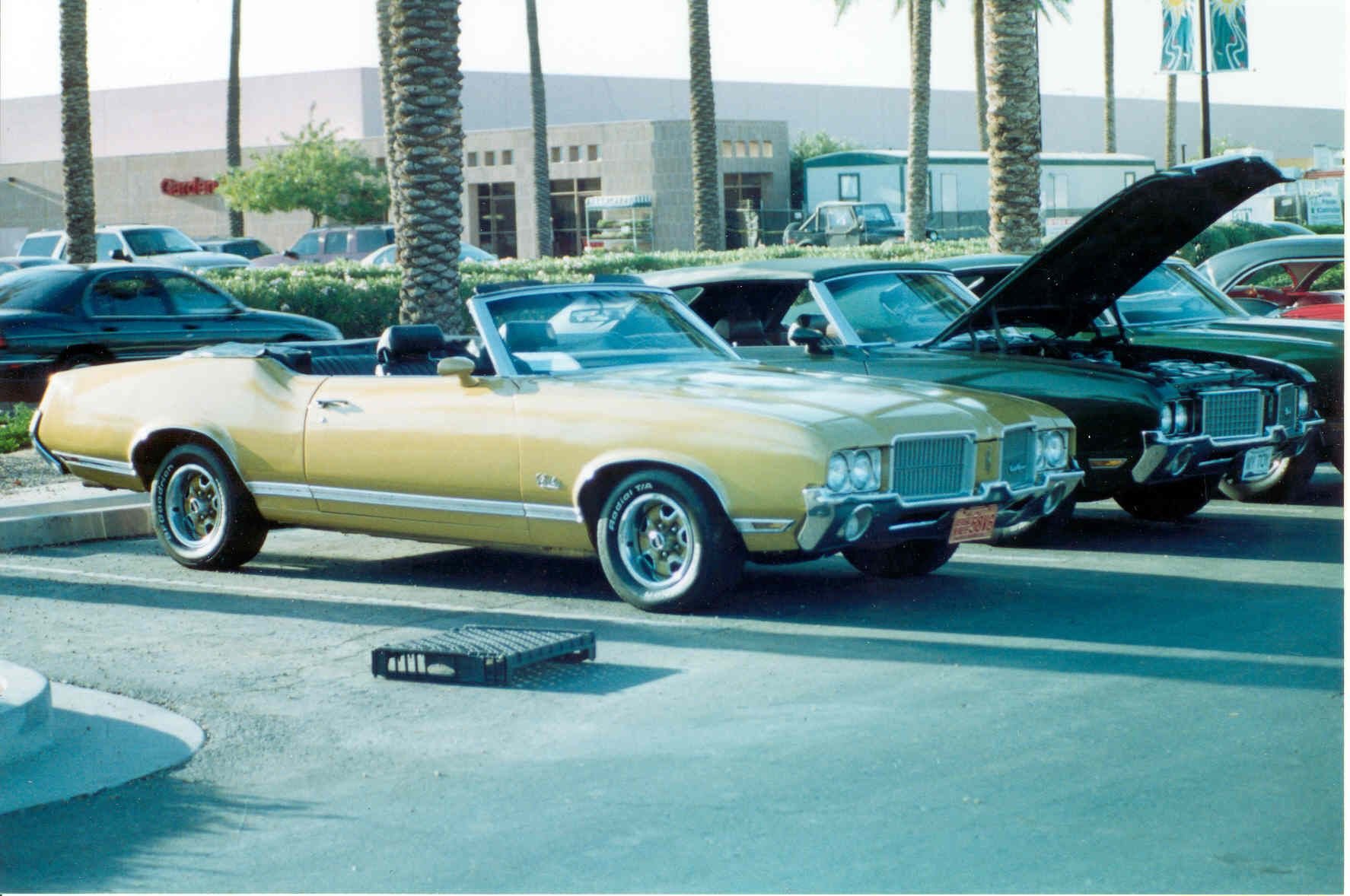

I would go with 245-60-14 instead. Had those on my '71 for decades until I switched to 15" wheels, then used 245-60-15s.
Here's an old picture of my car with the 245-60-14s.

my .02 ...... 235/60/14 & 245/60/14 are too short for the big wheel wells of a GM '70-'72 a-body - both are shorter than the 442's factory G70-14 (& its 225/70/14 modern equivalent)

^^^THIS! The 225/70-14 is 26.4" outside diameter.
The 235/60-14 is nearly 1.5" SMALLER in outside diameter (25.1") and a whole 3/8" wider. They are barely big enough for a Honda.
Even the 245/60-14s are almost an inch smaller in diameter (25.6") and barely 3/4" wider.

Fender filling vs tire height really depends a lot upon the vehicle ride height. If the car is 4WD high, taller tires are needed to fill all that open space. With a lower ride height, a shorter tire will fill the gap adequately. Choose the tires accordingly.
The problem is that when a car is lowered too much, the arc of the wheel opening doesn't match the arc of the tire, which looks goofy to me, anyway.
