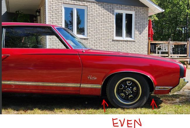

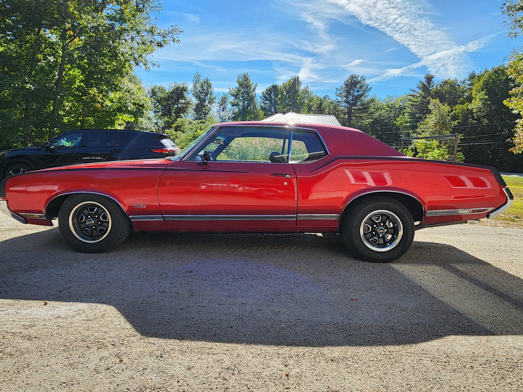

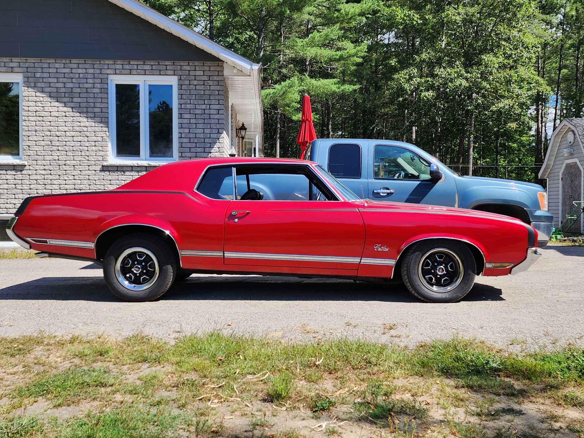

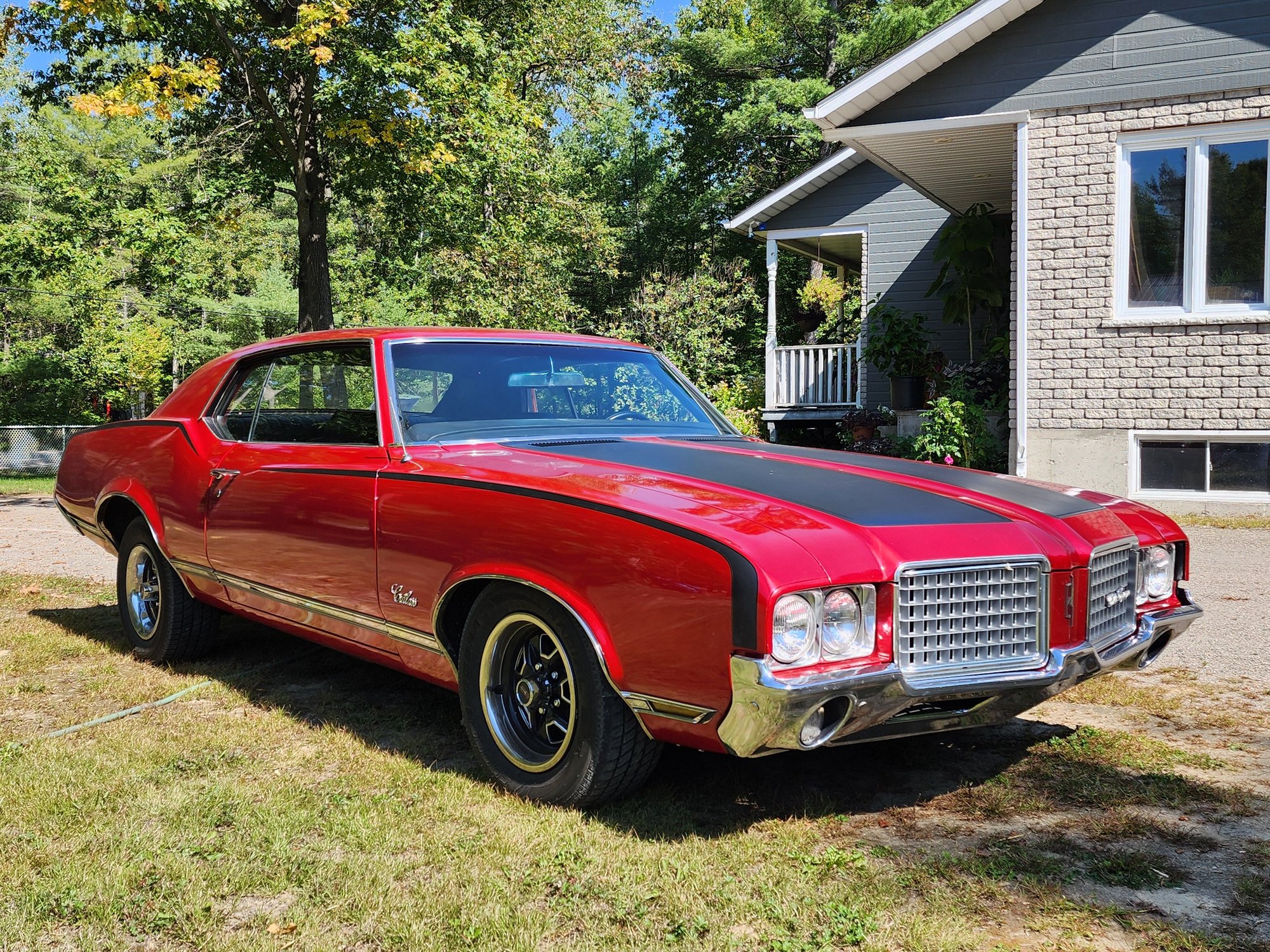

So this is my stance, looks great but the front looks low especially with these tires

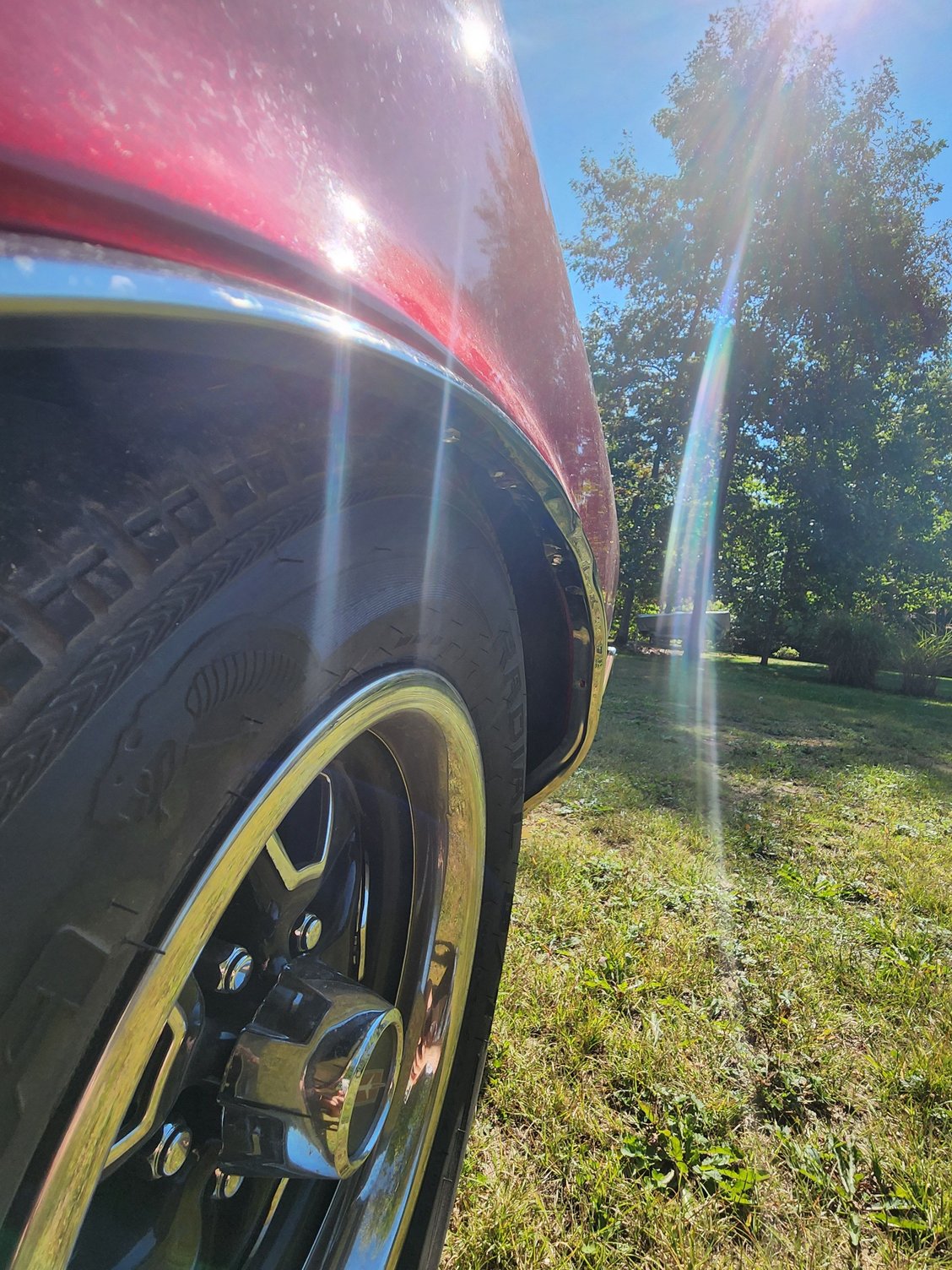

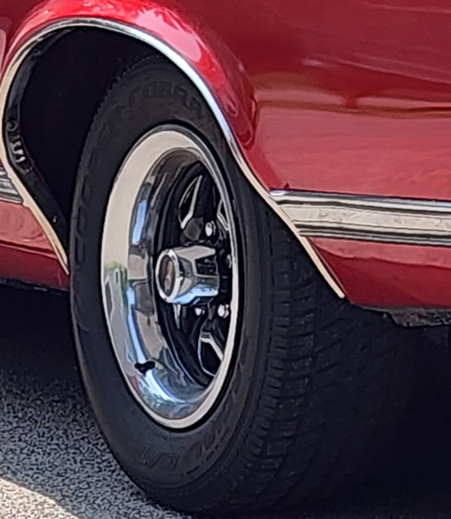

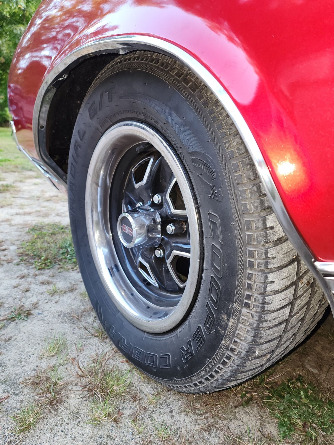

And the wheels themselves, sorry for the glare.

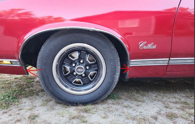

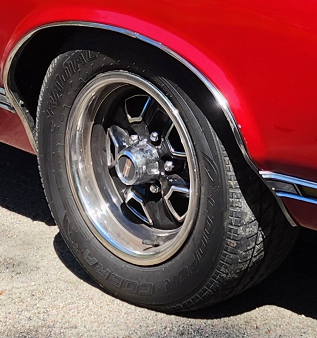

First, the right side. The problematic side.
I've been having some major rubbing on the chrome here with a passenger.

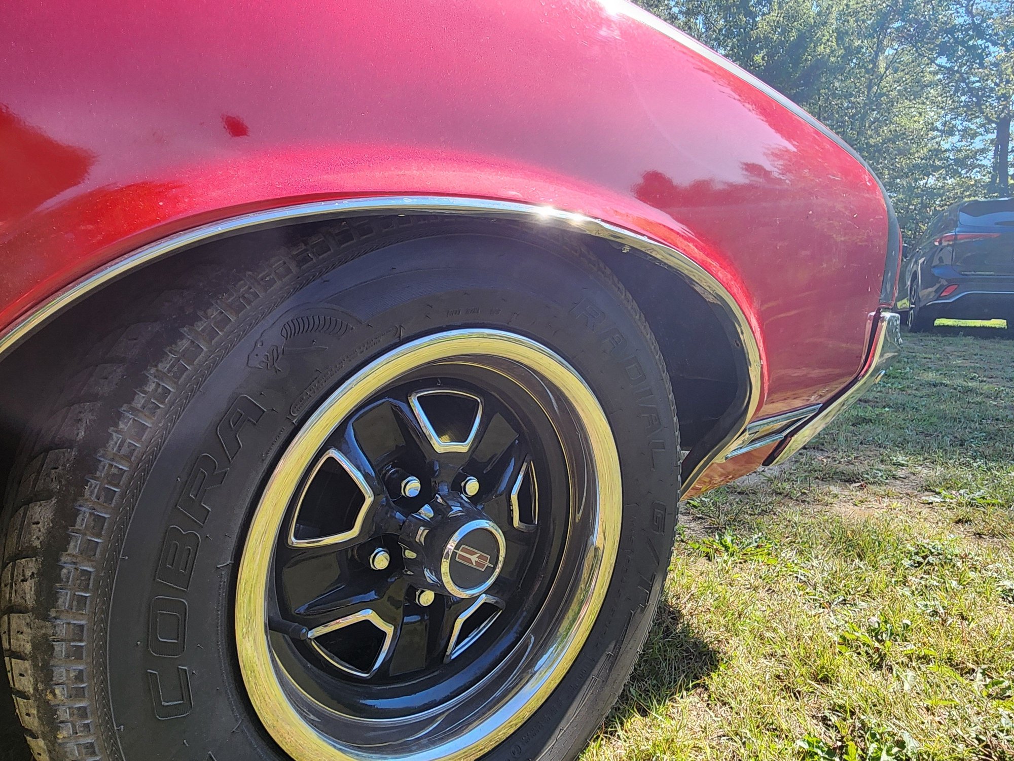

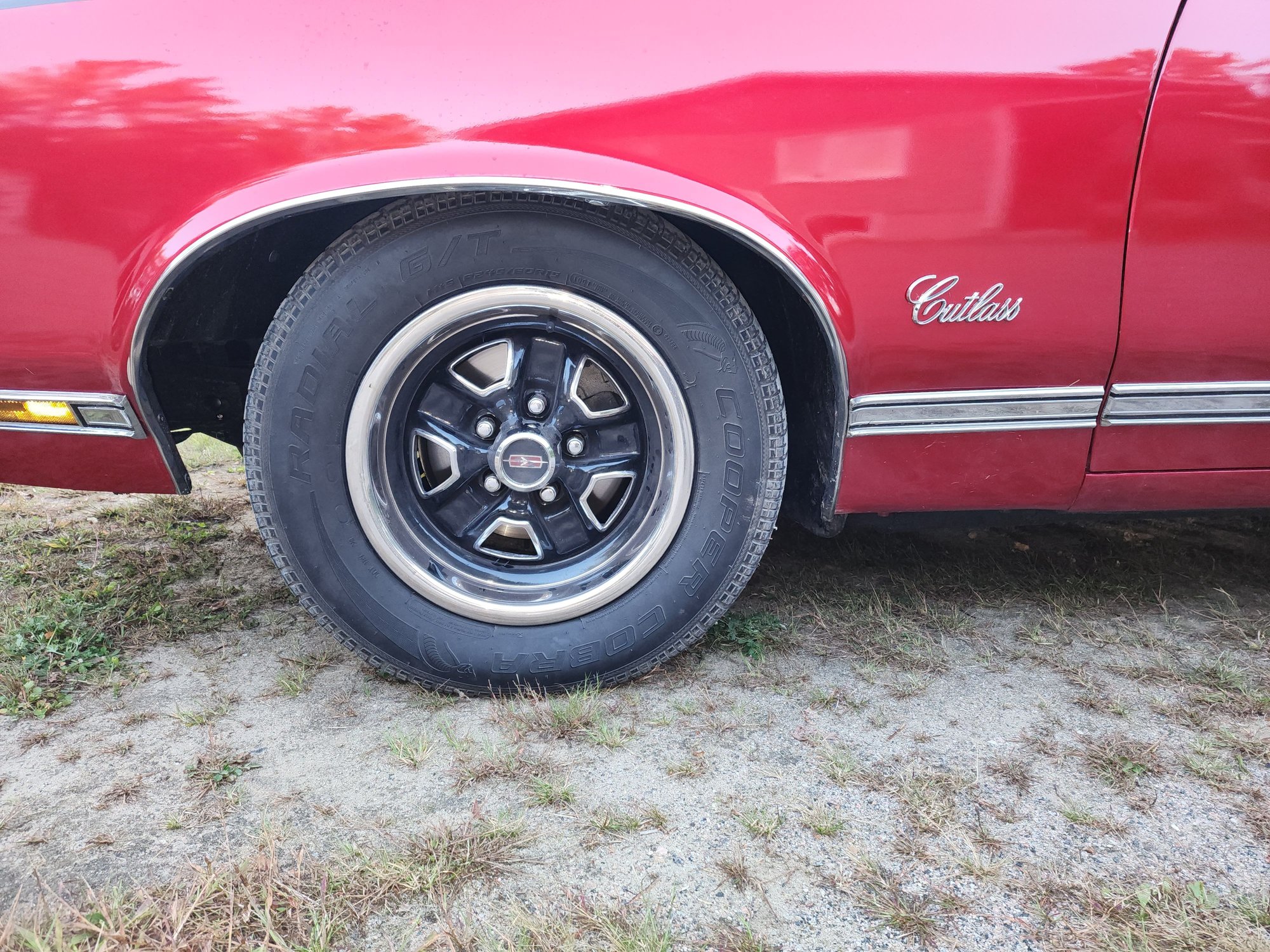

And this is the driver's side much more clearance.
After it was aligned, no more shims could be taken out of the driver's side to bring the right wheel closer
My fender is kinda sticking out towards the bottom as you'll see but it fits fine everywhere else, I don't think its the issue but it's another thing I noticed!

Your front rims seem to stick out considerably more than normal. Then add on that the tires are 2 inches wider than factory...

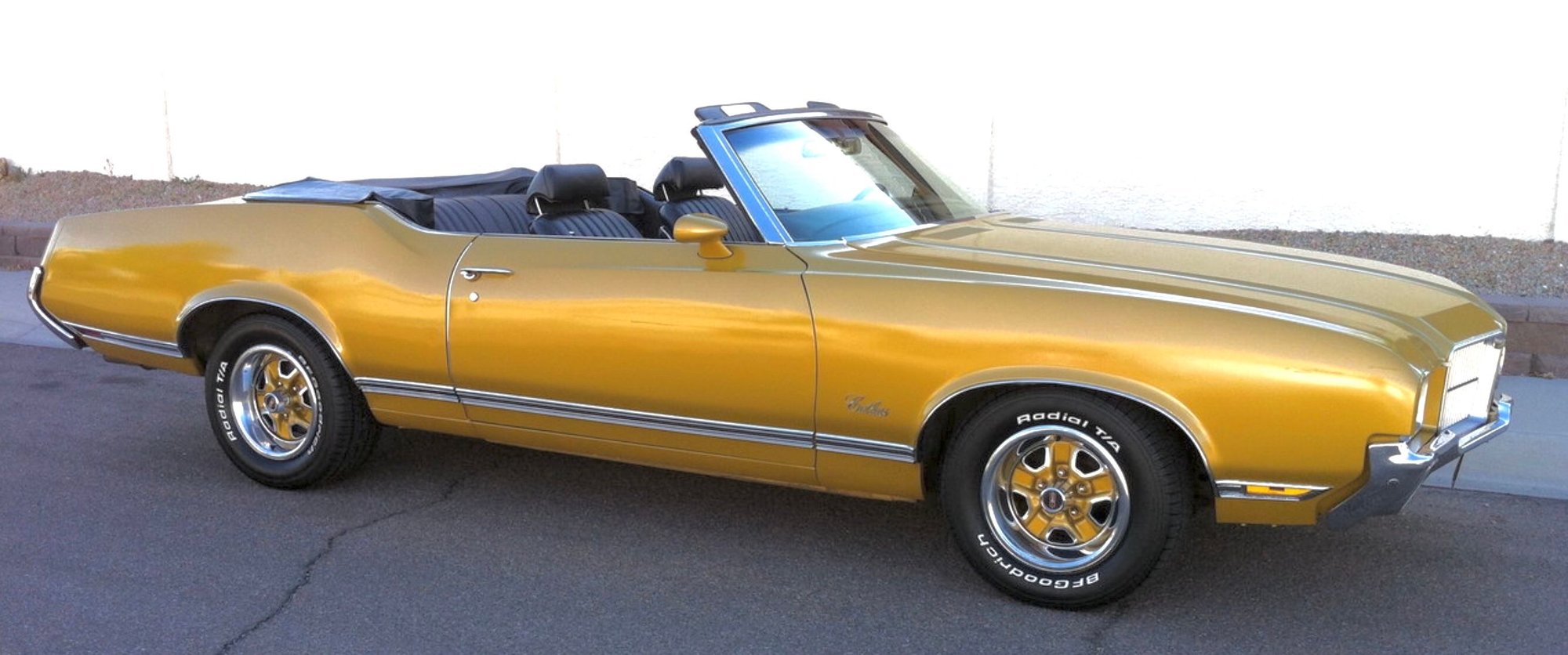

Below is how the wheel should look, in relation to the fender.
https://bringatrailer.com/listing/19...le-cutlass-17/

Wow, yes your wheels are sticking out further than they should! Also note your trim rings are much shallower, which indicates the wheel isn’t as deep.
FYI, I have a spare set of 15” SSIIIs that are collecting dust.
My ‘71 has 245-60-15s on factory 1975-era SSIII wheels, and there’s no rubbing. My front end has Moog 5536 front springs and the front tires appear to be more exposed than yours as well.

Yes sitting low in front and wheels are in a bizarre location.
Versus where it should be.

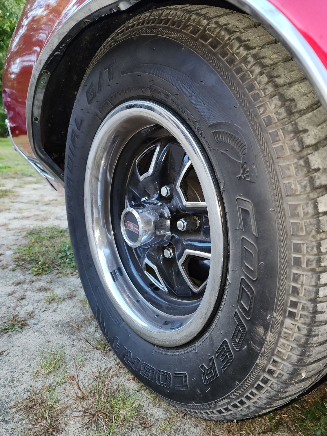

It appears to be the wheels. Note how shallow the trim rings are compared to the picture 69CSHC posted, indicating the wheels are not as deep. I don’t know too much about the later cars, but I suspect your wheels are from something in the 80s.
I was told they were an inch offset.

But here's a photo with a more dead-on angle but on the right side.

So those are aftermarket wheels? A set of original Olds 15x7 SSIII wheels would cure that offset issue.

Your wheels look very much like these

I do have these that display the depth of them better but the more I compare mine to yours, yeah. These aren't the proper SSIIIs
Additionally, my rear wheels are deeper than my front ones.

The slight angle of the other picture, along with the added width of the oversized tire, makes it look way off.
Yes, strange.
Look at where your trim rim sits.
Versus a factory correct 14 x 7.
It's almost as if something was done to your front end to push the wheels out. And your 15 x 7 rims were modified to make it work...
Unless your camera is playing some serious tricks with our eyes...
Here are correct 15 x 7s

So looking at my image again, I did mess up the photo, I've taken another.
My front left wheel is way in while my right is pushed out.
I don't think there's any spacers as well.
And I can see what's wrong here

Look at the left to right difference on the wheel well to tire gaps between the right and left sides.
I see a ton of negative caster on the left side.
Looks like its got drop spindles too. Are they installed improperly? Front end is way too low.
Thats not helping the positive camber which is contributing to the wheel rub.
The rims look off but that could just be a visual with the shallow Pontiac trim rings.
Snap a pic or two of the car with the left wheel off with good lighting. Like to see the rotor and control arms.
If this was my car I would find a frame specialist with a good frame table and skills.
Get it measured to verify the dimensional specs are in tolerance before you do another thing.
The frame shop will be able to pin point the problem and stop the guessing going on here.
This could be a safety issue. Inspect everything, the BJs, control arm bushings, cross shafts, look for rubber deterioration and the bushing through hole bosses in all 4 control arms for cracks. Look at the LCA mounts especially the rear arm to frame mount locations.
Once you have the proper diagnosis get the factory springs and spindles installed as I'll bet other things are coming apart anyway.
Eaton Spring -supplies the factory rated spring for this application.
While the cars on the rack look at the rest of the chassis for wear and integrity.

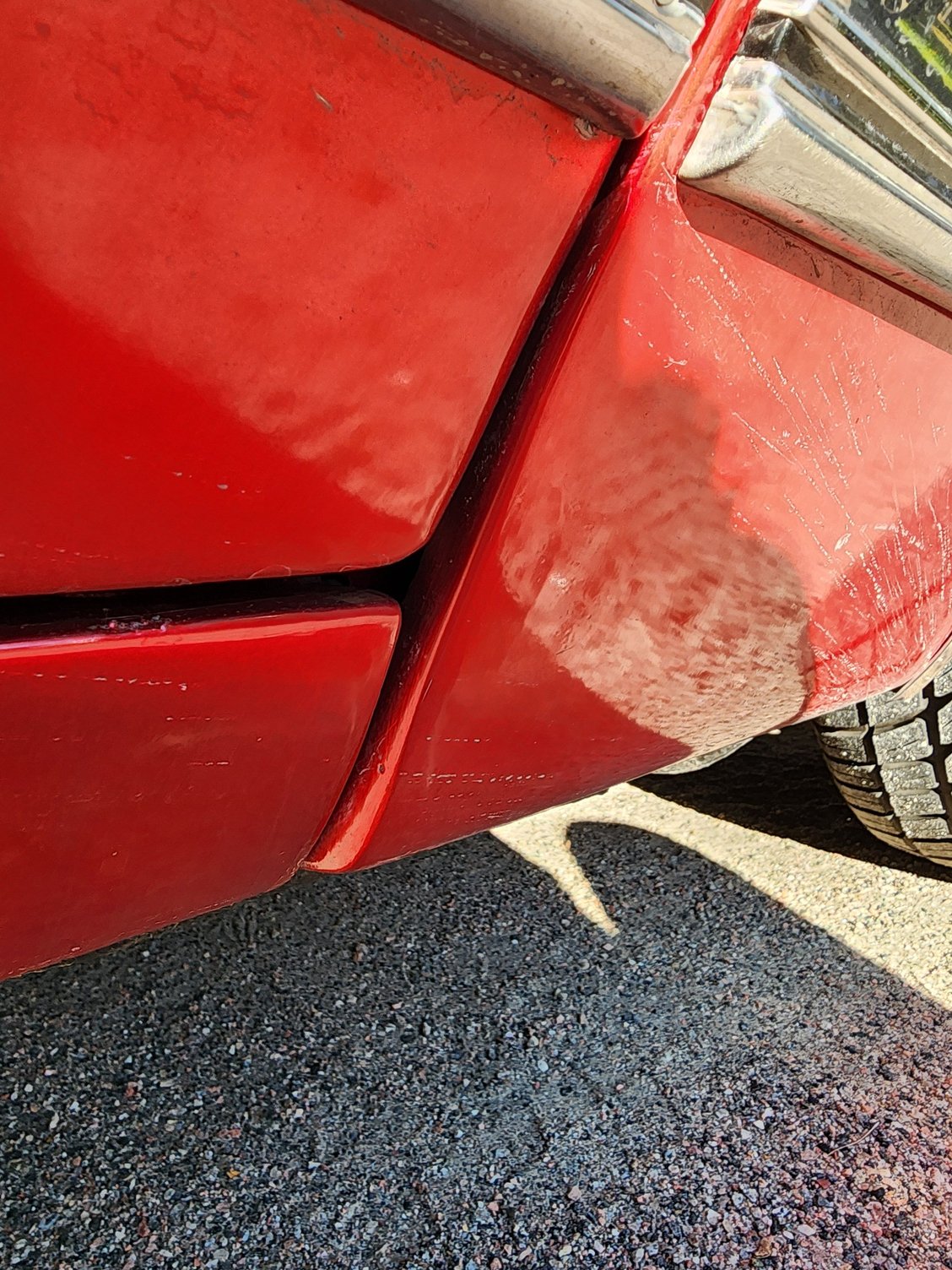

I'm getting this car back on a hoist sometime soon along with getting that alignment checked out again, that caster is bothering the hell out of me.
Found out that the right side fender has been pushed inwards, I'm going to go and get that pulled out whenever my bodyman is able to take me.
It also seems the left fender is misaligned a bit. Could be why it looks like the caster is way negative or I have bigger problems on my hands!

From: Western QC
Measured the distance between front and rear wheels, they are the same distance from each other on each side.
The caster looks to be some due to improper fitments on the fender. And my right fender is pushed inwards with what might've been a hard bump.
I'll look over the car again just to be sure everything looks good, I will hold off those springs if it fixes the rub issue and install coilovers next spring, (When the car comes out of storage.)
I really appreciate the advice you guys have given me!
There's no spare in the trunk for this one.
Take a piece of printer paper to use as a "straight edge". Lay the paper on your screen at the rockers and see where the paper edge crosses your wheel center cap. It should cut across the middle of your center cap, or close.
I'll add my thoughts here.
1. Let me point out the "Big Block"/"Small Block" poppycock from many, many years ago when Chebbies had the 265, 283, 327, 350 engines were referred to "Mouse motors". The 396, 427, 454 cubic inch motors were called "Rat motors" to distinguish the engine families. There were distinct engine weight differences between the Mouse motors and the Rat motors.
Later, the terminology evolved to "small block"/"big block". This allowed the Fords to be described similarly (Small block Windsors, Clevelands, etc. OR "FE" 352, 390, 406, 427), Mopars (273, 340, 360, etc. OR the 413, 426).
The Oldsmobile "Small blocks" were the 330, 350 and 403. The big blocks a considered 400, 425 and 455. I don't believe weight differences are as gigantic among Oldsmobile engines as was with Chebbie, Ford and Mopar. As a result, this "small block/big block" front springs is a bit Bogus when referring to Oldsmobile's.
2. My first inclination is to get a competent shop to check your frame to see if the frame is straight.
3. With wheels off take a pic for us and look wheel spacers and wheel stud lengths.
4. I believe Factory Olds wheels were zero offset, except the FWD cars. Find out where this 1 inch offset comes from that you mention.
5. Did you make sure the tails of the front coil springs are clocked correctly A arm ? They need to be installed correctly (per CSM) or you can get a variation in height from side to side.
6. Your front end is plenty low, but I think the rear may be a bit high also. If you raise the rear of the car, it transfers weigh to to front end which makes a low front end worse. This also hurts traction.

Does it track straight or does it wander?
Doesn't wander, stays straight, holds the line and brakes pretty good..
It may stay straight from the driver's seat perspective. But it very likely does not track straight. Subtle dog tracking is only observable from an outside vantage point.
A bent frame can still have equidistant measure from wheel to wheel per side. The general illustrations in screenshot below, although not precise will give you an idea of why the wheels can still measure equidistant to each other.
https://www.tomorrowstechnician.com/...-thrust-angle/
If you adjust the rear end housing to be parallel to the crossmember in the lower illustration. The front-to-rear wheel-to-wheel measures will be equal on both sides...
At the same time front end components may have been adjusted to compensate for the issue... Thus somewhat masking the real issue.
I literally expanded both your pics of full length passenger side and driver side. Till they were equal in dimension. Then I loosely measured the center of each wheel to the same precise locations on the body itself. Same location of rim center cap to the closest door edge by rocker panel, etc. The wheels are not in the same locations on both sides of the car. Both wheels on driver side are setback versus the passenger side locations. This can only be so accurate of course so you would have to confirm with actual measurement.

One thing missed here is the body on the frame, your car looks like mine. My car has the body 3/4" to the driver’s side vs the passenger side. No problem with my 205/70R14 or the 225/70R14 tires. I picked up 10" wide rims for the back and put on 275/60R15 tires on the back. Took my Daughter and her boyfriend for a rip, the passenger back tire rubbed. I ended up grinding that chrome trim ring and cargo coils in the back, problem fixed. My front would fit your tires due to the high factory front coil springs without rubbing. The body on frame issue is common most aren't as extreme as mine. I actually put a spacer on the drivers rear and may do the front as well. I see absolutely no frame damage, figured it is part of older mass production car ownership. Hope this helps.
Old Sep 19, 2025 | 10:05 AM
  #37
OLDSter Ralph's Avatar
Posts: 5,219
From: St. Paul Minnesota
Read post #26
Old Sep 19, 2025 | 12:03 PM
  #38
olds 307 and 403's Avatar
Out of Line, Everytime😉
Posts: 10,109
From: Melville, Saskatchewan
Body bushings? Mine are still in place from what I can see. Yes, a very good thing to check.

What are the camber specs for both sides? If you have positive camber the top of the wheel will lean outward. Can you post your vehicles alignment settings? Is the vehicles body properly positioned on the chassis?
Old Sep 21, 2025 | 09:38 AM
  #40
Are there any spacers behind the wheels? I would first fix the too low issue. Note, disc brakes will push the wheels out 1/2+ inches. You can also take a wooden baseball bat and roll the inner lip of the fender.
