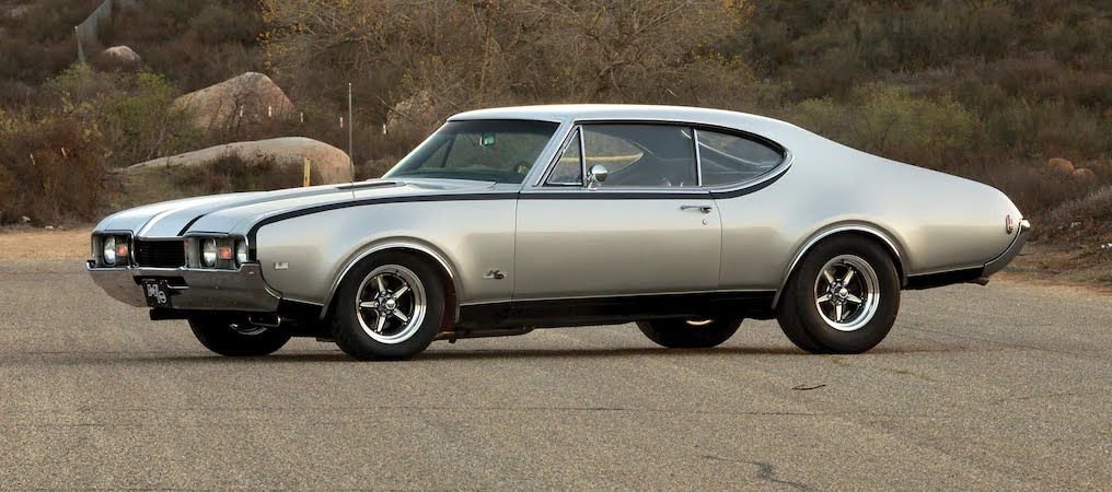

275 60 15s , stock suspension.
https://www.google.com/amp/s/www.mot...dsmobeast/amp/
Nicely detailed article.
Old Feb 23, 2022 | 08:17 AM
teamwieland's Avatar
Joined: Jun 2018
Posts: 309
Those 275/60/15s fill out the rear wheel well nicely.

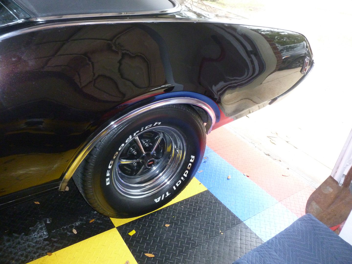

I have 255 60 15 on the front and 275 60 15 on the rear

I have 3:08 on my 68 and 3:23 on my 72
<a href="https://app.photobucket.com/u/gh5168/a/631e3170-a64f-45f6-b99d-7e4c238f9a57/p/ba2f270c-7815-43de-aaa7-268e77452683" target="_blank"><img src="https://hosting.photobucket.com/images/uu125/gh5168/P1010498.JPG?width=1920&height=1080&fit=bounds" border="0" alt="P1010498"/></a>
