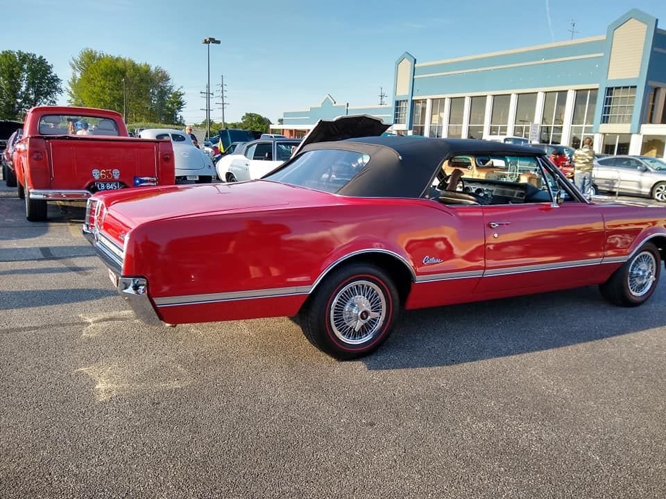

On my 66 Cutlass convertible I am running 225/70/14 Koker Redlines. I have 14x7 steel wheels. Has a nice look and still has plenty of room. I am sure others will chime in.

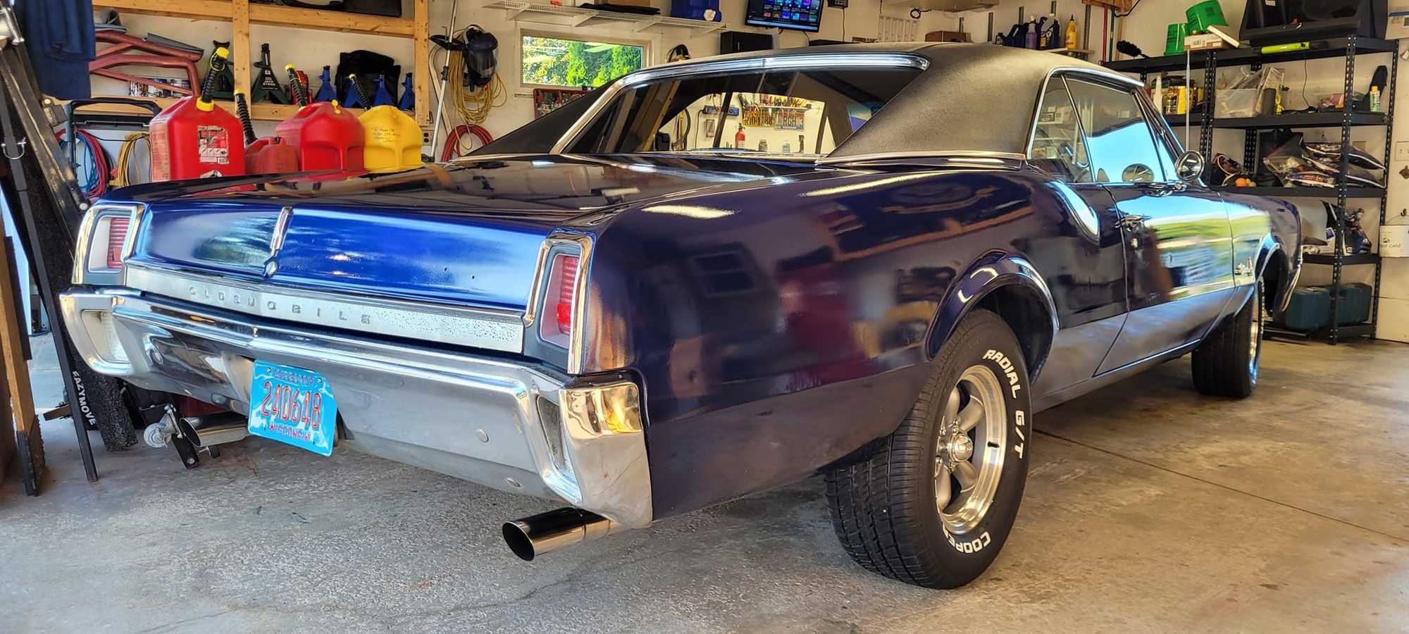

Hey RonT.
Here's my 67.
235/60-15 in the front and 275/60-15 in the rear.
