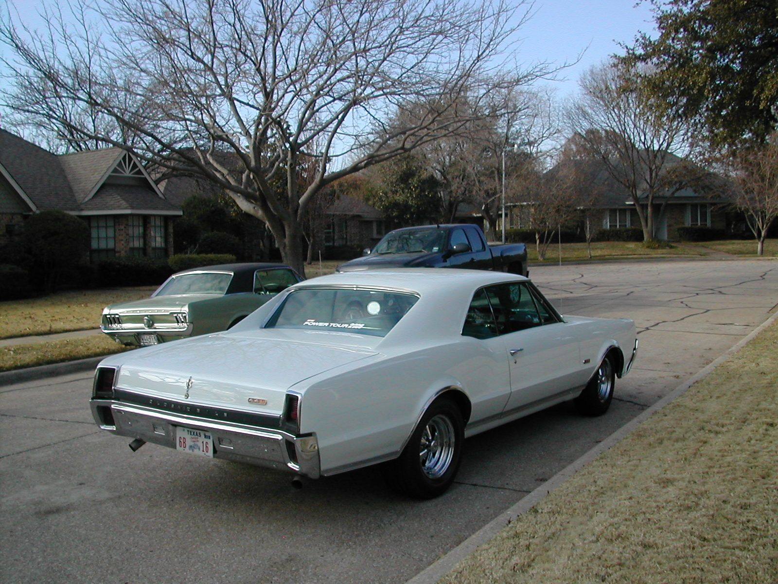

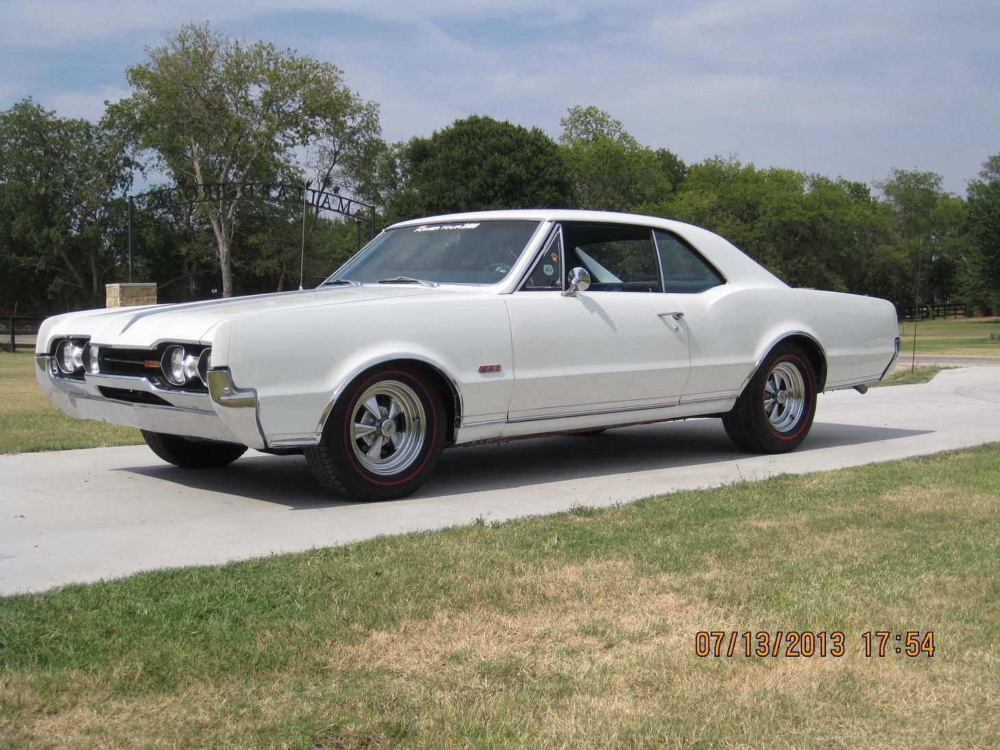

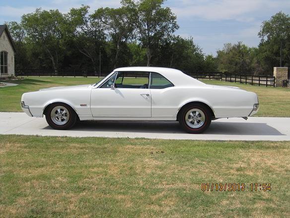

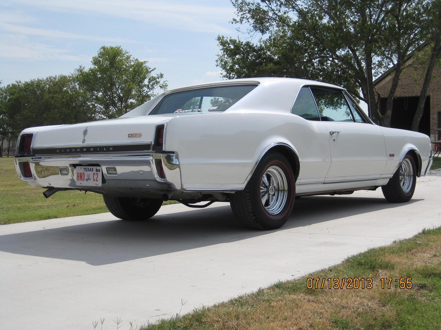

275/60/15 on the rear, 235/60/15 on the front. If I had 3-4 people in the car the fronts would scrape turning a sharp corner. The front had 1 inch drop springs..

I'm going to go out on a limb here and suggest that the reason your tires scraped is because of the offset on those Cragars, not because of the size of the tires. Those are NOT zero offset wheels.

Another contributing factor, it probably scraped because the front springs were weak and it sat too low.

I bought new 1 inch drop springs-I think that could have been a factor. Yes the offset on the Cragars was stock . Somebody on here got a hold of me years ago and saw this car in a salvage yard because the new owner totaled it. He was also parallelized. That made me sad...

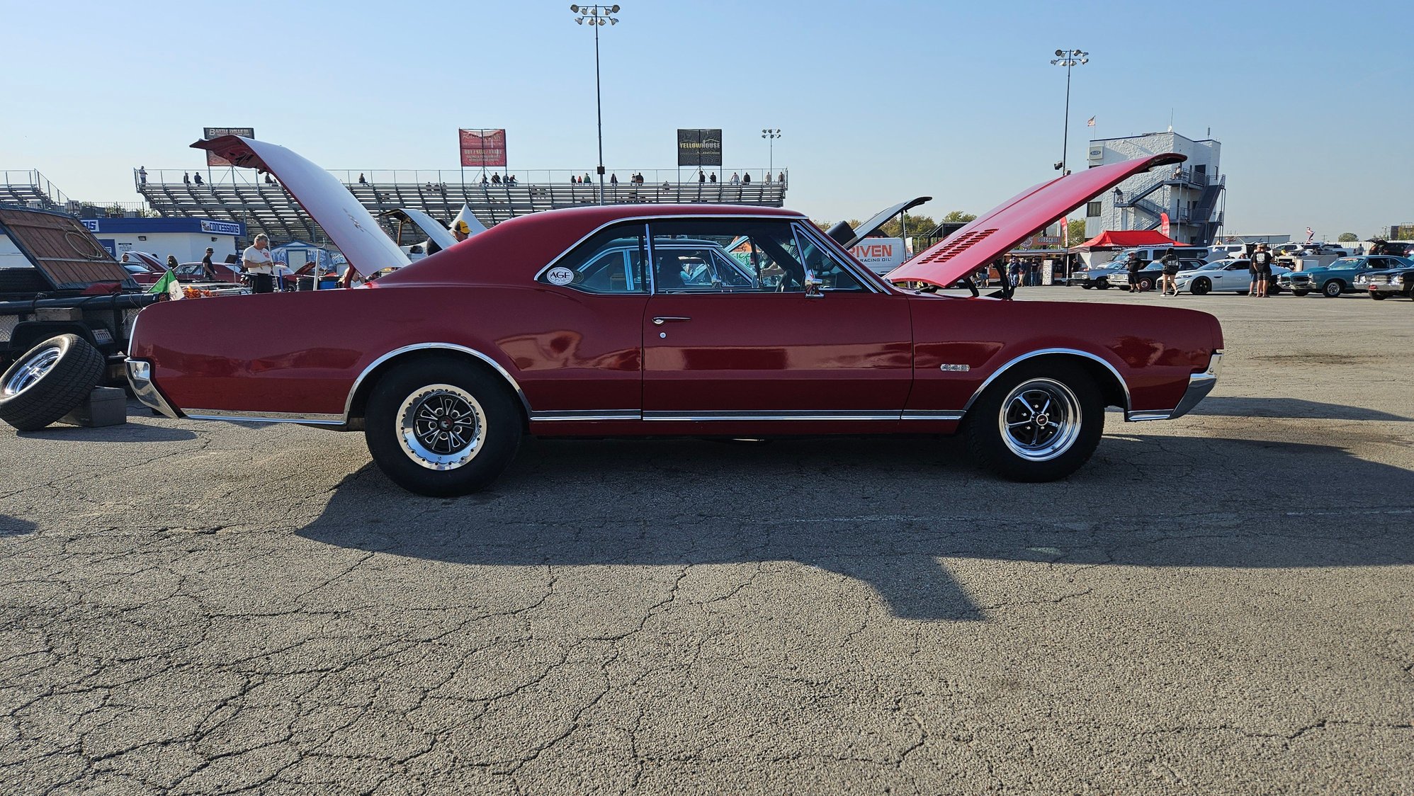

275/60-15 on 15x10 (5.5" bs) and 205/70-15 on 15x7 (4" bs)

That stance is sharp!

Looks great Bruce!

Thanks, Joe! Beadlocks make anything look good. LOL

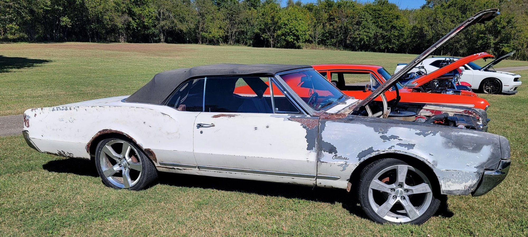

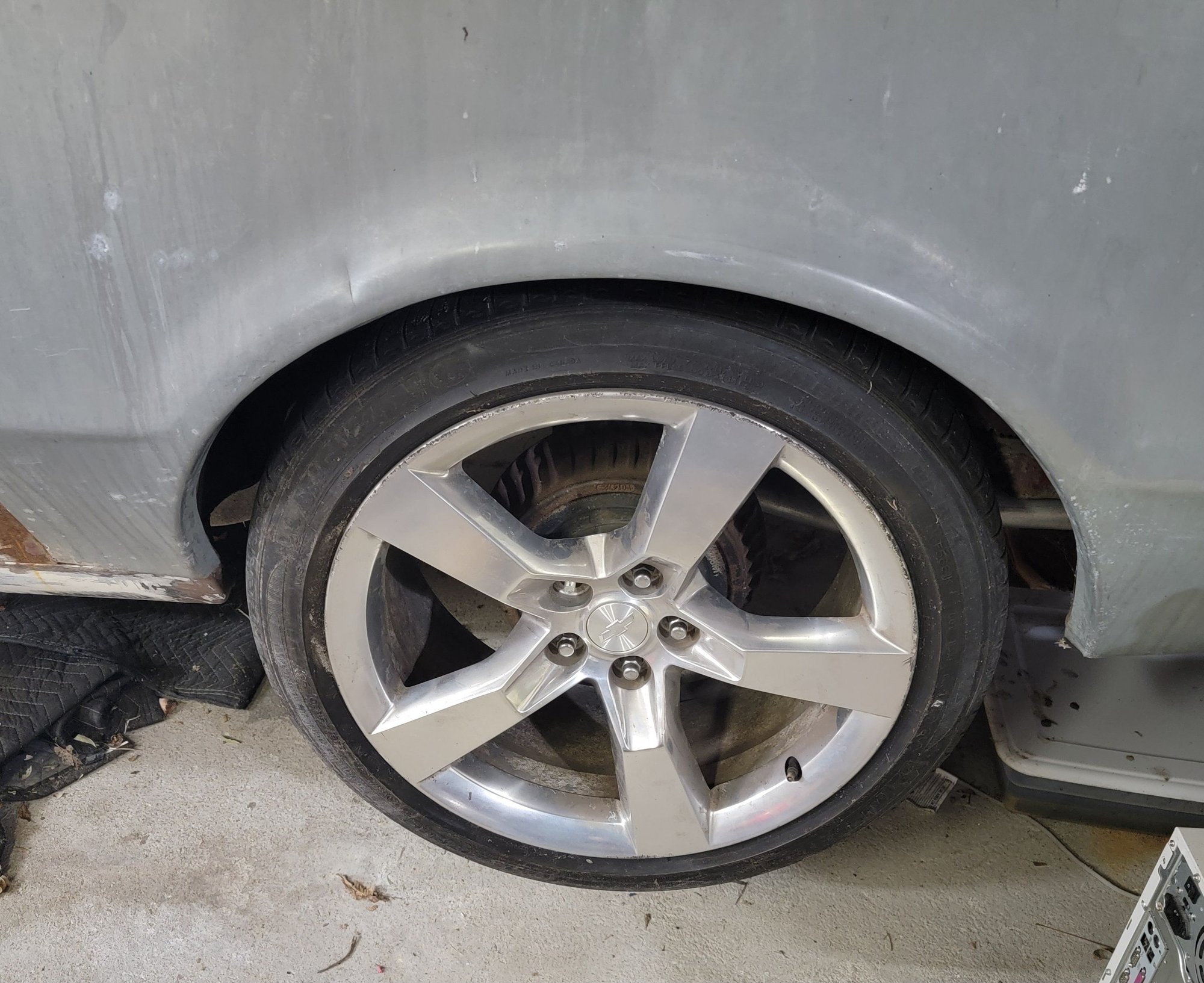

2012 Camaro rims and tires fill the wheel openings pretty well. 245/45R20 front and 275/40R20 rear. They did require 1inch spacers/adaptors to convert from 5X4.75 to 120mm bolt pattern. This also keeps the fronts from rubbing against the frame at full turn. The spacers did need minor adjusting of the hub sizes on my mini-lathe to actually fit. Mine is the ugly one in the front...

I'm not a fan of wheel spacers.

They are not any less reliable than a properly torqued wheel and the 1 inch will not put any more stress on the hubs than a wheel with a one inch offset. I'll risk it for the results.

Every one ton dually truck left the factory with 6.5" wheel spacers on the front hubs.
The issue isn't the spacer (assuming a properly-designed, hub-centric spacer). The issue is that the tire contact patch must be centered under the wheel bearings so there is no bending load imparted. I'm guessing that these wheels have significant positive offset. If so, spacers would put the tires where they belong.
