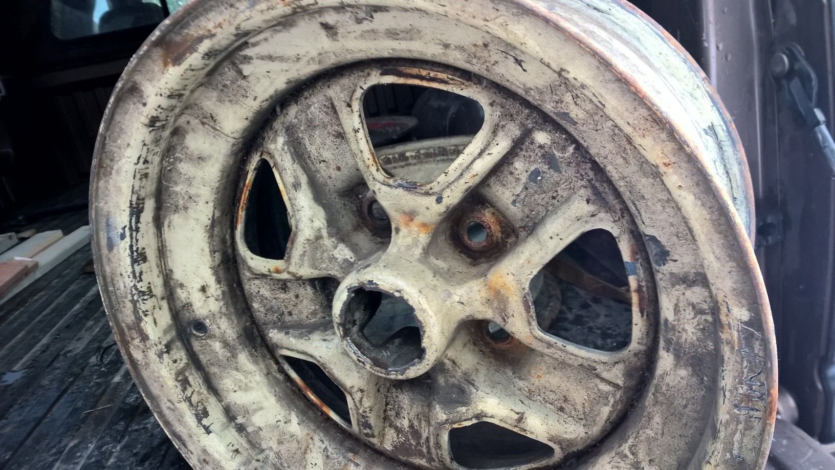

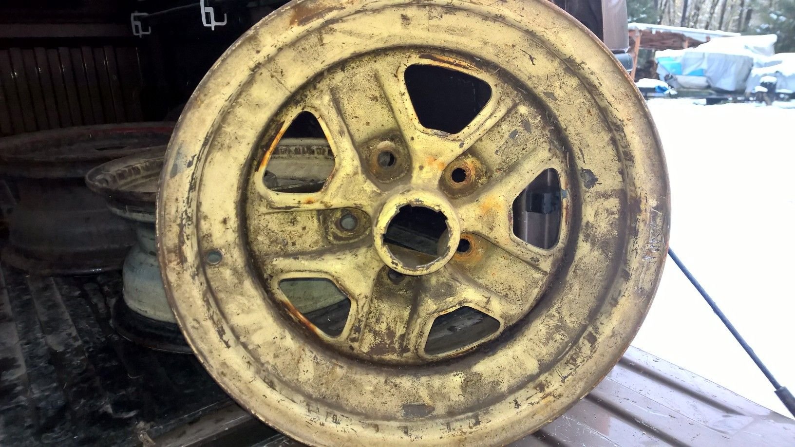

I picked up four 15x7 SSIII wheels, pics of one included.
I intend to have them blasted and powdercoated, then use them on my '69 442 vert. the car has 1" lower Hotchkiss springs in the front, and the heavy-duty springs in the rear, stock front disk brakes.
I have been reading thru the threads in the tires/wheels section, but still have a few questions:

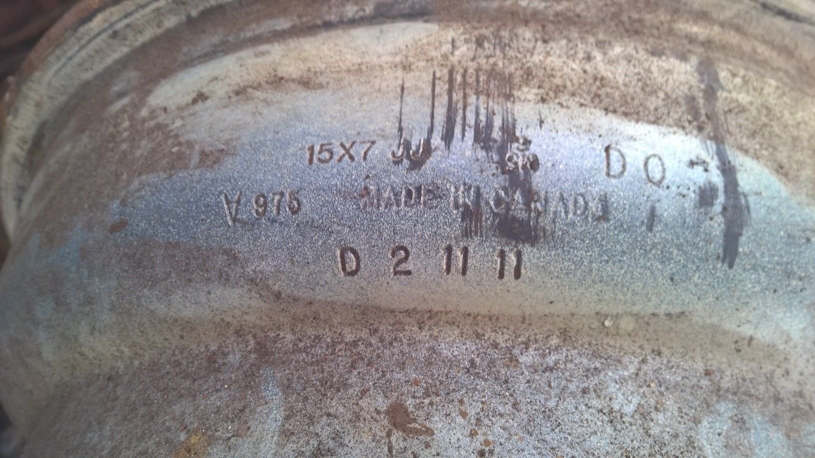

1. Can you decode the wheels (date of manufacture, or anything else relevant)?
2. The wheels came with snap-on center caps but no outer trim rings. I see that OPGI has several different sizes (width) and either a rounded or stepped edge. What size and edge is most appropriate for these wheels and my '69? My current 14" wheels have stepped edge rings that extend from the tire bead to 1/8" from the bezel rings.
3. I'm considering the T/A 245/60/15, or possibly 255/60/15. Would both clear the fender wells, front and rear?
thanks,
Rattlcan

M5/6
M = Motor Wheel Corp.
5 = plant #5 - Chatham, Ontario CANADA (1966-'91)
6 = 1976
