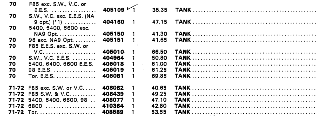

As more proof, here are the fuel tank listings from the Jan 1972 edition of the Olds parts book. 6800 series is the Custom Cruiser. Note that it's tank is unique. Also note that for 1970, the wagon and Vista tanks are different if you have the evaporative control system (EES) or not.

Thanks for the reply. Kinda hoping you would. I was skeptical about A and B bodies sharing the same tank.
