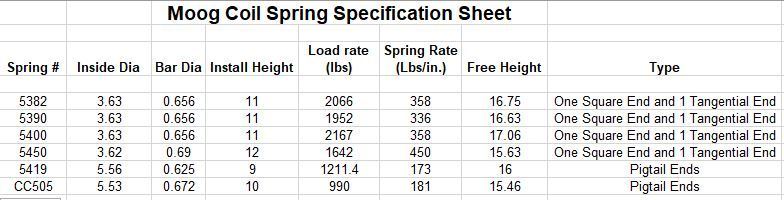

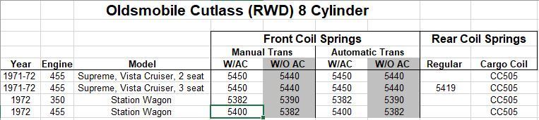

Here's the coil spring info I have archived from the online Moog catalog.
