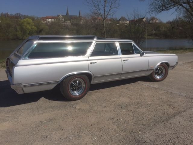

Vista Cruiser, in the background our 500 yo castle Johannisburg
Thanks for the compliments, i finally got it converted to German specs and on the road with a nice registration plate :-): MIL-VC65H >>> Miltenberg, Vista Cruiser 65 Historic Vehicule
I hav 15x7 with 225/70R15 up front and 15x8 with 275/60R15 Goodyear redlines. I had to install Delco Air shocks to lift up teh rear a little, because with 5 people and baggage on board it was scratching the tires.
Love that Station, it catches moe attention than all the porsches and Ferraris over here. Could have sold it for double the price i paid.... but I will keep it..

Glad to hear you are on the road. Yes, I have fun with my Vistas and they are interesting wagons for sure. Young people that have never seen one really like the style. It is great you are showing American design over the ocean. What was needed to make it meet German specs? Best Regards, Trent in Los Angeles

Hi Trent,
i had to change the Sealed Beams to H4 Design Euro-spec lights. I am using Osram Night Breaker Bulbs, and it is a big difference to the old sealed beams. You can really see at night
Then i had to built in a emergency flasher, that flashes over the brake light.
In Europe, the flahers cant stop when you apply the brakes.
The yellow park signals up front needed to be white.
I had to hammer the VIN on to the right front frame.
The tires had to bear a Euro-stamping.
That was about it...

Bitchi'n ride, I really dig the red lines and silver paint with pinstripes.
Yeah, it's a 442 wagon. They only made a few.

Thanks for all the compliments.
Yeah, the old cruiser is a real head turner. Gets more attention than all the Camaros and Mustangs together.
Somebody had a good sense of design, when he added the red pinstripes and redwall tires to the silver cruiser. Cant thank that guy/woman, because i dont know who picked the scheme.
I´ll take it around Europe, because it even has enough space to sleep two. We have an air matress that fits it perfectly.
I hope to keep it running for the next 30 years.

how did you euro spec it.i thought you had to have orange turn sigs on the rear!sharp car i had a 65 442 that color.

you dont have to convert you car/truck to amber/orange turn signals on the rear if the car is pre -70
@Obop: I pulled a rim and measured the backspace for you: Yes, they have 4.5
