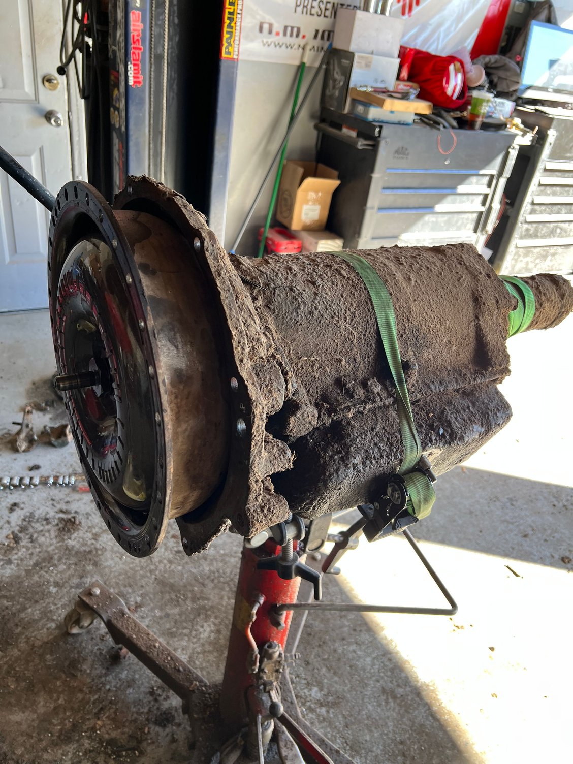

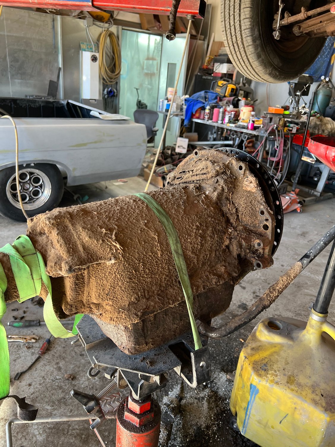

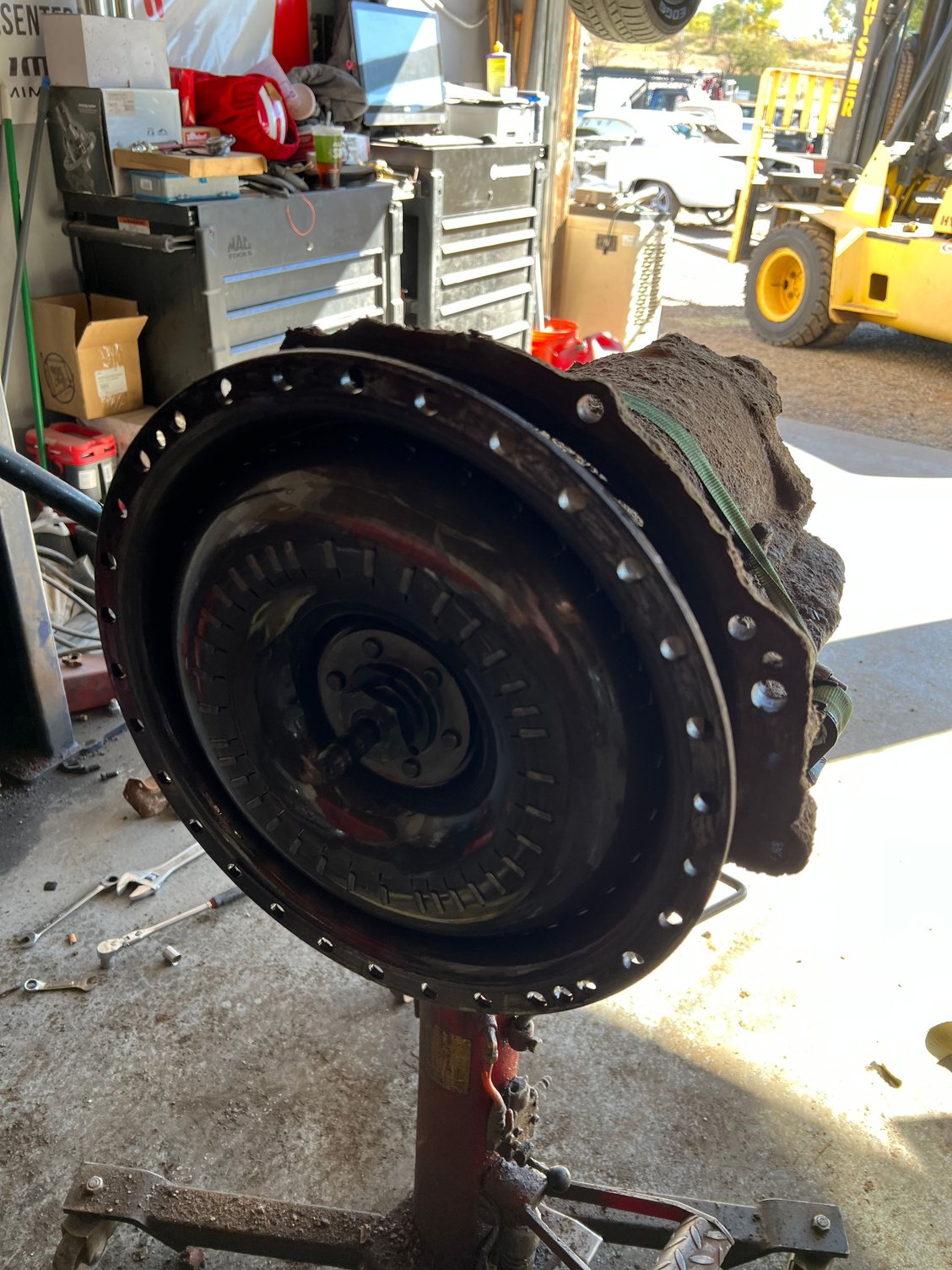

Well guys I did all I could do today with the tranny swap. Everything was correct as far as the swap but it was a bit harder than I thought and had do remove more than I thought but what made it harder was all the rock hard sludge covering the bolts and nuts I needed to remove. And found out there was 32 bolts holding the converter to the fly wheel. I would have put the other trans in but I discovered that I need a gasket that goes between the fly wheel and the converter so I just ordered that today from fusik so I should be able to pick this up next sat as long as the gasket comes in time. Is there any way the throttle valve could have fallen off the linkage inside the trans that would have kept it from shifting?
